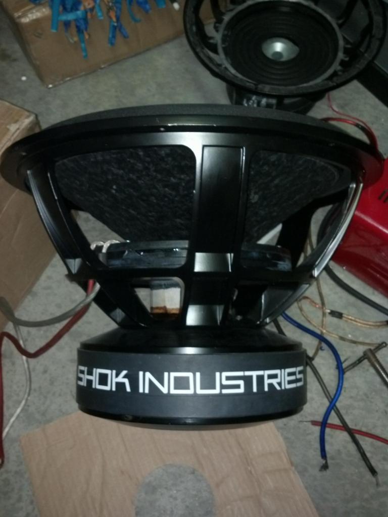

So we finally got all the parts needed to build the subs here is #1 of 4 custom 18's being built.
