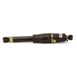

Have a look at the rear shocks. Air shocks have a bladder, regular ones don’t. Unless you bought the truck new you have no way of knowing if they haven’t been converted. Here’s an Arnott air shock that fits an 07.
