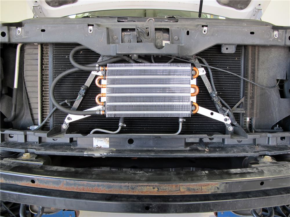

I've been having this same issue with my 2013 Denali. Replaced the radiator with an all aluminum when the stock radiator plastic ends cracked. Still kept getting warm. Replaced water pump with new OEM pump. Replaced thermostat with OEM. Replaced any sketchy hoses. 7/9 blade e-fans. I have no leaks, and expansion tank is full. Using Torque Pro app, at idle with AC off, temp will creep up to 225 and then the fan will kick up to high. Temp will drop down to 215 and the fan will kick down to low. Temp will then creep back up to 225....fan goes back to high....temp goes down to 215.....rinse and repeat. With AC on, fan kicks to high almost right away and stays on. Temp depends on if I'm in stop and go (gets warm) or highway (stays 200-210). I also have a Trucool 40k trans cooler mounted in front of the AC condensor/radiator.
I'm wondering if the trans cooler (trans will go up to 170ish when the engine coolant is up at 220+ but generally stays in the 150-160 range) is blocking air flow through the AC condensor/radiator enough to cause it to run warm?
What temp SHOULD the fans kick to High at? I'm Blackbear tuned and Justin says it's programmed to kick to HIGH fan "10-15 degrees cooler than stock", but I'm not buying that. If that were true, then @ stock, the fan wouldn't go to high until 235 and that's way too high.

The fans are operated by three relays to either have them run at low speed or high speed.
I am also in Florida and my temps are about the same with the stock transmission coolers. Have you cleaned the fins on the condenser or changed grills or... Wait a sec, what are the condition of the baffles, those tar paper like pieces that go on either side of the radiator and one underneath? When these deteriorate and fall away, a lot of air then makes its way around and not through the radiator.
Here's a pic from the internet:
The one to our right is intact and in place. The one on the left has fallen out of place some. Mine were falling apart so I replaced them when we did the bumper cover.

Both of my baffles are flimsy/torn and not doing anything. I think they both are flimsy enough to have fallen down.
But could that be enough to cause it to run too warm? The "fins" on the radiator (new) and trans cooler (new) are clean. The AC condenser looks good too.

If they are not doing what they are supposed to do, yes, the motor will run warmer as too much air is getting around the radiator and not through it to cool.

I'm not convinced they would help for my specific issue. I don't have any cooling issues at highway speeds, which tells me that there is plenty of airflow through the radiator. When at slow speeds and relying on the fans, the fans PULL air through the radiator from inside the fan shroud.....so those baffles aren't doing anything to help with that. The baffles are to direct air through the radiator at speeds where the fans are turned off. They don't do anything at speeds that use the fans for airflow. I don't have any cooling issues then....only at slow speeds and while stopped (idle).
