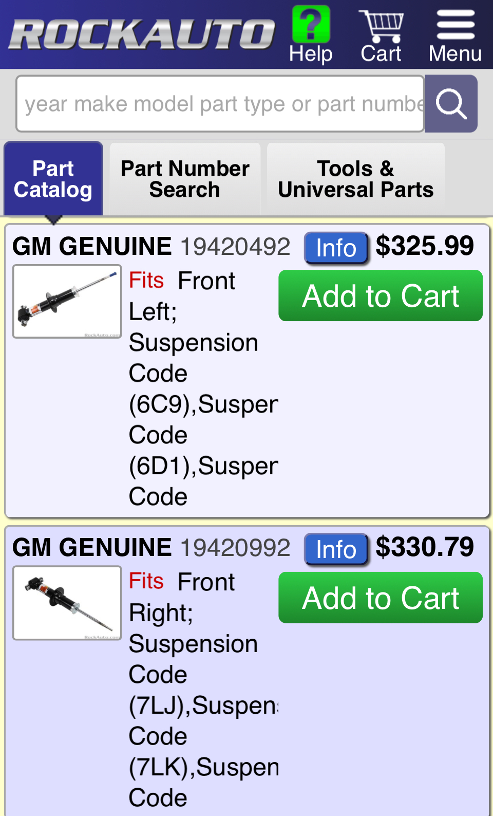

Below are the parts and prices of front strut rebuild from rock auto. Ignore the TPMS module & z95 struts since you’re z55. The link below shows how to swap from steel to aluminum front suspension like the 15-20 trucks use.
I’m doing the aluminum swap since my 09 Esky AWD (Denali clone) has 185k miles on original suspension. It’s cheaper to buy new Suspension parts in Alum or Steel vs instal new bushings in the same susp parts.

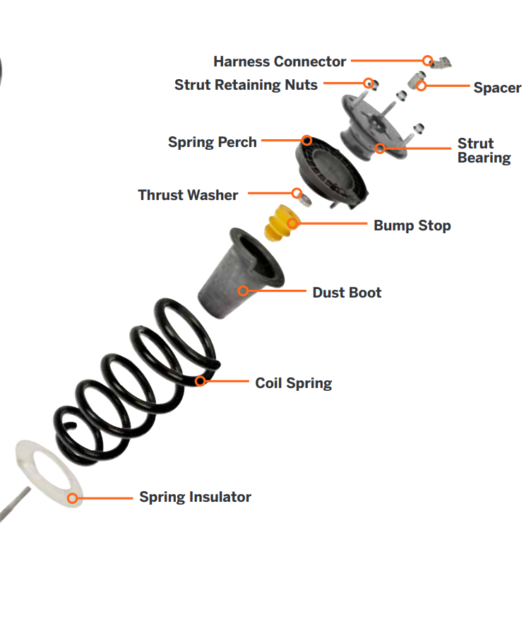

So … for loaded (complete with spring) there’s Dorman. They also recommend mixing the two up.
Dorman …

To do it over again I’d buy all the parts I listed on the excel spreadsheet in previous post and the lifetime guaranteed OEM a/c Delco z55 L/R struts inserts above, all from rock auto.
Take boxes to your favorite mechanic and have One & Done for 15 years and / guaranteed for life through R/A.
Dorman …
