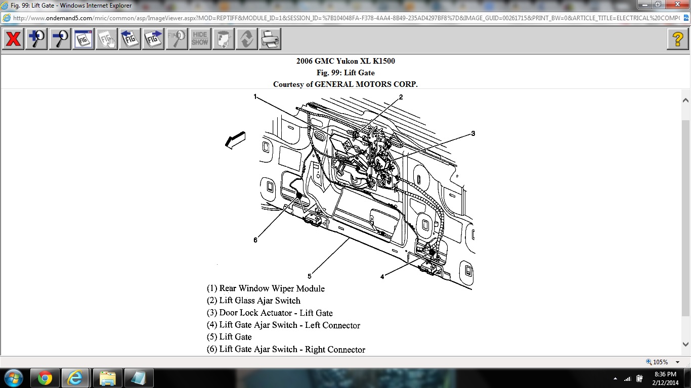

Where are the sensors in rear hatch and glass. I looked before I left and found neither.

The switch is behind the interior panels of the hatch.
