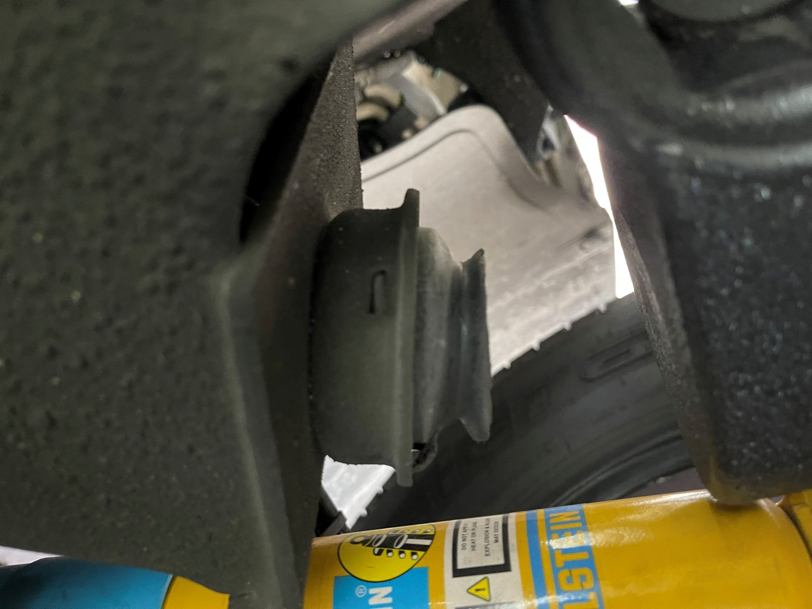

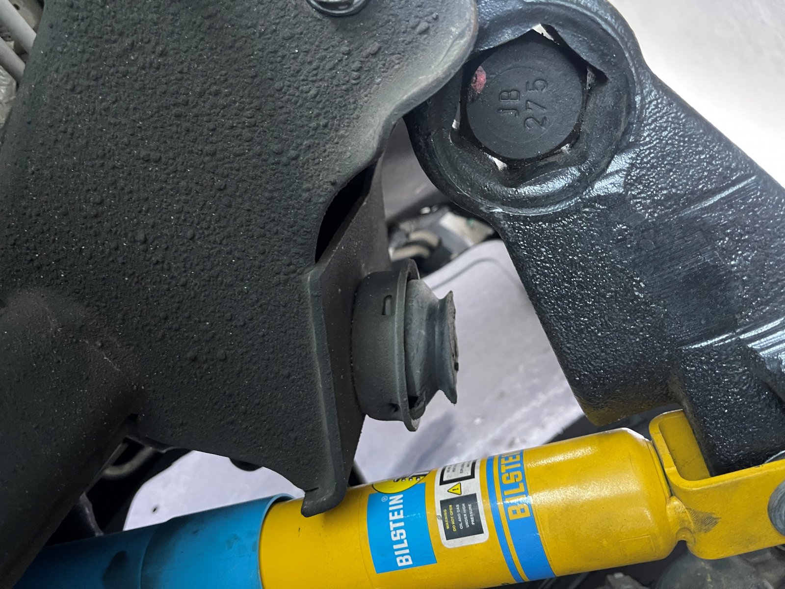

So I went ahead and looked under the car as well for the jounce/bump stops as well and they seem to be trimmed or I may be mistaken. My car is lowered so maybe that's why they trimmed them if they are trimmed. These are the fronts sorry i didnt rotate the pic. Better pics below.

They do look trimmed. You have yourself a rat's nest here. Unsure of all that was done. May have to start at ground zero but you could likely correct most of the problems with what @Byoung1330 said about helper bags you can adjust as needed.
I can't tell if that pic is from the front or the rear. If it's the rear, no problem. If it's the front, the jounce stop should be contacting the lower control arm when the truck is at ride height.

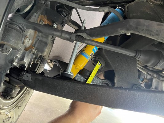

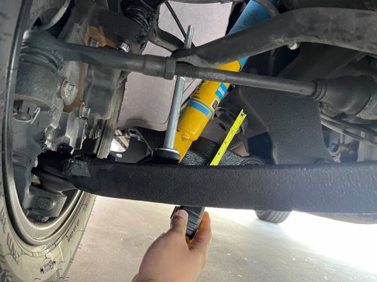

Sorry i should have stated its the front. I've raised the ride height as far as i can. I have a spindle lowering kit. Car does ride better in the front after raising it up. I did this thinking im gonnna re install my bilstien 4600's in the rear with the correct springs stated at the top of this post. The rear will go back to stock height hoping lifting the front will not sit too low after doing the rear swap to bilstien shocks and the correct springs the stiffer ones also from bilstien to keep it from wobbling. I think and hope once i replace the front jounce stops maybe i think stock ones with the stock height here is a pic i measured and doing the rear bilstien 4600's with the correct spring will finally give it a decent ride. I did one measurement at the top of the cup and the other at the bottom edge of that cup were the jounce stop sits.
Not picking, just an observation, but those front sway bar links appear to be way over-tightened.
