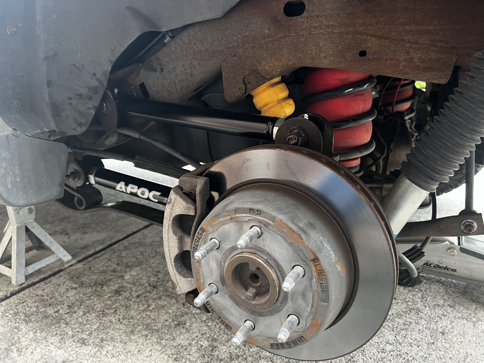

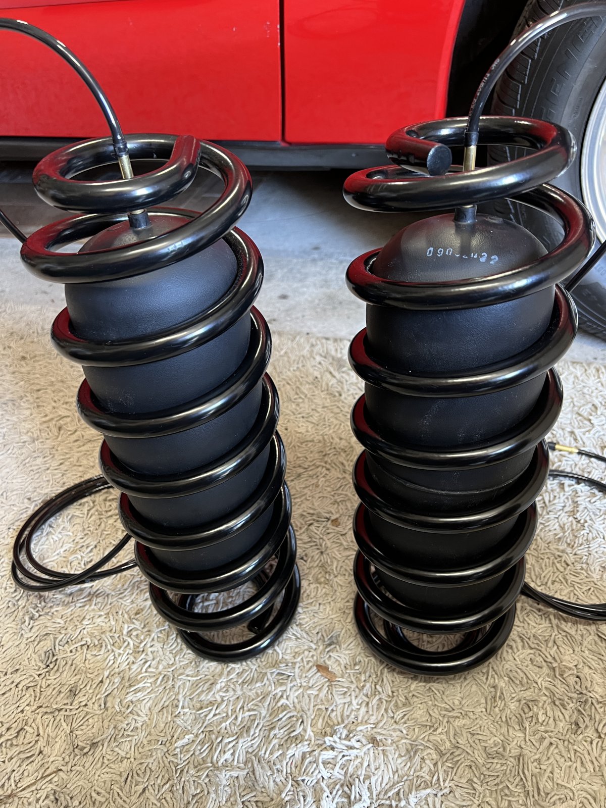

For comparison:
2003 Z71 stock height in the rear, and leveled in the front using stock torsion bar keys; running BFG 285/75R17.
Replacement Moog 81069 springs with air bladders for a Ram 1500 inserted ready to be installed.
Rear height is 39” from ground to lower fender lip unloaded.
Front is 37” from ground to lower fender lip.
The Atomic Fab coil-overs is on the wishlist .

For comparison:
Do you have any pics of that air bag set up. I want to do one so i can level out when towing.

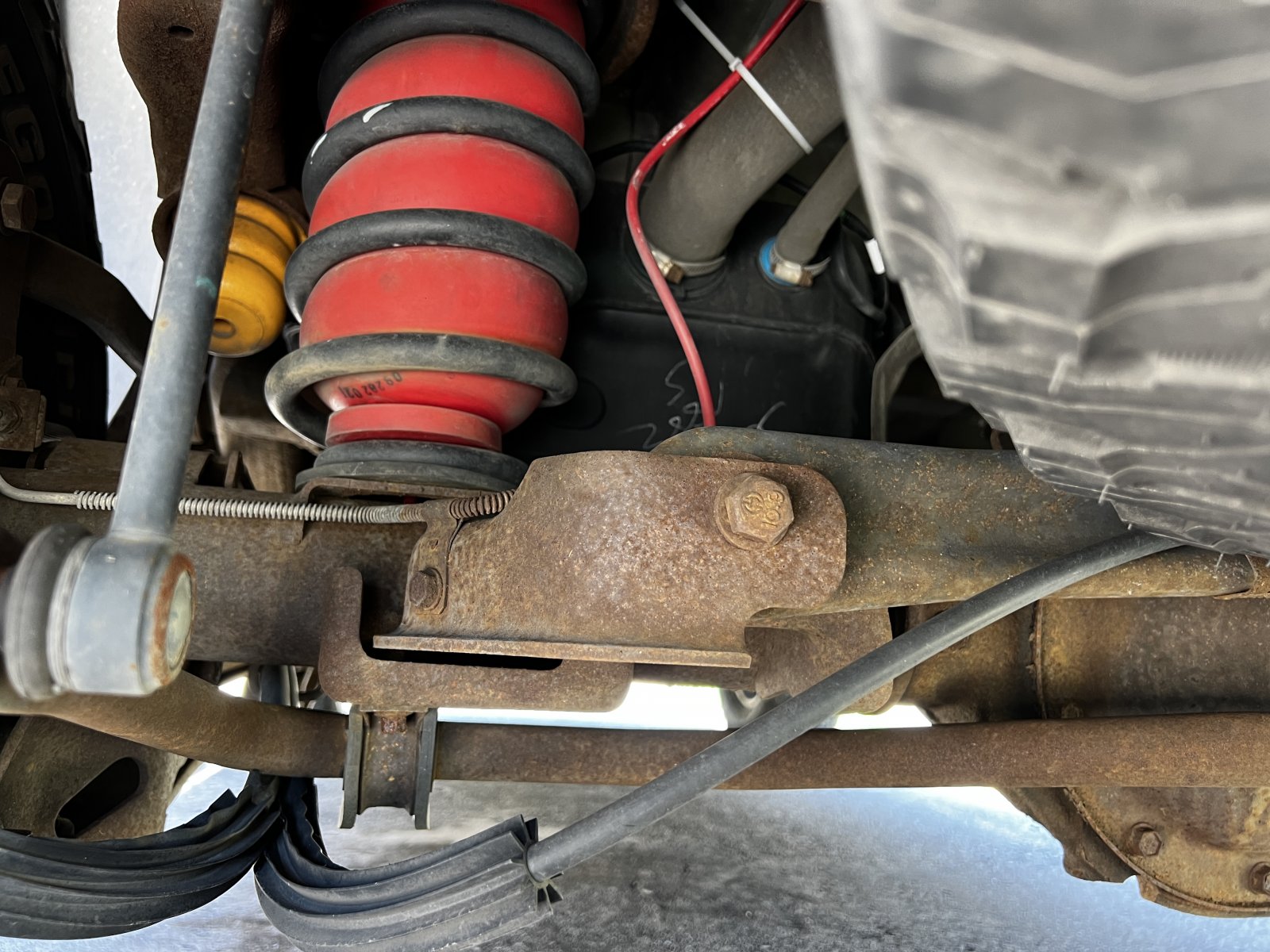

They are Air Lift air bags. The bladders go inside the coil springs and you run each line to a Schrader valve. I put my Schrader by the hitch. They work great for the price.
Set up on 2003 Z71.
Schrader valves installed on receiver hitch plate..
New Z71 springs with Ram Truck air bladders ready to install to replace existing (above).
