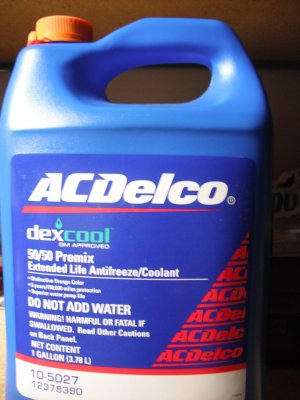

Your Truck came with Dexcool when new. Dexcool has been used since 1995. My'95 Tahoe had info in with the owners manual that a new coolant was now being used in your new GM vehicle called Dexcool. It is the only coolant approved for your vehicle by GM.DSCF3691.JPG
JonnyTahoe
Apr 14, 2011
1,249
779
Minneapolis
I suspect the vast majority of issues with Dexcool is that people mixed it with the "universal" green stuff.
Still have Dex in my '94. Sure it has a new rad and waterpump now... but its like 30 years old. Works great.
You can still walk into a GM parts department and purchase genuine dexcool like I did last year. It is still used today just like it was in 1995.
