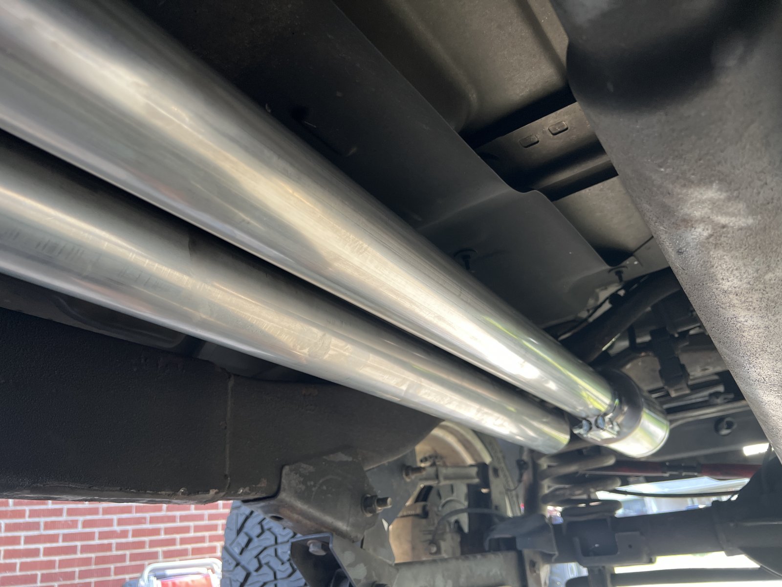

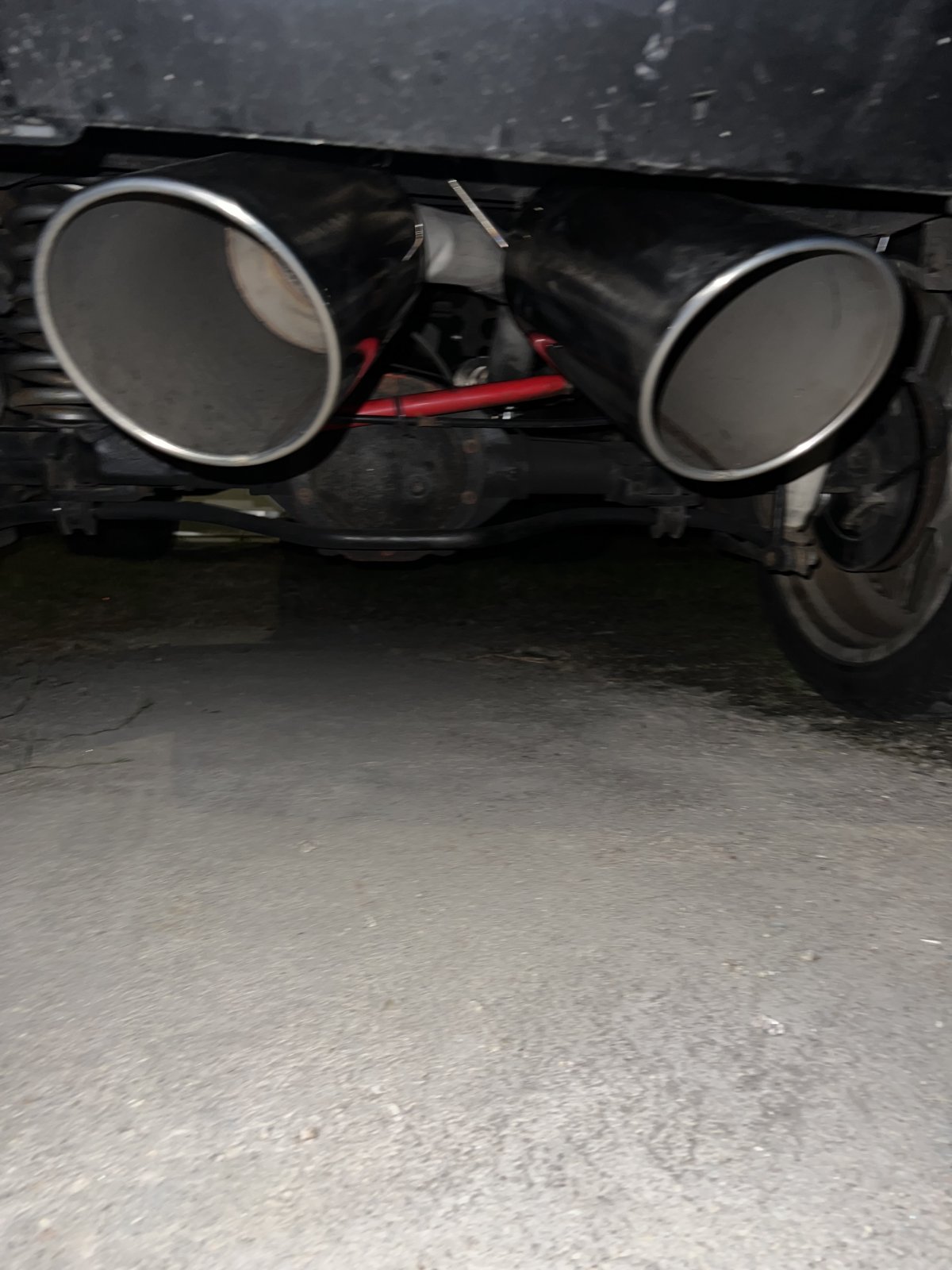

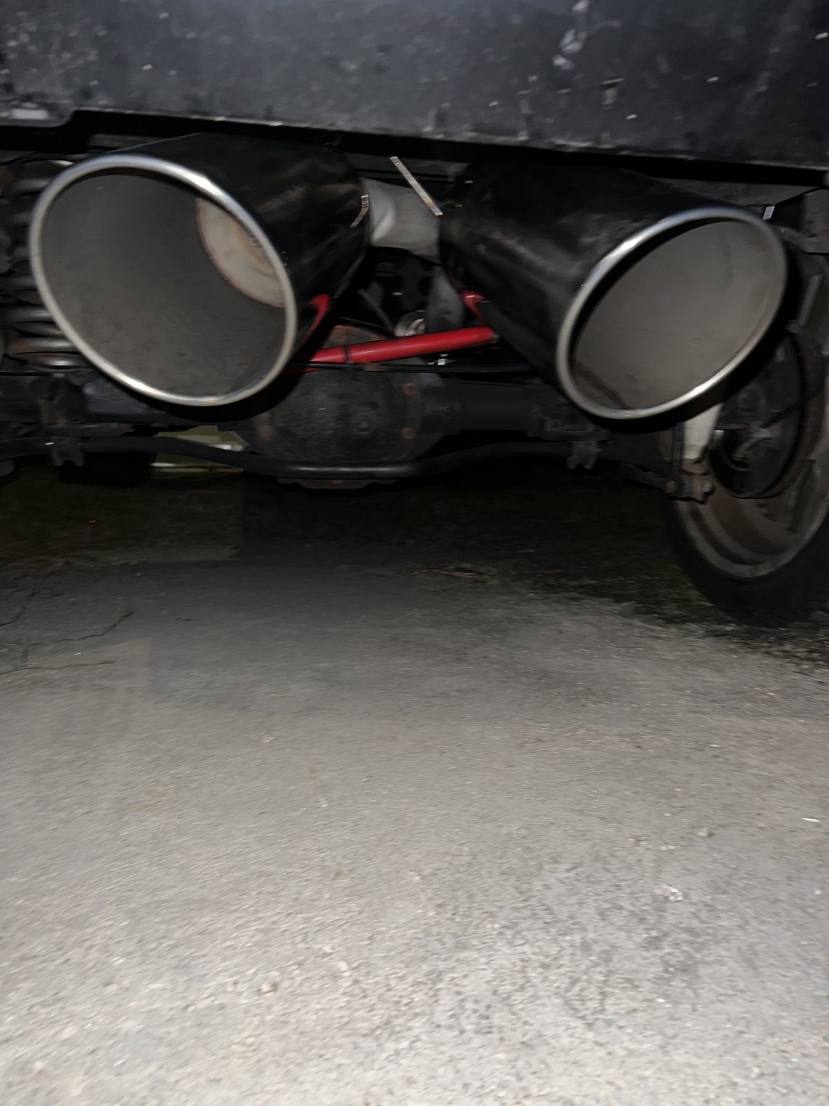

Also for true duels it would run down the passenger side then run over the axle to wherever you want your tips to be
Side note don’t be surprised if you get a broken header bolt or two trying to get the stock bolts out. A left hand bit or easy out usually will get them out but be careful not to over drill
If you get speed engineering headers don’t use the paper gasket they send only use Gm ac delco etc multi layer steel header gaskets only!
Also it is well worth it to spend the extra 30$ or so on ARP header STUDS over the BOLTS as it’ll make install a lot easier especially if your doing it by yourself it can be a biotch to get all the bolts lined up. I’m still kicking myself in the ass for not getting them this past go round knowing how much easier it would’ve made the job.
With the speed engineering kit you can install everything yourself in the driveway if you are up to it as it’s not too hard the headers are the most aggravating and getting the stock pipe out. I cut sections out of mine instead of fighting the rusted bolts but I never had intentions on reusing the stock exhaust anyways.

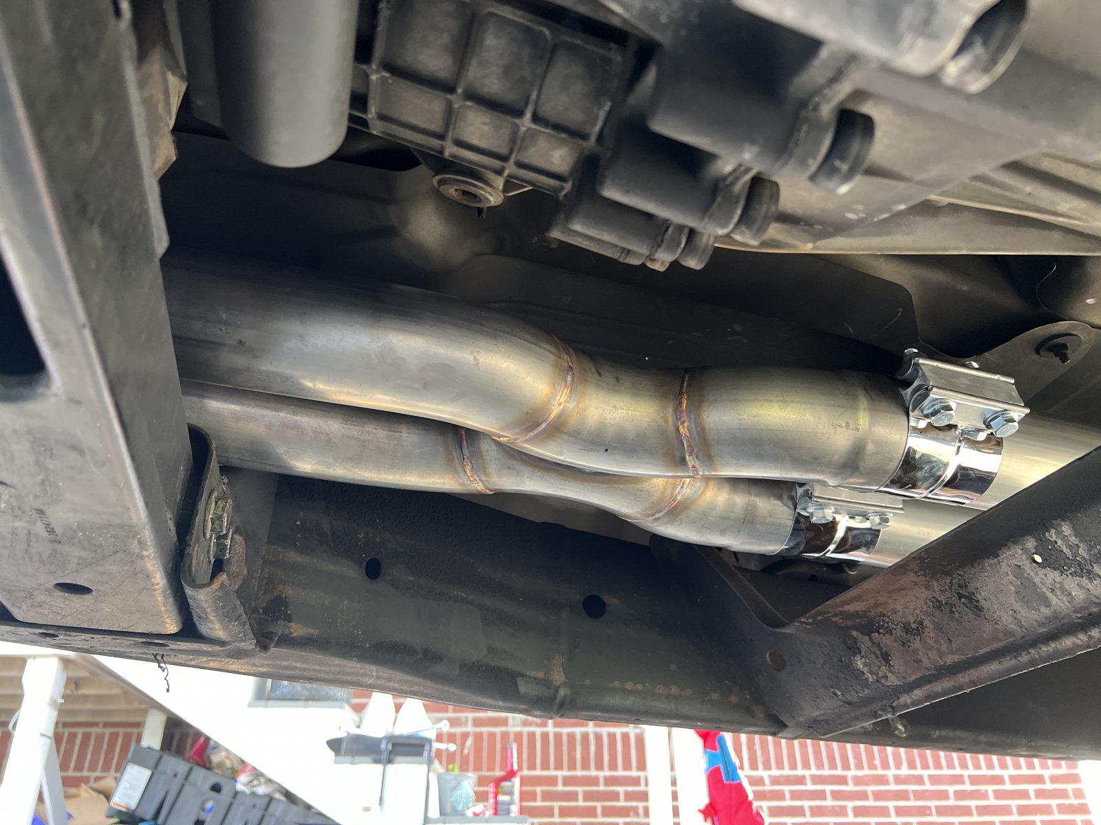

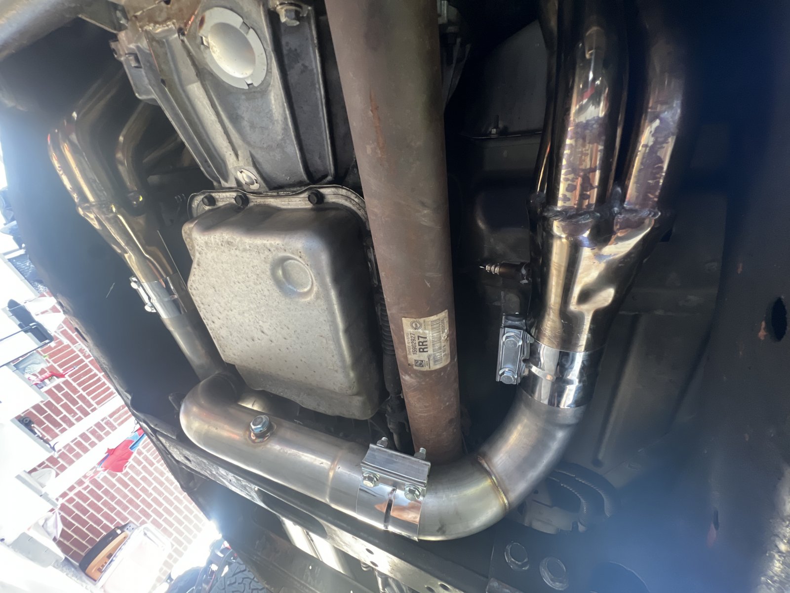

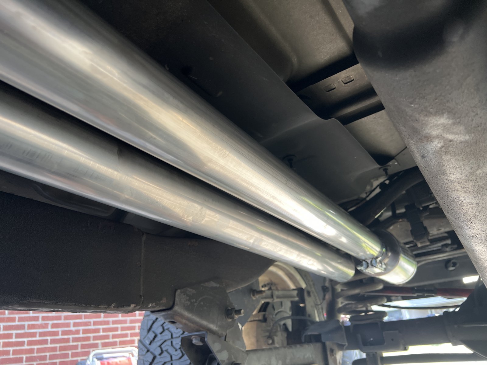

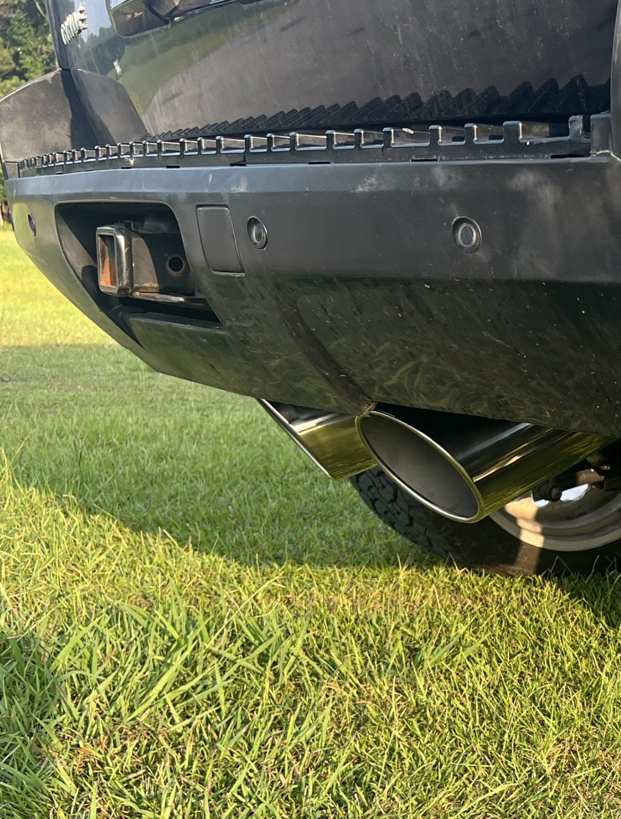

View attachment 407607View attachment 407608View attachment 407609View attachment 407610View attachment 407611

Yea man it can most definitely be done. I like the speed engineering kit get the nicer clamps and if you do have leaks just have the connections welded down the road mine had held up good though.
Also I diddnt note I have the 1 7/8” Longtubes with 3” pipe all the way back
I think I was around 1,000$ with the speed engineering headers and y pipe some stainless pipe and then mufflers
Another 150$ for the muffler shop to run the tail pipes/axle dumps for me
Came out awesome and even with no cats it’s not horribly loud cruising but when you get on it she really opens up over 3,000rpm
I went with the corsa pro resonators
I wanted the corsa pro mufflers but wallet wouldn’t allow it at the time but im still happy.
The X pipe is almost essential imo as it helps with the back pressure loss from no cats AND it takes away almost all of the frapping popping cracking shit you normally get with loud exhaust and cleans it up a lot!
