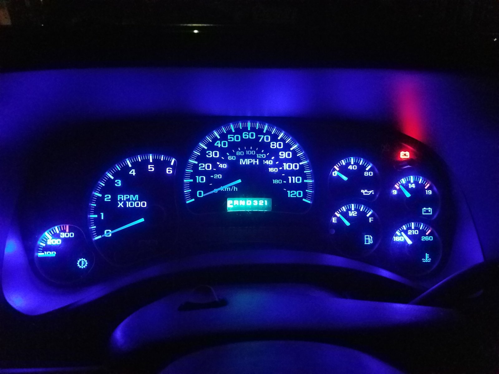

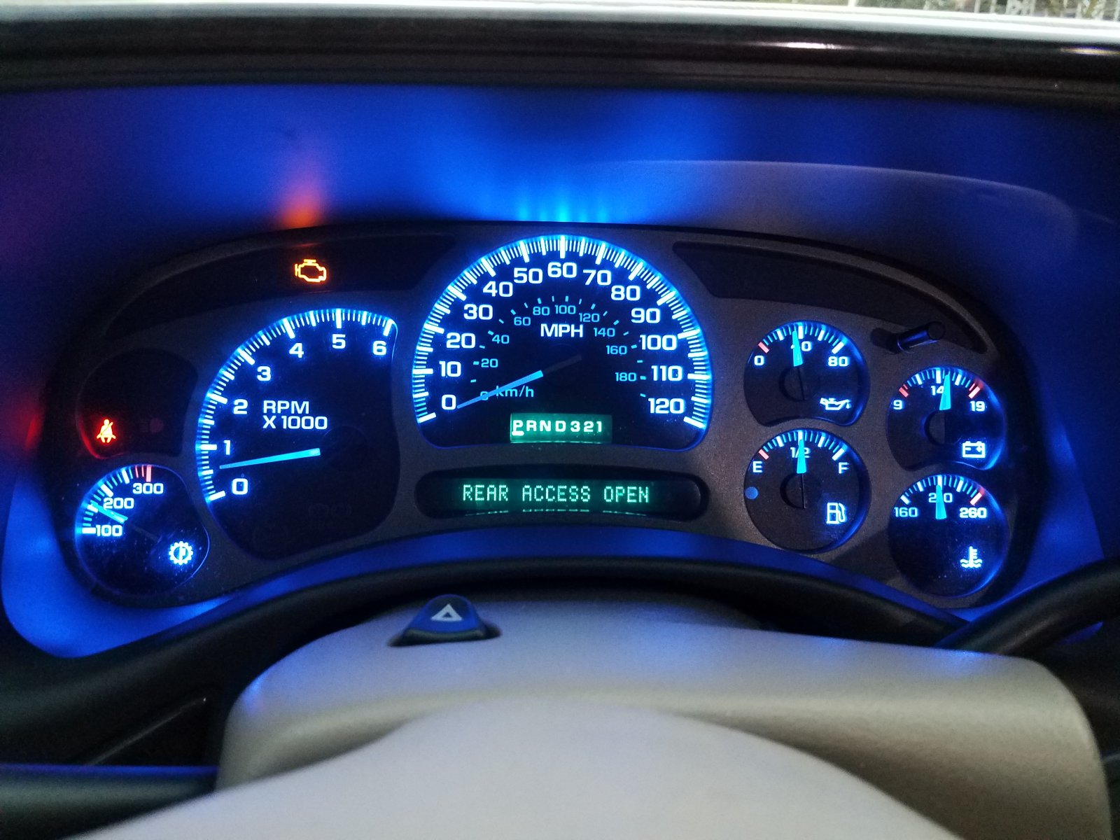

For an 05 I used LED strips.
If you use individual LEDs you'll get hotspots. I placed the led strips around the bezel and I hsv uniform lighting all around.
The one with the CEL is the LED strip . You can see the difference
It's actually easier to use the led strips too. Instead of soldering each individual bulb you just need to solder the wires for the strips. I did the strips over 2 years ago and 0 issues so far (did them April 11, 2018 according to the time stamp on the photo)
View attachment 245680 View attachment 245682
