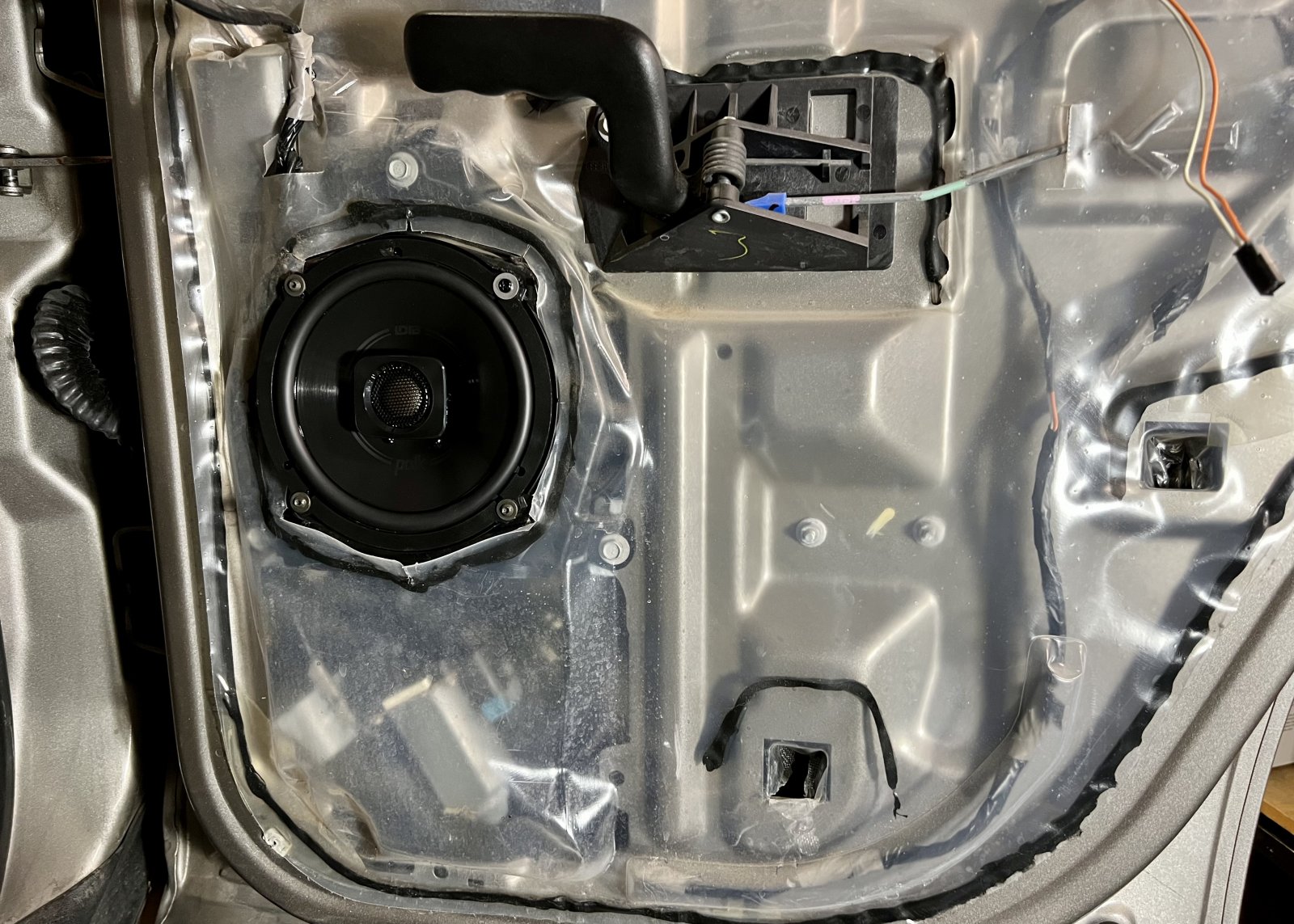

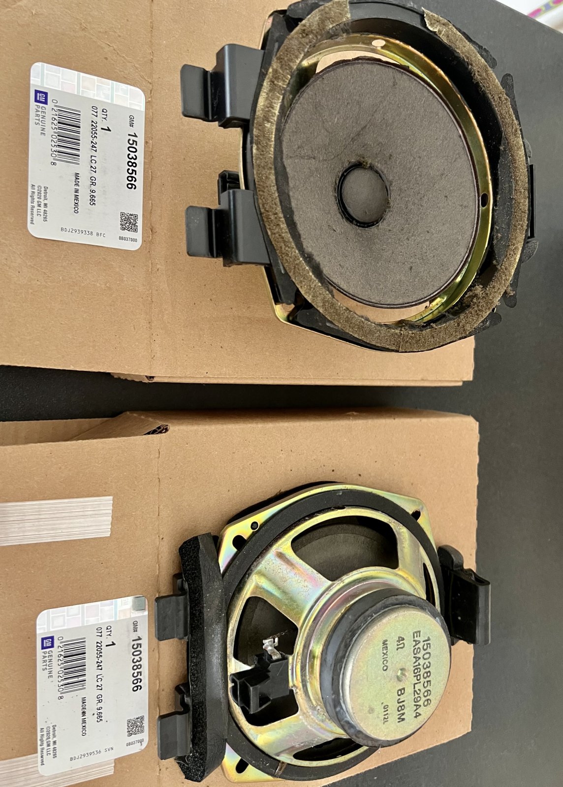

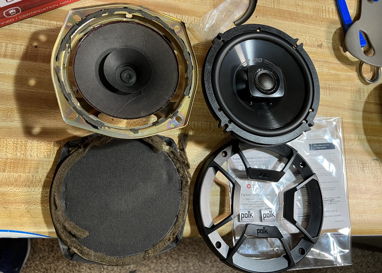

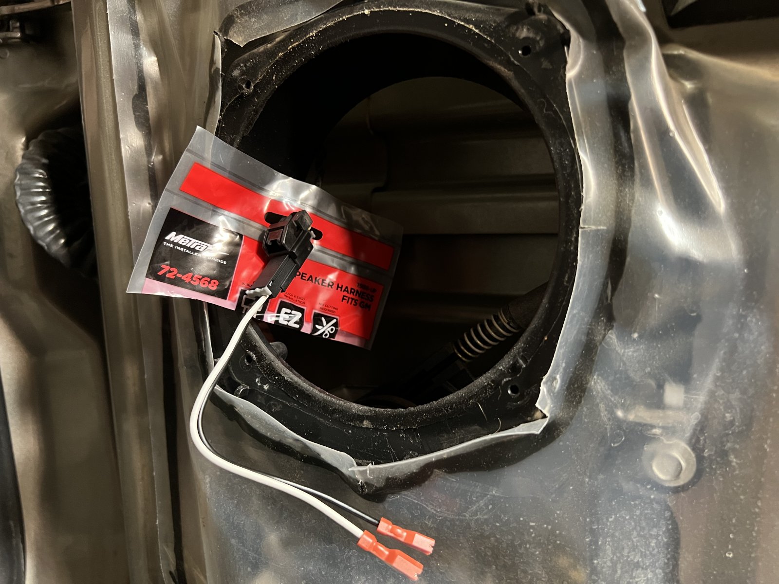

6.5” Polk fit in the rear door of my 2001 Yukon, NOT Bose. It was a perfect fit. No drilling. Even used the OEM screws again, except one that I replaced with slightly longer screw and a flat washer.
Not Bose but I think yours is the same.
Front door, I replaced my 21-year old woofers w original equipment replacements recently so I can’t answer except to say it looks like 6.5 to me. The foam surround on original front door woofers was disentegrated. I will eventually go back in and replace the replacements with Polk 6.5” component kit but I have not done that yet. I plan to use the aftermarket clip in bracket, then screw the woofers into the bracket. I should have tried to salvage the 3point clip-in Mount from the original front speakers before trashing them.
Hope this helps. Please post back and let us know what worked on your Bose.

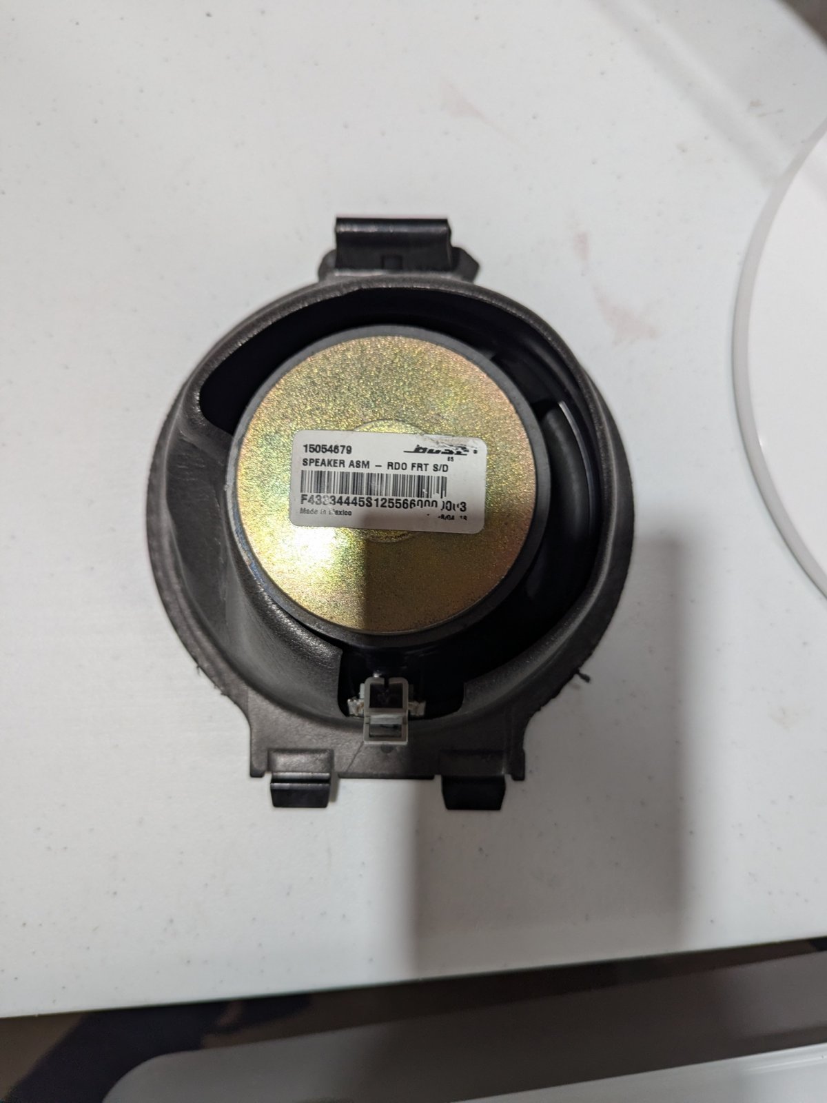

My front speaker is 6.5 for my 2005 Tahoe Z71 with Bose. See the picture below. I am looking for a recommended replacement for this if you or anyone knows. I dont mind drilling holes as long as it is electrically compatible (2 OHM).
