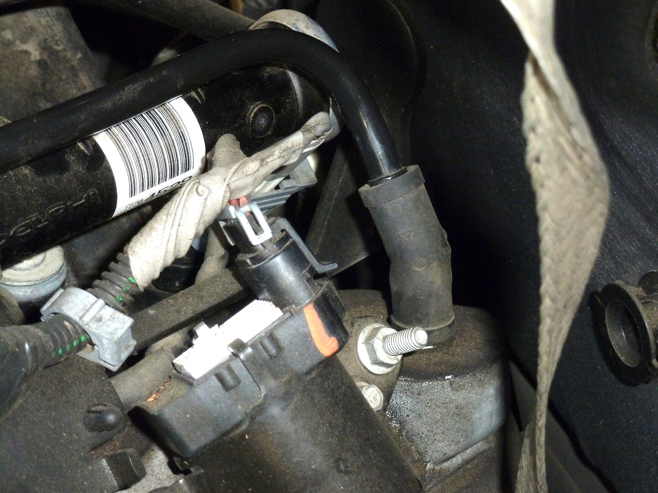

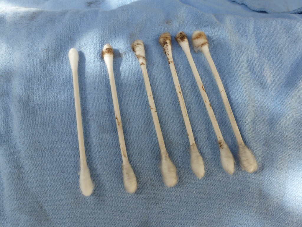

I went ahead and checked out the PCV valve tube to the intake and found very little oil in the tube or at either end. Here are two pics.
From what I have read most rigs with 120,000 miles had serious sludge in their tubes, so this makes me think we got issues other than the PCV valve. Anyone have some thoughts?
ivin74
05 NBS Nali
Aug 3, 2014
2,420
2,557
Htown, Texas
even better remove the whole intake manifold and you will find the missing oil in the intake ports
