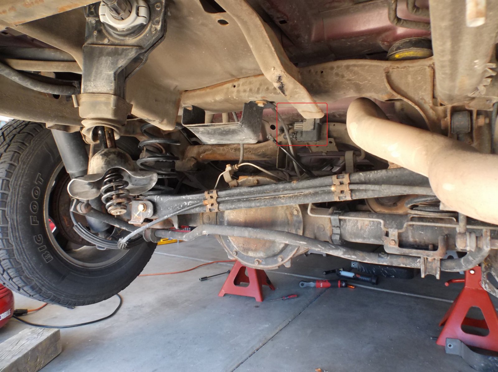

Are you sure that it was the purge valve that was changed? It's on the engine. On the other end the vent valve vents the charcoal canister at times, and if it's stuck closed the tank can't vent as fuel is added. When the truck is turned off, the vent valve should be open; it's near the back of the fuel tank. Does your receipt show a part number for said replaced valve? (You likely do not have a vent valve that has been moved; that seems to be on later models.)
Other than that, overfilling the tank can compromise the charcoal canister, and the charcoal can get into the evap lines, blocking venting. I wouldn't base a diagnosis on that but it happens a lot.
You need a Tech 2 and evap knowledge, or a good shop (as @PNW VietVet noted) experienced with these simple systems.

Vent valve location on my '04, at center rear of truck, in front of the spare tire. Pic is with fuel tank removed, vent valve in red square.
