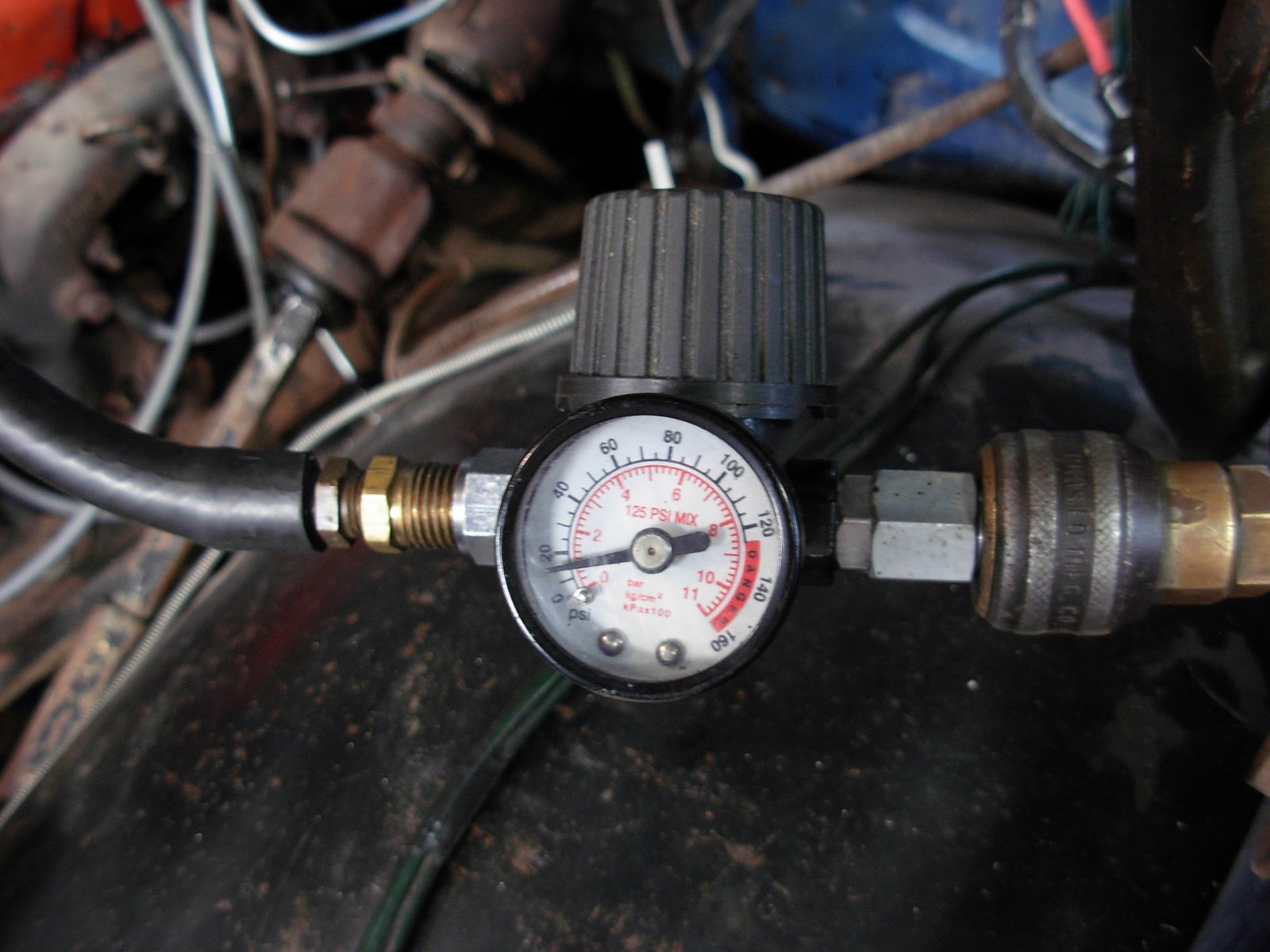

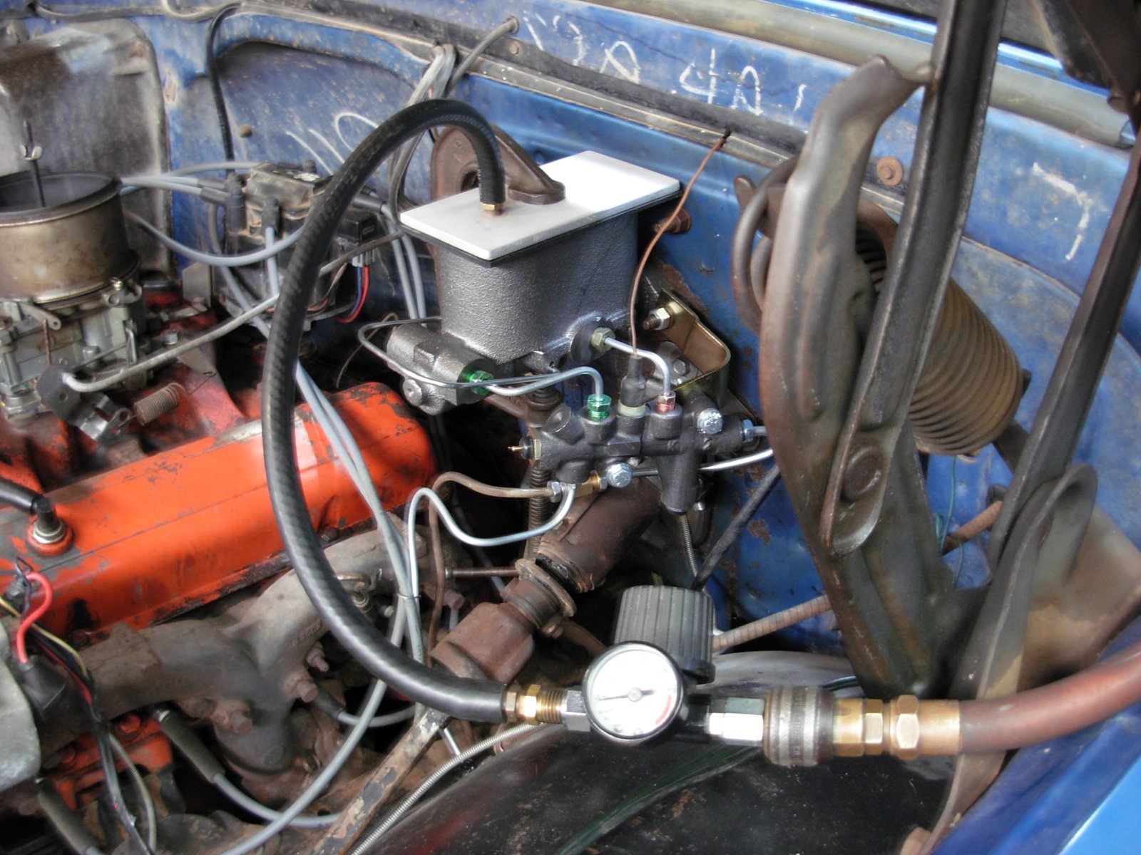

You can use a vacuum bleeder that hooks up to an air compressor....FBEB6AA4-3812-4E1D-B71F-0E6482E8DD15.jpeg
Or use a tool like this Innova that makes the ABS pump...

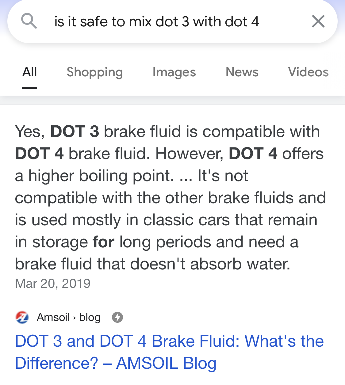

I was also just told that I don’t need to bleed the ABS and I thought that the different fluids were incompatible, but apparently I stand corrected....
