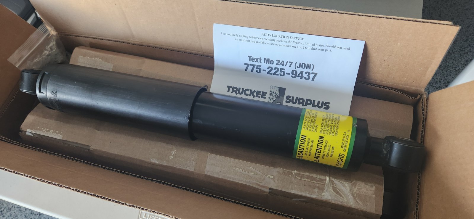

mountie
May 9, 2018
7,195
14,006
I got to know this guy….. He is very smart when it comes to these shocks.
Maybe they are used, but he does his research finding ‘new replacements’ on used / salvaged Yukons & Tahoes.
( about 1/4 or 1/3rd the cost and are warranted )
He sent me a pair, when I thought I needed them….. I didn’t, and I got a full refund )
