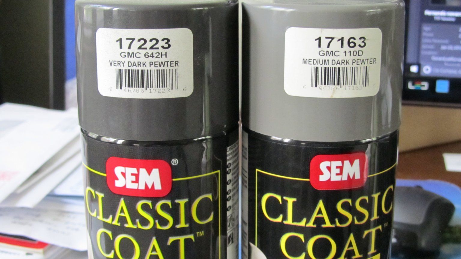

We have the same paint codes, 92I & 922. These are the SEM colors that matched my dark grey dashboard and lighter grey console, door panels and under dash color.
