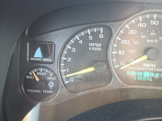

So this what my transmission gauge showed today on my 99 Silverado after about 30 minutes of highway driving. Ambient temperatures was about 70F.
This truck actually didn't come with the external transmission cooler, so probably not a good comparison. I was supposed to add one after I swapped the transmission, but low on priority list of action items.
My suburban is currently down for repairs, but I want to say that one runs a bit cooler (it does have the factory external cooler.

I'd probably recommend comparing the gauge with the PID on a scan tool, just to know if it's displaying fairly accurately. My '04 (4L60e with OE external cooler, not towing) runs right around 150° F after it warms up.
