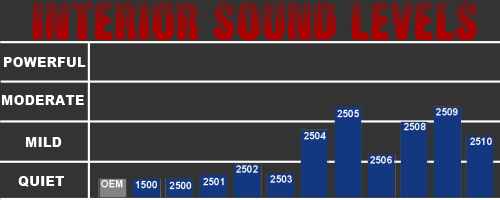

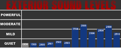

Well before I could dial the Flopro number they responded to the email I sent Saturday. I asked about the difference between the three 9x12x24 models they have.
Their response:

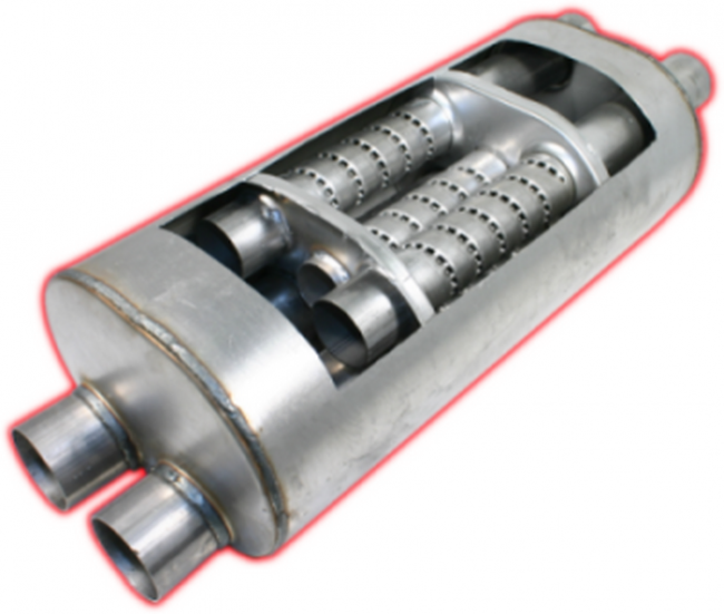

"Howdy, the real only difference the chamber size inside and the size of the pass through holes in the chambers. The 2506 and 2505 will flow slightly more than the 2500. The 2506 outlets are the same as the 2500 which flow slightly more on one bank than the other. The 2505 does not have the offset orientation of the outlets and will flow the same for both side."
I think I'm leaning towards their 2505 now as the 2500 was almost perfect it was just lacking a hint of sound and I didn't like how it necked down. Plus I think I can fit the ultra quiets in if need be.

I called Flopro and the same guy that emailed me picked up the phone (He sounds like a Canadian, but I won't hold it against him). He was so much more knowledgable and friendly than the Magnaflow guy I talked to him for about 10 minutes. The 2505 not only stays true to 3" all the way through, but it also has larger perforations in the baffle tubes. Another major difference contrary to the website which he told me is wrong the inlet and outlet are both in the same spot front to back. The other models 2500/2506 have one of the outlets offset which forces the majority of the exhaust out a single outlet until the restriction becomes too much and then forces it out both sides. The 2505 does not have that restriction. He said they sell a ton of the big oval mufflers for guys that get sick of trying to find another brand that doesn't kill them once they do headers and delete cats.
I just ordered a 2505 and it should be here Friday just in time to use my neighbors lift and try to get this thing installed myself.
I though you wanted a straight-through style muffler? Aren't these "turbo" style? That would explain the need for the larger perforations.

Also yes I did/do want straight through but it is somewhat unobtainable with the low sound level I'm after. At least with the space provided and the amount of money I'm willing to throw at it. Also like we agreed earlier dual 3" is way more than this motor can fill and cause a restriction with. For the future when it may see boost engine masters showed that the boost did not care about the muffler and still made amazing power.
Lastly speaking to the flopro rep made me really want to get another 2505 and cut it open. He said they are significantly more free flowing compared to the 2500 and 2506.
