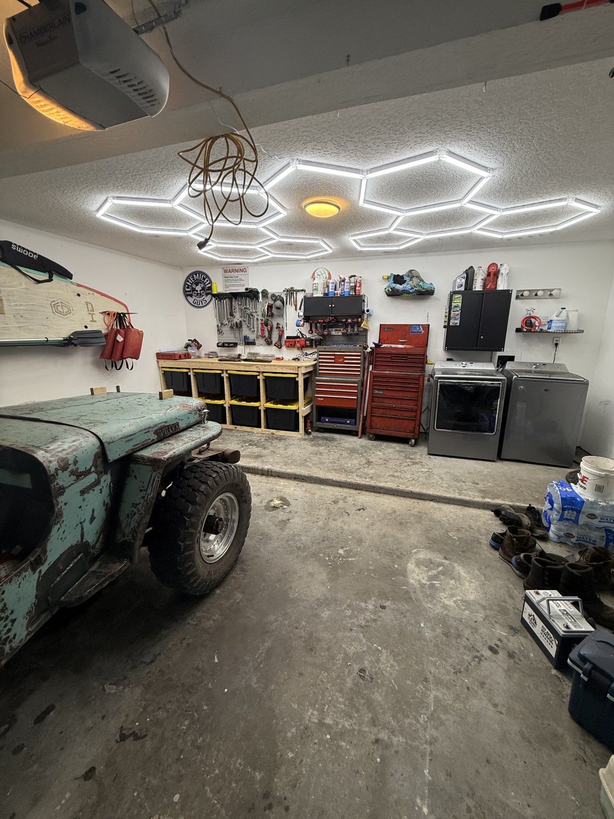

Totally unrelated but I did make some new house garage progress. These hexagon lights are fantastic for the price! $100 for those. The tote storage workbench trend is hot and I see why, it’s very easy to build and works great.

Looks great. I really like that style of light. Have you considered painting the ceiling black?

Yes but that requires work and more whiter is more brighter
