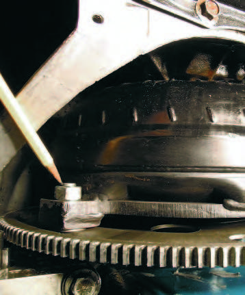

sure it does, or you'd be seeing this. the tc and flex. what you want to see when you take it off.

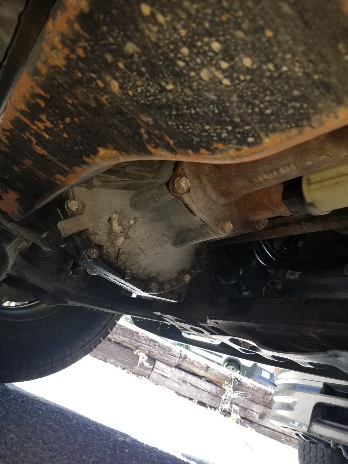

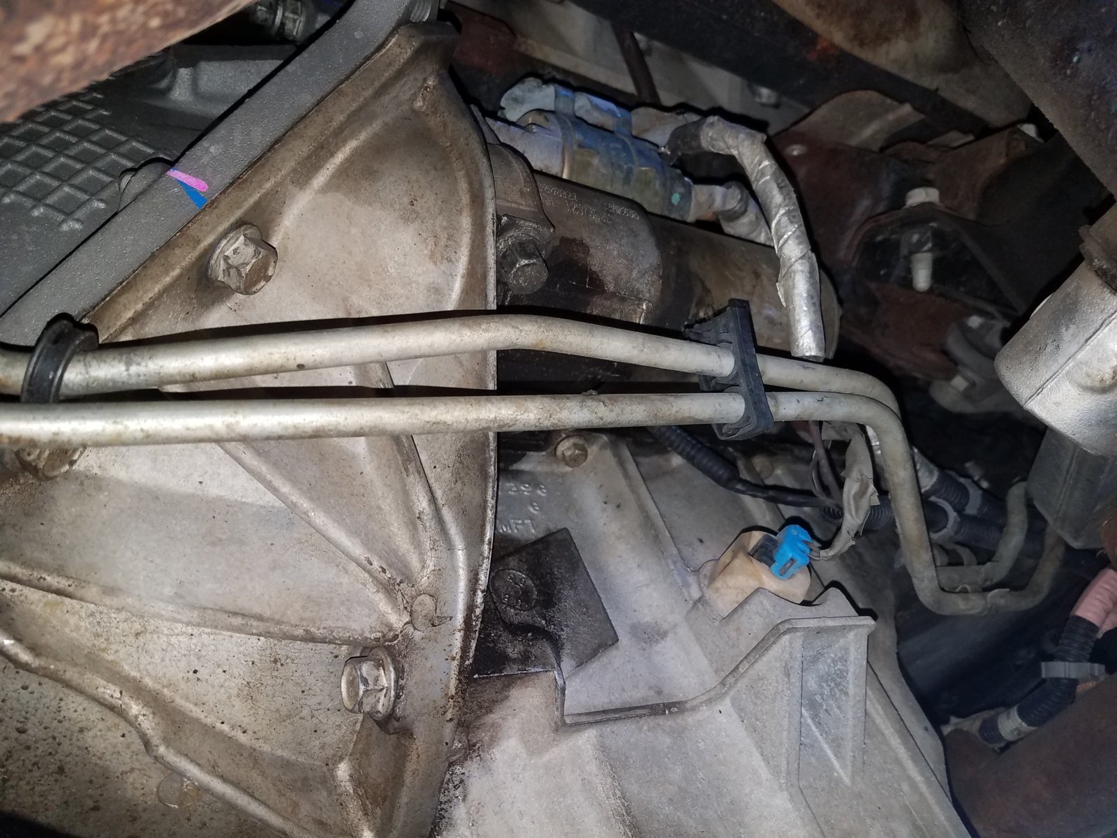

The previous owners put a new transmission in "1000 miles ago" maybe the new one doesnt have it cuz i lookec everywhere
Take some pictures of the bottom if your transmission where it bolts to your engine. I've never seen one that doesn't have it.
52,949
I see 3 pictures of your transfer case....and the one that has your transmission in it doesn't show the bottom of the bell housing. In the 3rd picture from the top, that IS your transmission but the inspection plate would be below the bottom of that picture. If you look at your starter in that pic, then there's a bolt below that, then the inspection plate should be below that in your picture. Just follow the bell housing a little farther there. Maybe you can get a better picture of that area. If there isn't one there, there's a flat plate below the starter that you can remove and look at the flex plate.

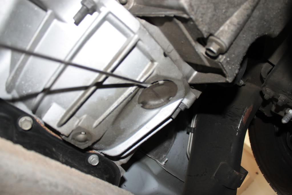

i agree, your looking at the wrong part. where the engines oil pan meets the tranny, you'll find the inspection cover.
Musicars
Jan 1, 2018
116
74
I believe Rocket Man and Scottydoggs have pictures of two different transmissions. My '06 has the small round inspection plug and two small plastic covers, one by the starter and one by the oil filter.
I have a Ford plow truck with the big cover, like Scotydoggs pic, that can be removed to access the torque converter. That truck cracked two flex plates. It was easy to diagnose. I took a small rubber hose and put one end in my ear and moved the other end around the spaces around the inspection cover. It gets really loud when the end of the hose hits those gaps if you have a cracked flex plate. Then remove a cover and see if the noise get noticeably louder. It will be obvious.
