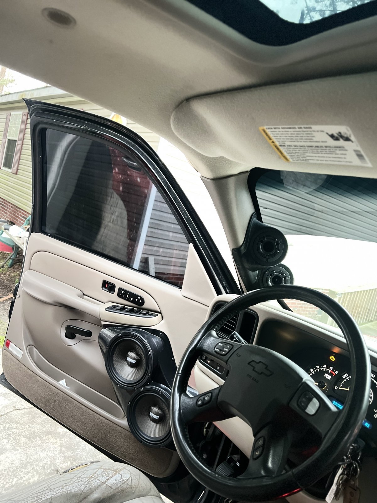

They should be 6.5s and if there not you should have enough room behind the speaker cover you could cut it out to fit
A lot of times you can pop that cover off without taking off the door panel if you want to measure it to see how much room you have.
I don’t think my buddy built his rear doors yet but he has 4 in the door and 2 tweeters in the dash
