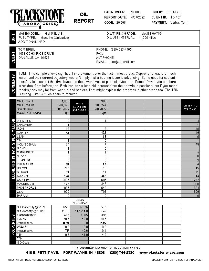

Have you noticed any more top-end power, like at WOT when passing?
Not really as this one was very powerful even before. The differences are that starting up it is not as, how would I put it, graceful? It sounds different more rough when you start it and for the first second or so. But the big difference is that coming to a stop at a light, I have to check the RPM gauge to be sure it is still running. No vibration from the engine whatsoever. It feels like it stopped running at the red lights. Hard to get used to. Thanks again Iamdub. Let's see if I can pull off another 50k miles from this beast. LOL
Interesting.
Is it every time it is started or just a cold start, like after it has sat all day or overnight?
Nice! You won't get that with a GMT900 :rolleyes:. Happy to contribute.
You were originally aiming for another 100K. Even if it only gets you another 50K miles, especially with the current market, you came out WAY ahead.

Cold start only. But again, if I didn't know the before, I don't think I would even have noticed. Everything is relative right? We will see. Maybe this is just the way it will be. Maybe a leaking fuel injector. I changed out the seals and maybe one didn't quite seat well. Gas mileage is the same city and has improved on the freeway. I will report again if the coolant starts squirting out the side of the cylinder head. LOL HAHA. I'll take a video of the look on my face if that happens. HAHAHa.

So this didn't make a difference but I think all is fine IAMDUB. As an update, the car runs great. I think I may have lost some MPG but a very small loss if any. Lot's of power. No sounds to speak of. It seemed like for the first few hundred miles or more, I was losing radiator fluid somewhere. But that has completely stopped. I think it was air in the system slowly bleeding out, hence I had to keep adding small amounts of fluid nearly every time we drove it. The level is perfect and doesn't move. NO LEAKS! :) Anyways, thanks again as this major job was a big success. I learn so much from you and others here. Once again a big thank you!
44,972
It's hard to pin a tiny MPG loss on your engine with the way fuels are always changing. The cooling system in these things can be a PITA to completely purge, so you're likely all good there.
Glad it's still a success for you! Here's to another 200K miles! :cheers:
