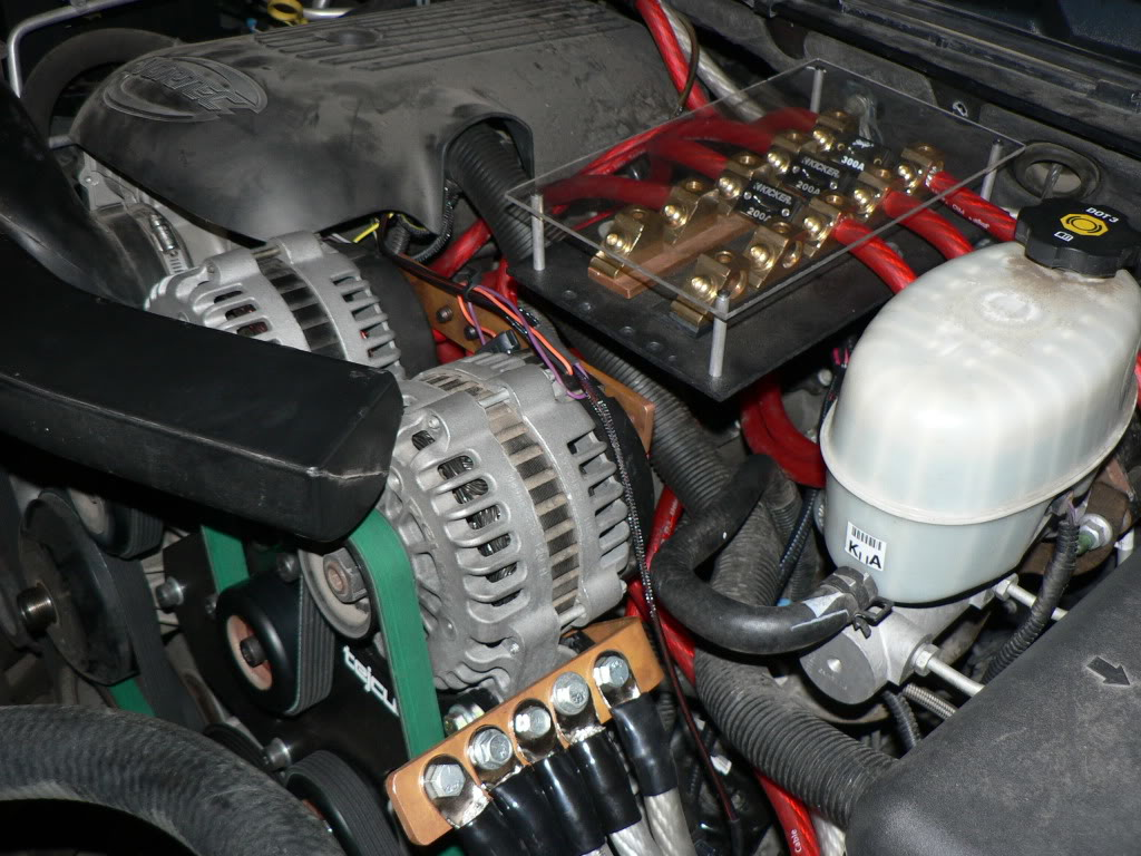

Big Three upgrade is always a good idea on any vehicle, if you ask me.
Here's what mine looks like:

that is crazy! You relocated the battery? Can't figure out where that is.
No, that is looking over the engine compartment from the driver's headlight area. Battery in that shot is directly under the bottom of the picture. There's also a second battery on the passenger side up by the firewall, an Odyssey AGM. I have since separated out my stereo electrical and vehicle electrical. Stock alt runs the vehicle and stock battery. 300A Ohio Generator alt runs the AGM battery and the whole stereo system.
