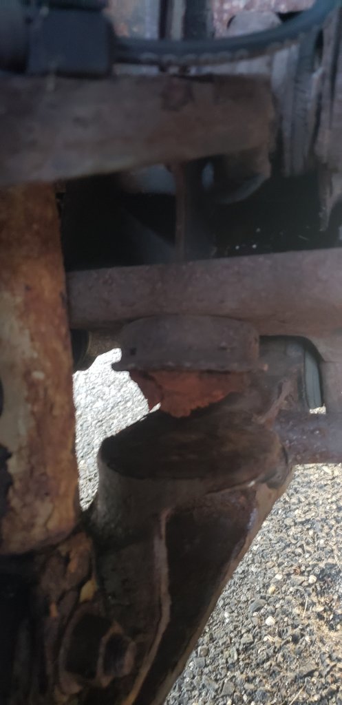

The other day I noticed what was left of my front bump stop under my 2002 tahoe. The bump stop cup is corroded and came off while i was poking around. That cup seems to be a welded on part. Any ideas on how to replace the cup? I really don't want to ride around without the bump stops. Any thoughts or suggestions would be greatly appreciated

Is it a 2wd or 4wd?
Look like this? https://www.rockauto.com/en/moreinfo.php?pk=10370532&cc=1380372&jsn=911
Or this: https://www.rockauto.com/en/moreinfo.php?pk=10371540&cc=1380372&jsn=913

Thank you for the quick response. It is a 4WD Tahoe. The bump stop looks like 2nd picture (like a beehive). This is the passenger side. Notice there's no bumper stop cup
For comparison, this is the driver side

Yes, a lot of rust underneath. Salty NE roads in the winter, salty air year round living near the ocean. This tahoe is a great truck. At 233K miles everything works and it runs great. Unfortunately I think the rust from underneath is going to be what does it in.
What is the downside if I continue to drive the tahoe without the front bump stops? I don't go off road with it

The bump stop is there for extreme deflection if the suspension travel exceeds normal driving. I was told once that they also were designed to actually touch all the time for better stability. I always thought a bump stop was for what I just said but sometimes if you ask 3 people's opinions you get three answers that are all different. If if drives ok, don't worry about it. Others here may have other recommendations for you though.
