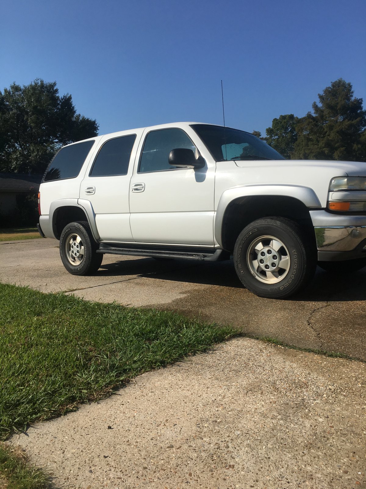

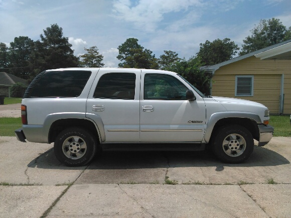

Picture as is sits now. Stock tires are 245/75-16
Front driver : 34 1/2"
Front passenger : 34 1/2"
Rear driver : 35"
Rear passenger : 35 1/4"

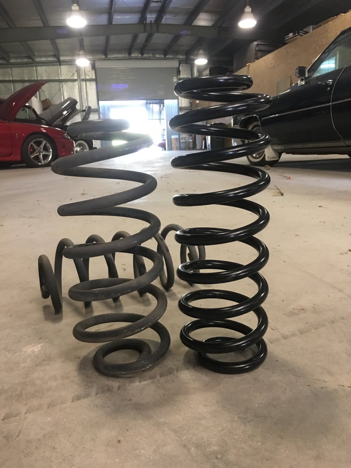

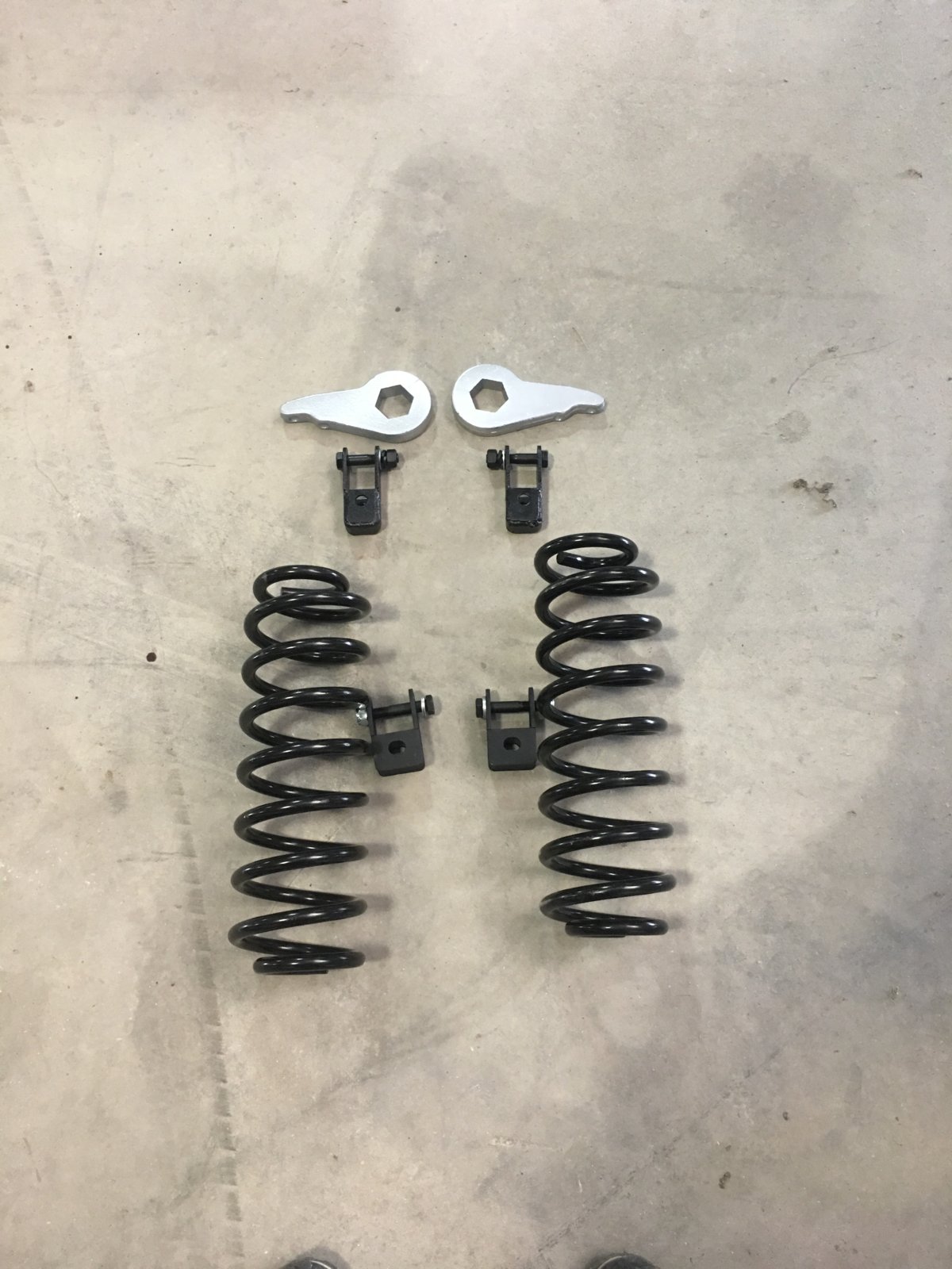

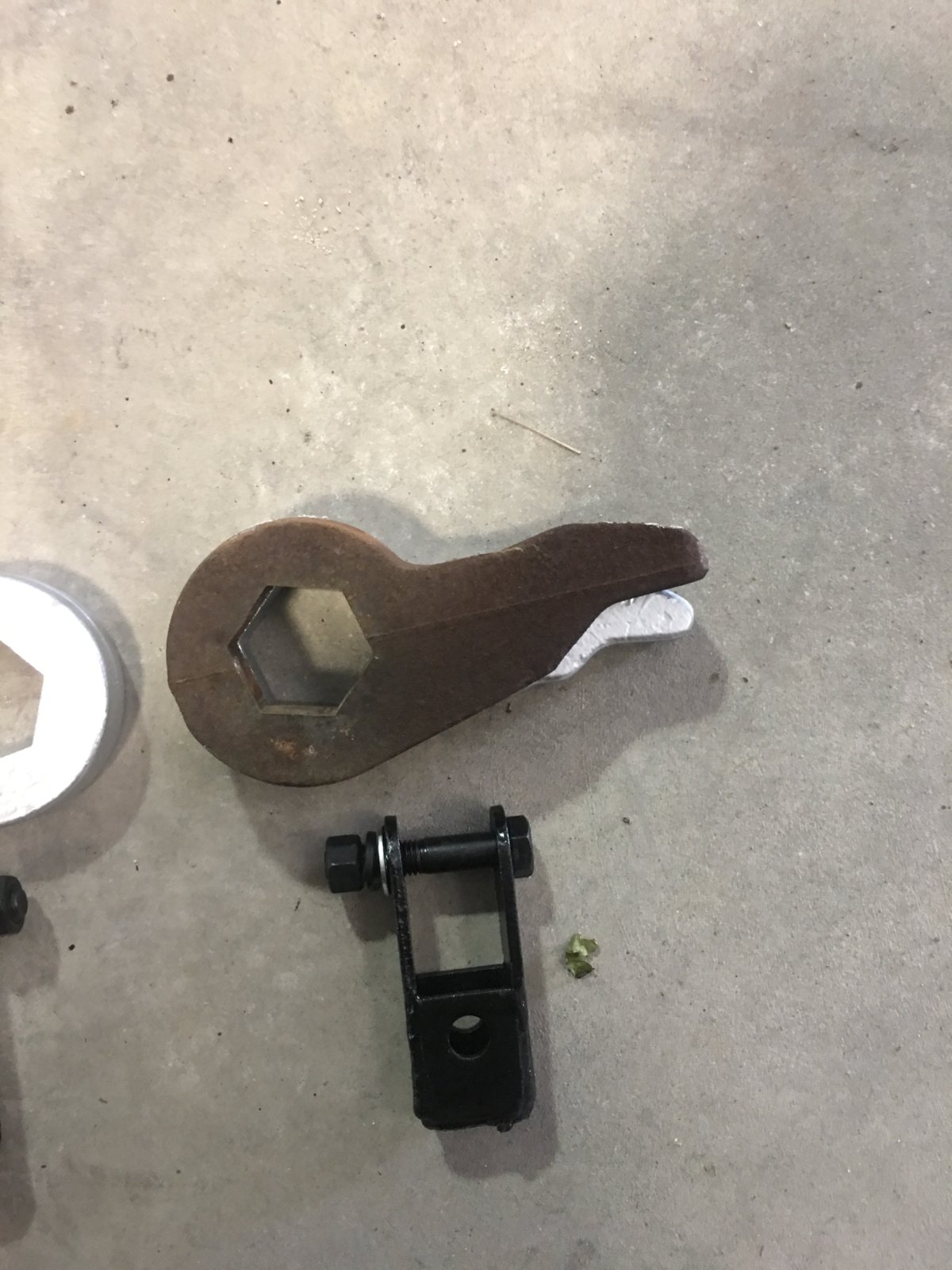

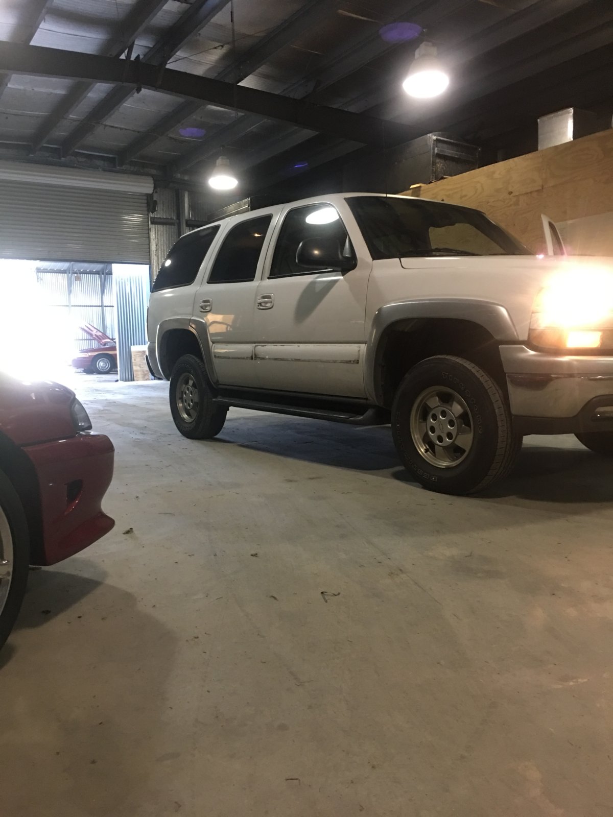

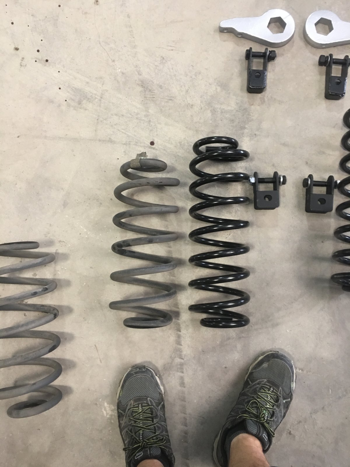

All the parts are installed. Wasn't bad at all. Definitely need some tires now. The z71 coils gave me almost exactly 2" lift.
After measurements
Front driver: 37"
Front passenger: 37 1/4"
Rear driver: 37 1/4"
Rear passenger 37 1/2"
Not bad considering I only spent $100 so far. Here are a few pics to compare stock parts to new parts.
