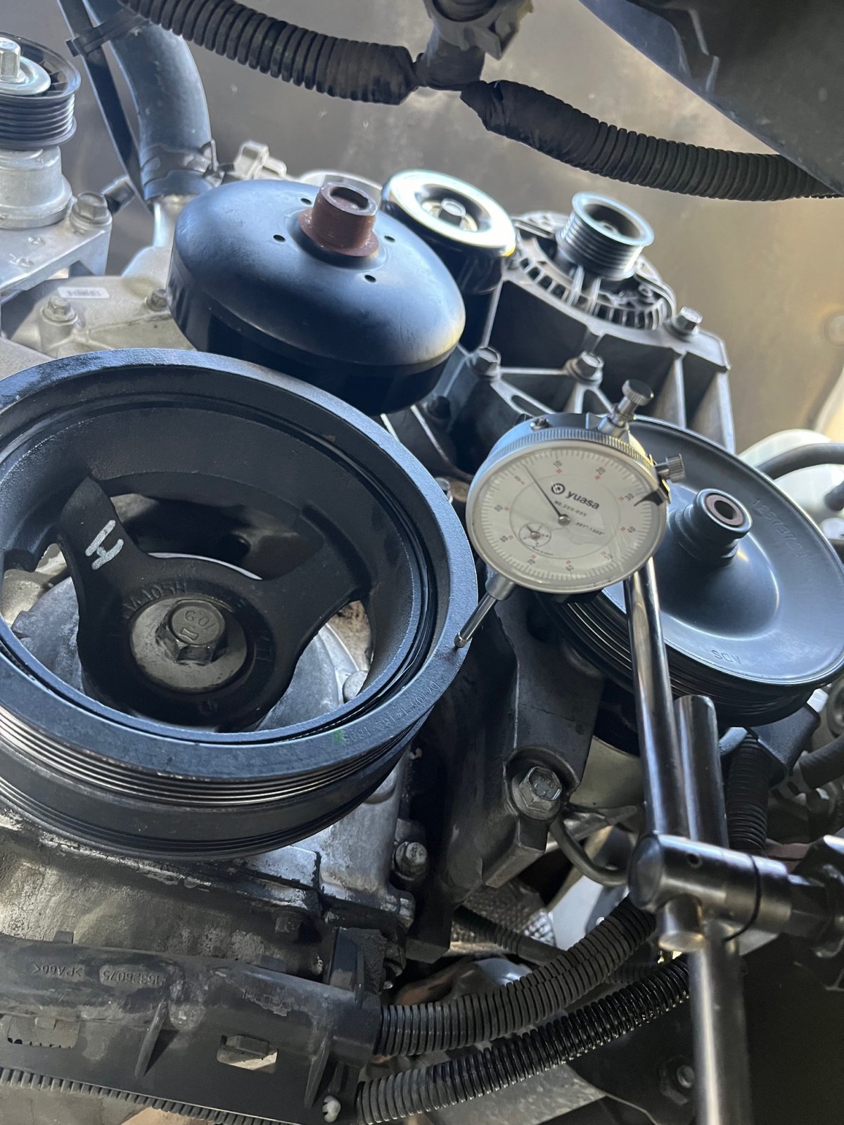

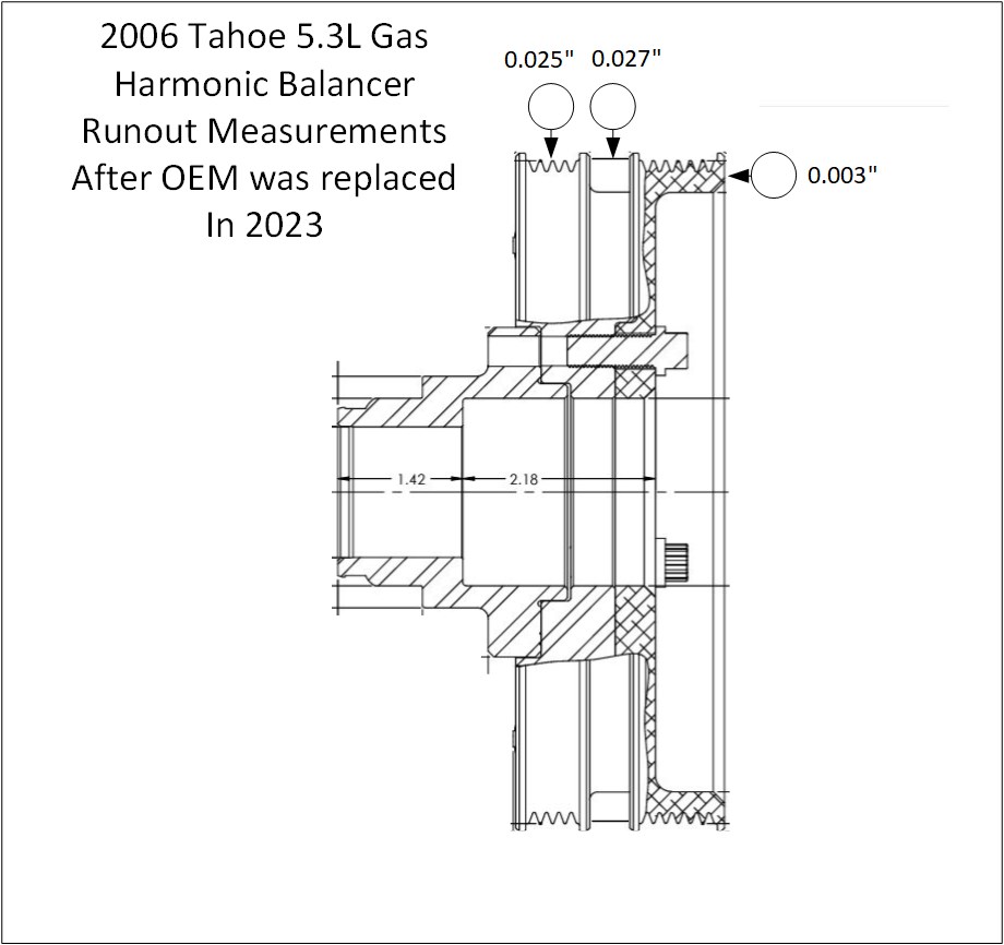

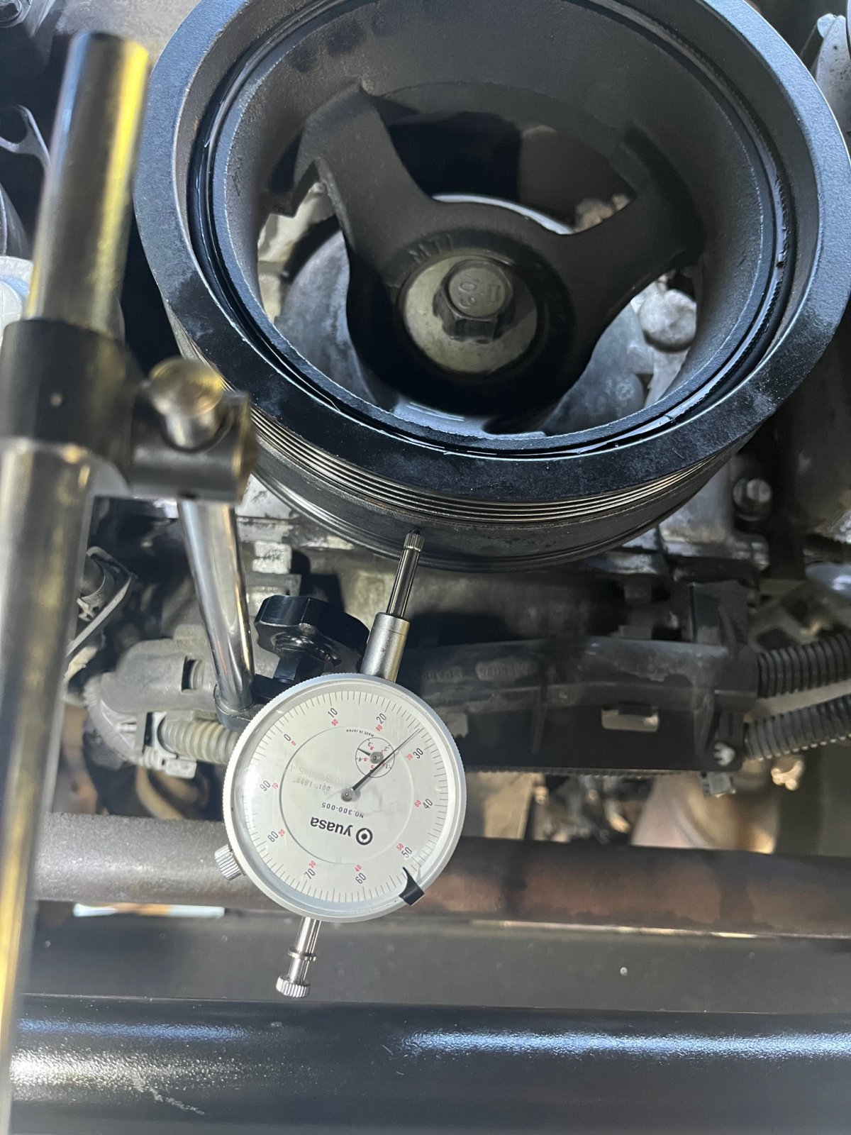

okay - Took the measurements. Radial runout 0.023", Spec. is 0.40mm (0.0157")
I have a bunch of pictures if anyone is interested. My mag. base for dial indicator worked perfectly.

In case pictures and diagram are wanted or not.
