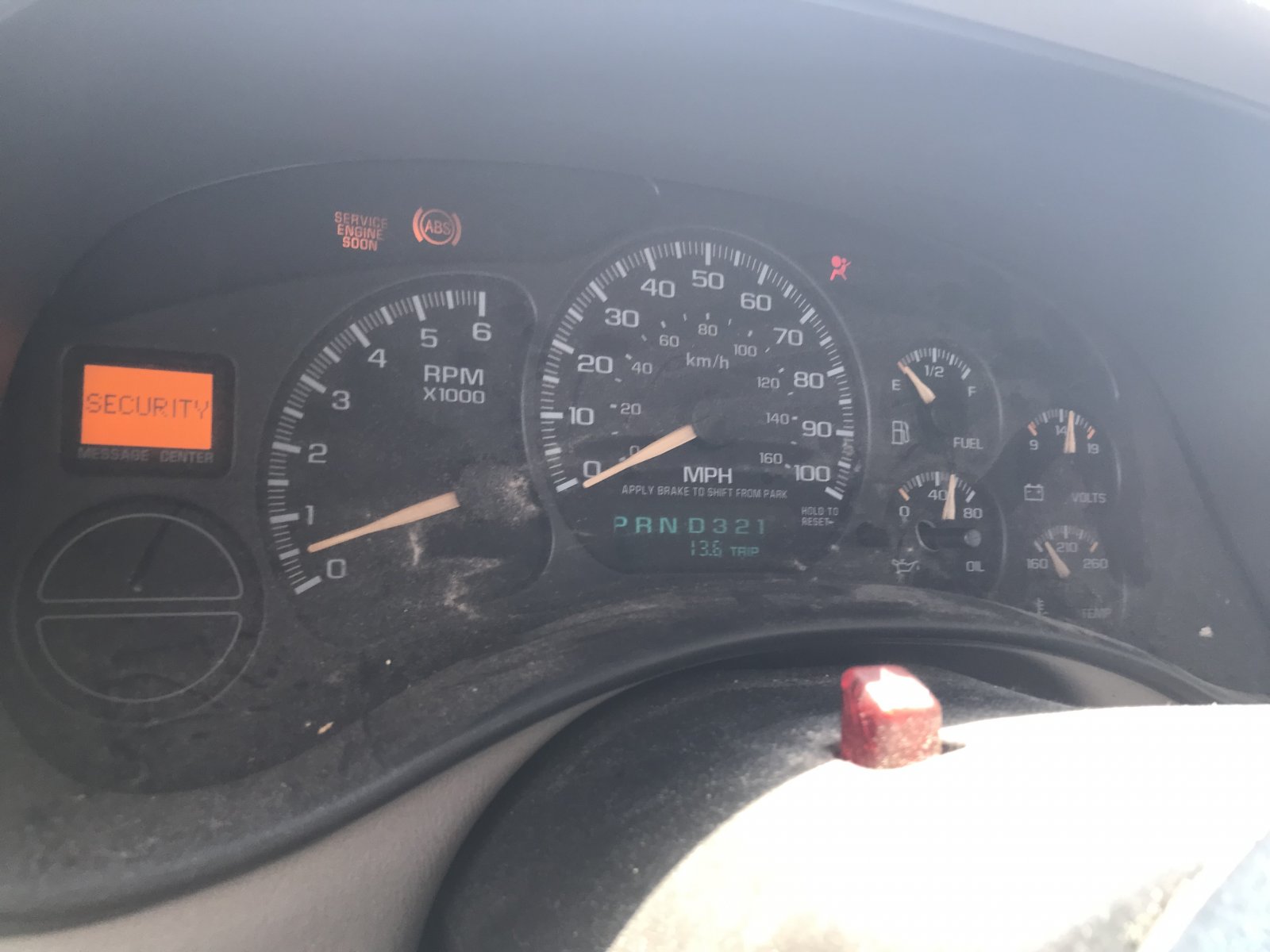

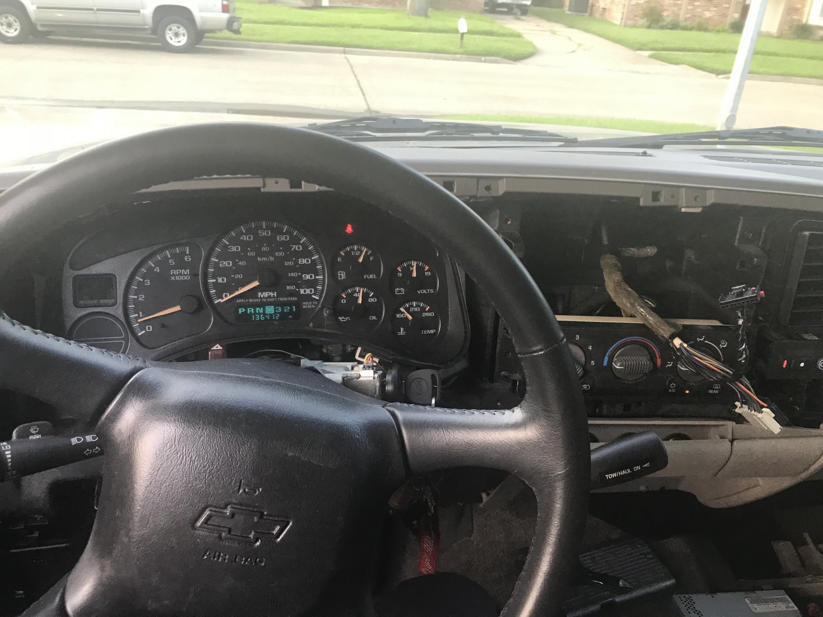

I’m having a weird issue with mine too, some lights come on, couple gauges stop working, and lcd starts flashing low battery and low gas then it starts working again. Very intermittent.
