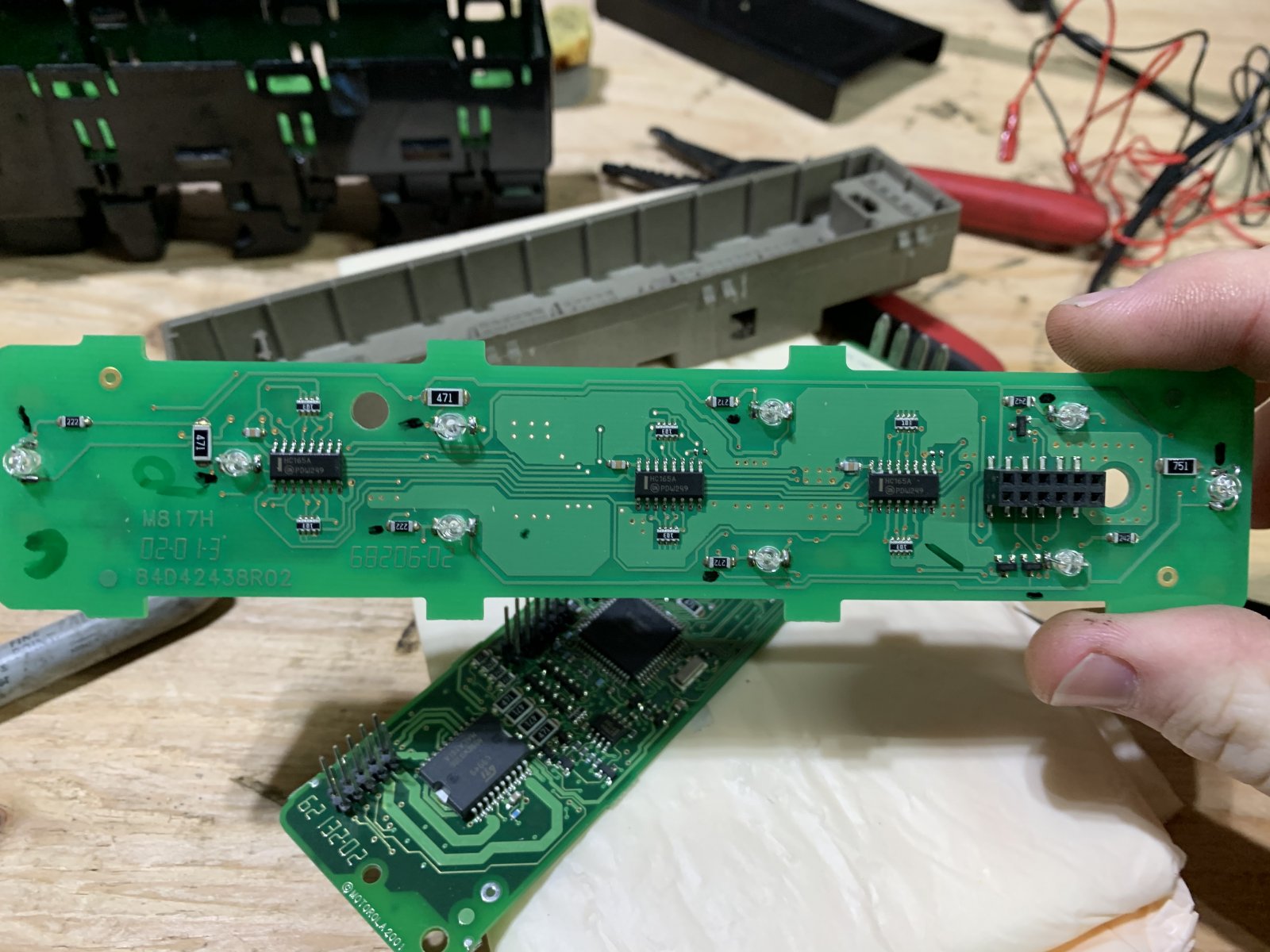

This is a pretty labor intensive project. And I can certainly see where a problem would come in when an led that’s supposed to last 10 or 20 years fails in 6 months, and then you’ve got to ship it back, replace ship... yeah. I could see that being a PITA.

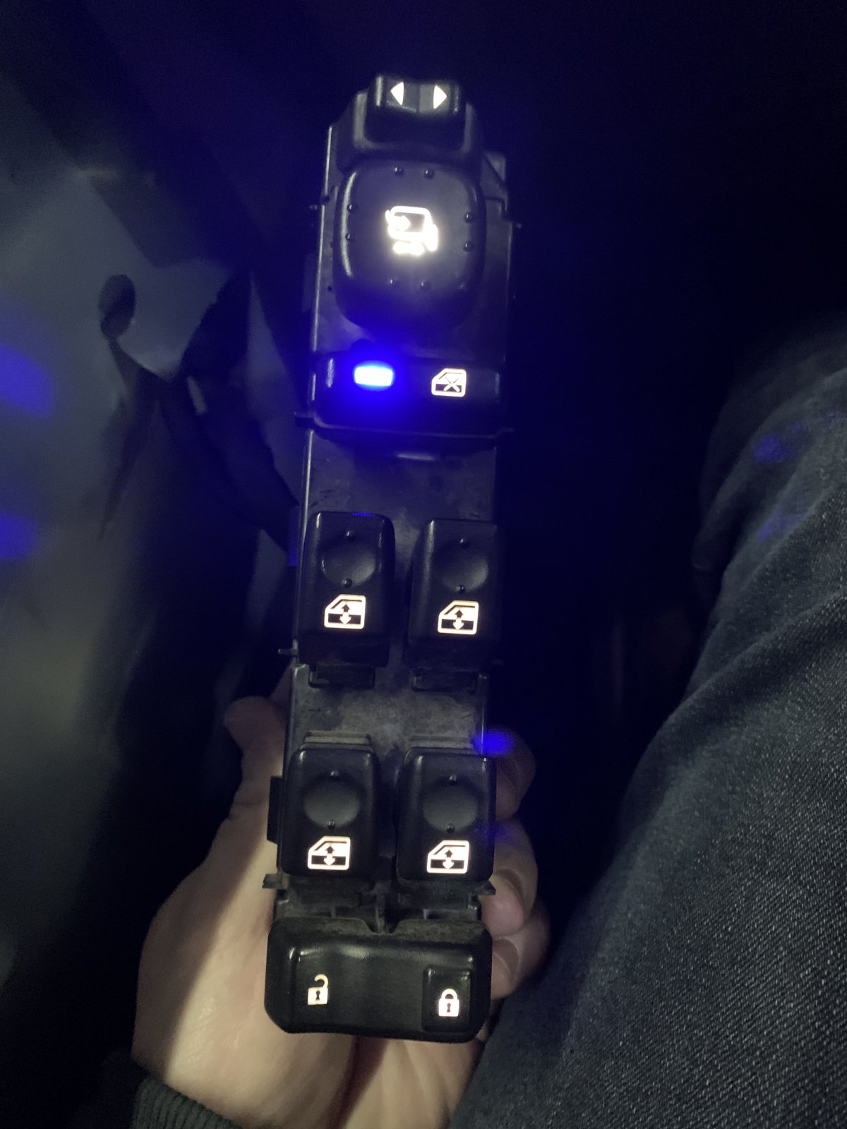

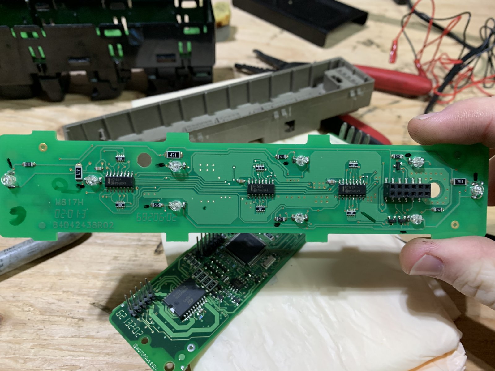

Yeah that’s a lot of it. I’m using amazon leds currently that are 50 for 12 bucks I have only had them in mine for a little while and I’m not sure if they will last a super long time or not. They should but there always is the what if’s. There are already more than a few places that do led or color conversions as well. As of tonight I finished up my buddies Tahoe switches. First time doing 03-06 interior switches but I’m around 15-20 hours from start to finish over 3 days. I’m sure if I did it a lot I could probably cut that time in half easily. Especially now that I know tricks to do it quicker, polarity of all the switches, and what not to do. That’s the biggest part of it though is labor intensive and tedious work that I’m doing after working a full day of my normal job lol
Yep. Sounds about right. I spent about 3 days doing mine, and stopped after the driver door switch because I’m not happy with those. So looking for some smd LEDs to replace them.
I used 3mm on the driver door switch. Just used a 1/8” drill bit to open the holes and the leds sat in there perfect. They turned out really good the mirror adjuster is brighter than the rest is all from there not being any type of diffuser behind it.

I used 3mm on the driver door switch. Just used a 1/8” drill bit to open the holes and the leds sat in there perfect. They turned out really good the mirror adjuster is brighter than the rest is all from there not being any type of diffuser behind it.View attachment 240898View attachment 240897
That’s a thought. I used 3 mm as well, but they’re squared off. Didn’t think about drilling them out. I may do that. They’re in the perfect position under the board but still aren’t as bright as I’d like.
the squared ones are the 360° bulbs aren’t they? I flattened out a couple on the climate control and seat heater switches to give it a more even light overall. Cause the round ones I have are basically more of a spot beam. The squared 360° ones were like a buck a piece where I found them. Not cheap by any means.

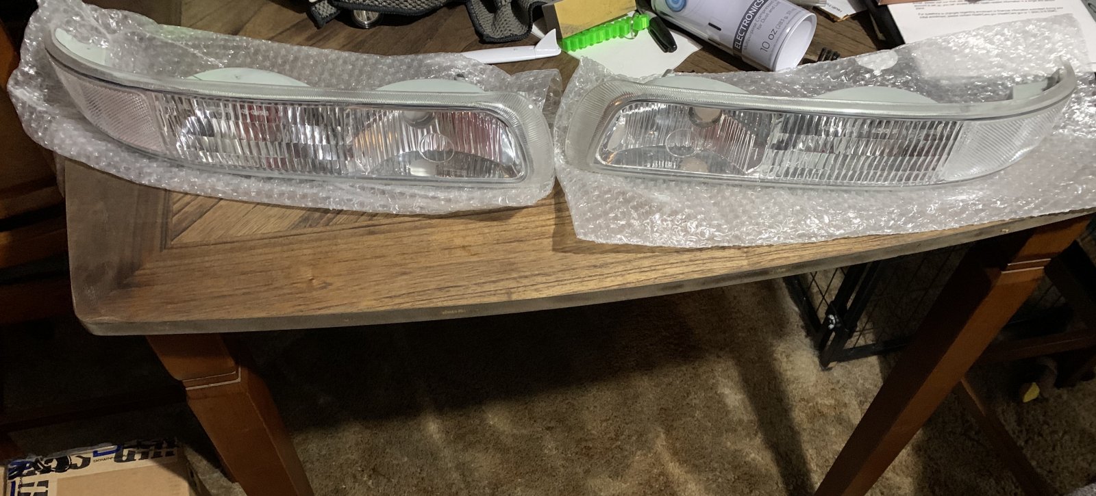

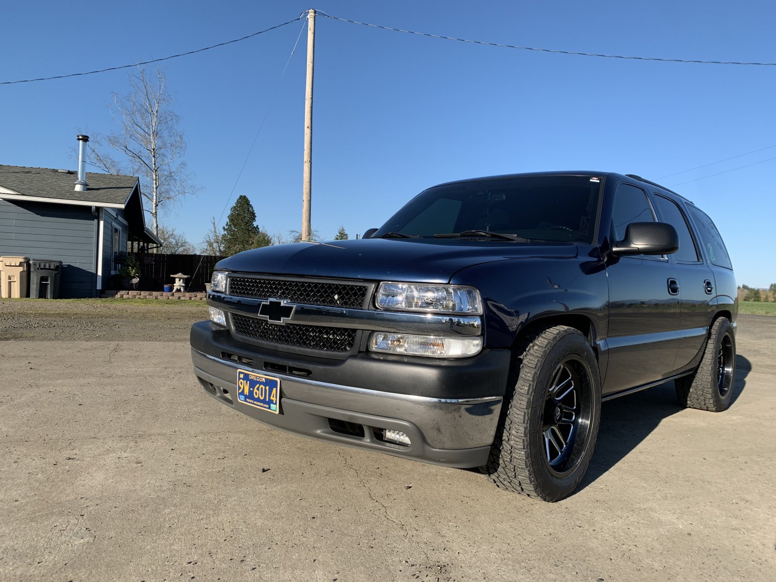

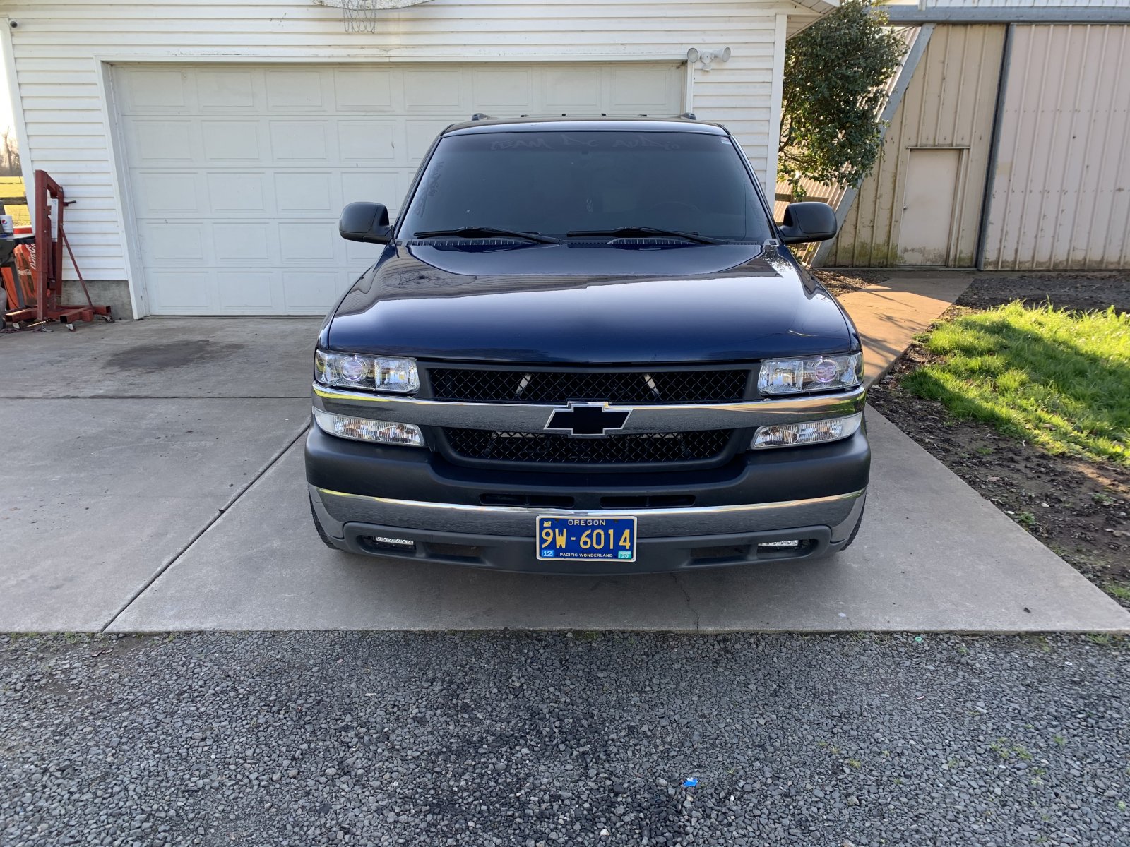

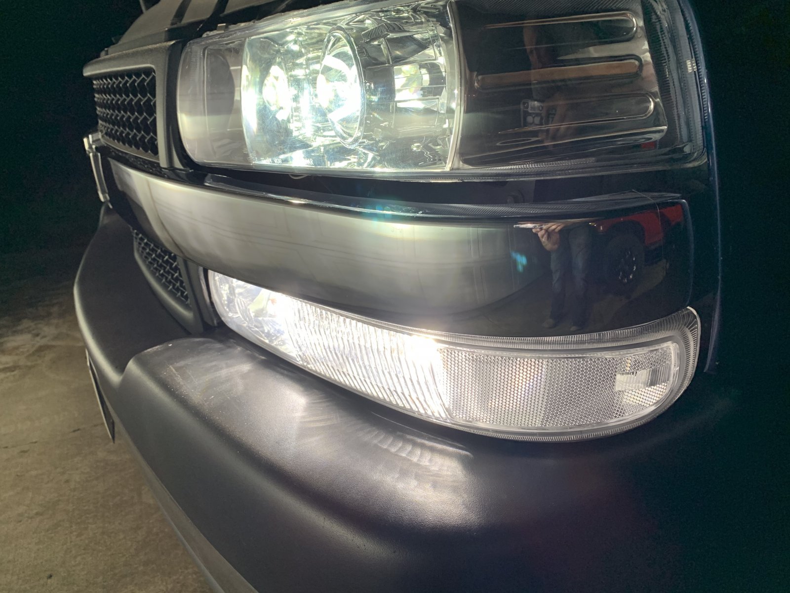

Finally got a nice day and was able to grab a couple pictures. The door handles look awesome but I really need to get my mirrors paint matched now it’s bothering me lol.

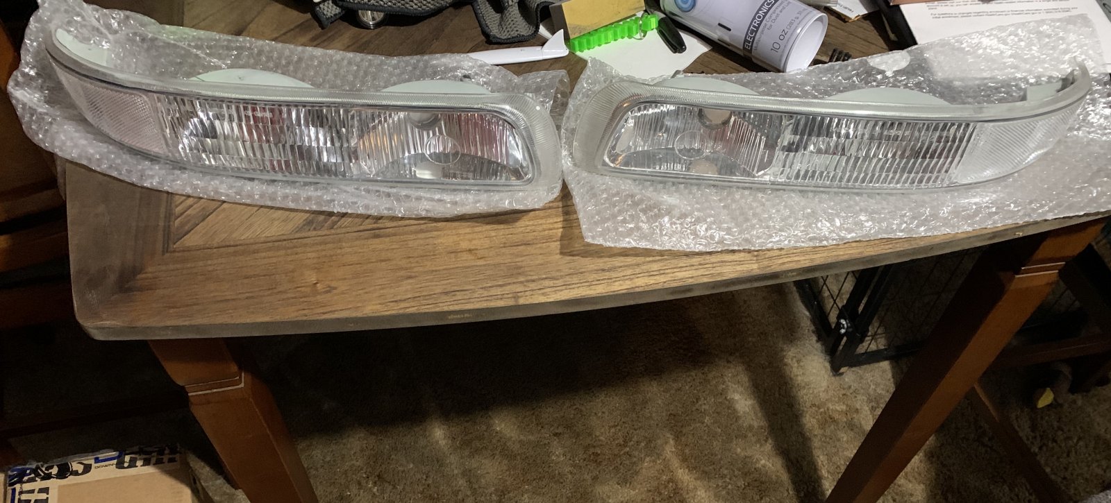

I said last week that my buddy who I’m doing all the Tahoe switches for surprised me by sending something as part of payment. Something I have been searching for for 4 years....
Opened the box to his switches and he tucked away these without telling me. APC oem style clear corners. I am beyond excited and still kind of shocked. I know they are just corner lights but I absolutely love these and have always wanted them since I got my Tahoe.
Opened the box to his switches and he tucked away these without telling me. APC oem style clear corners. I am beyond excited and still kind of shocked. I know they are just corner lights but I absolutely love these and have always wanted them since I got my Tahoe. View attachment 240944

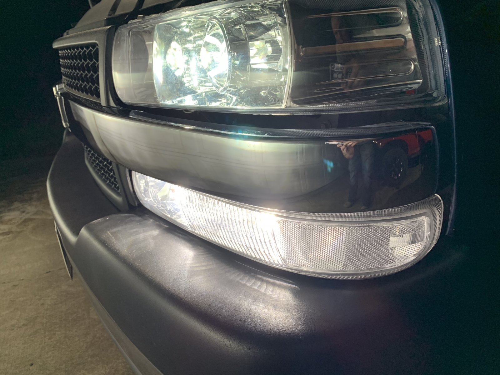

View attachment 240946 View attachment 240947 View attachment 240948 View attachment 240949
Score!! Looks great man!

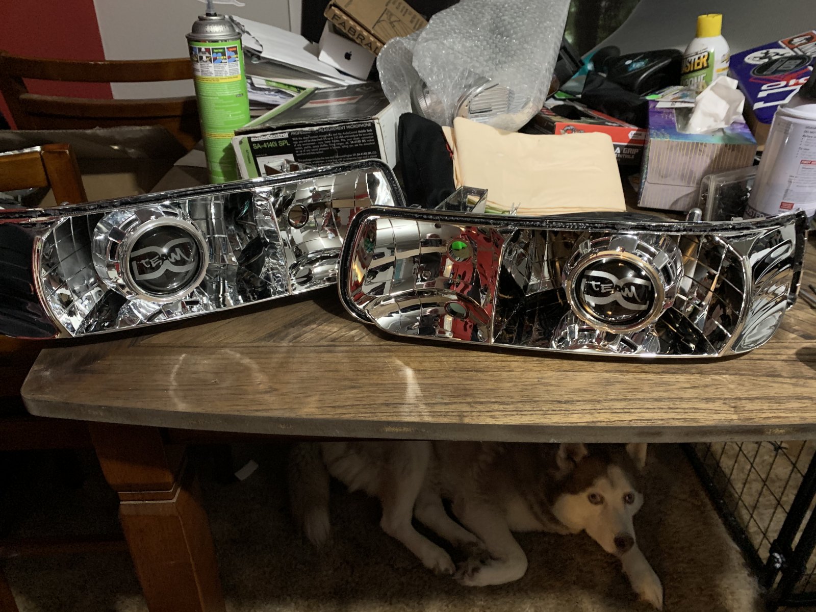

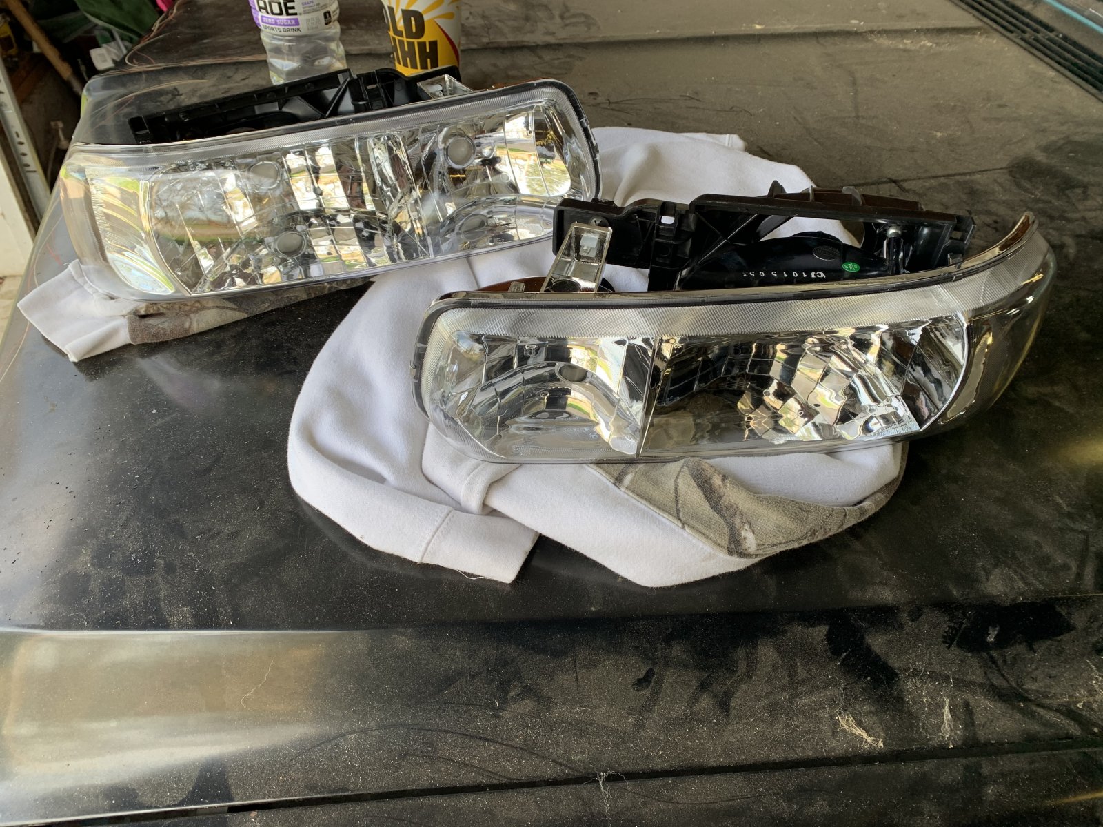

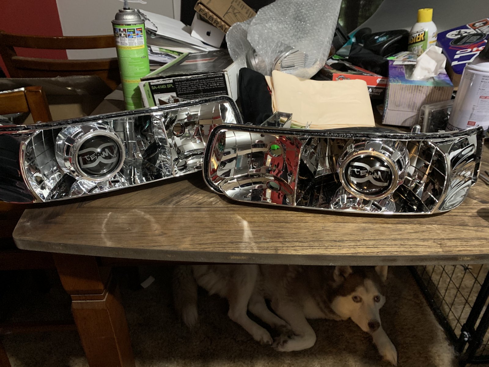

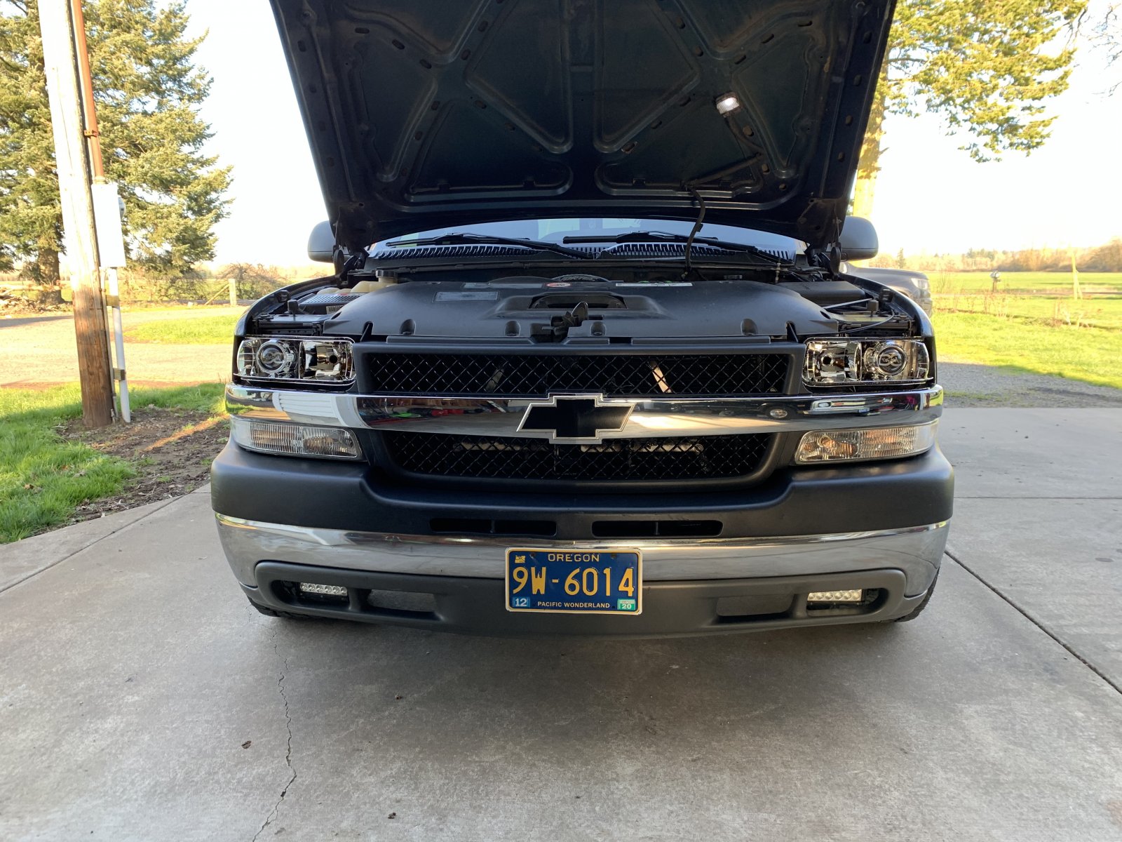

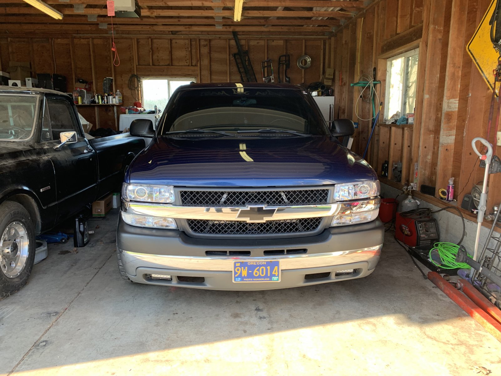

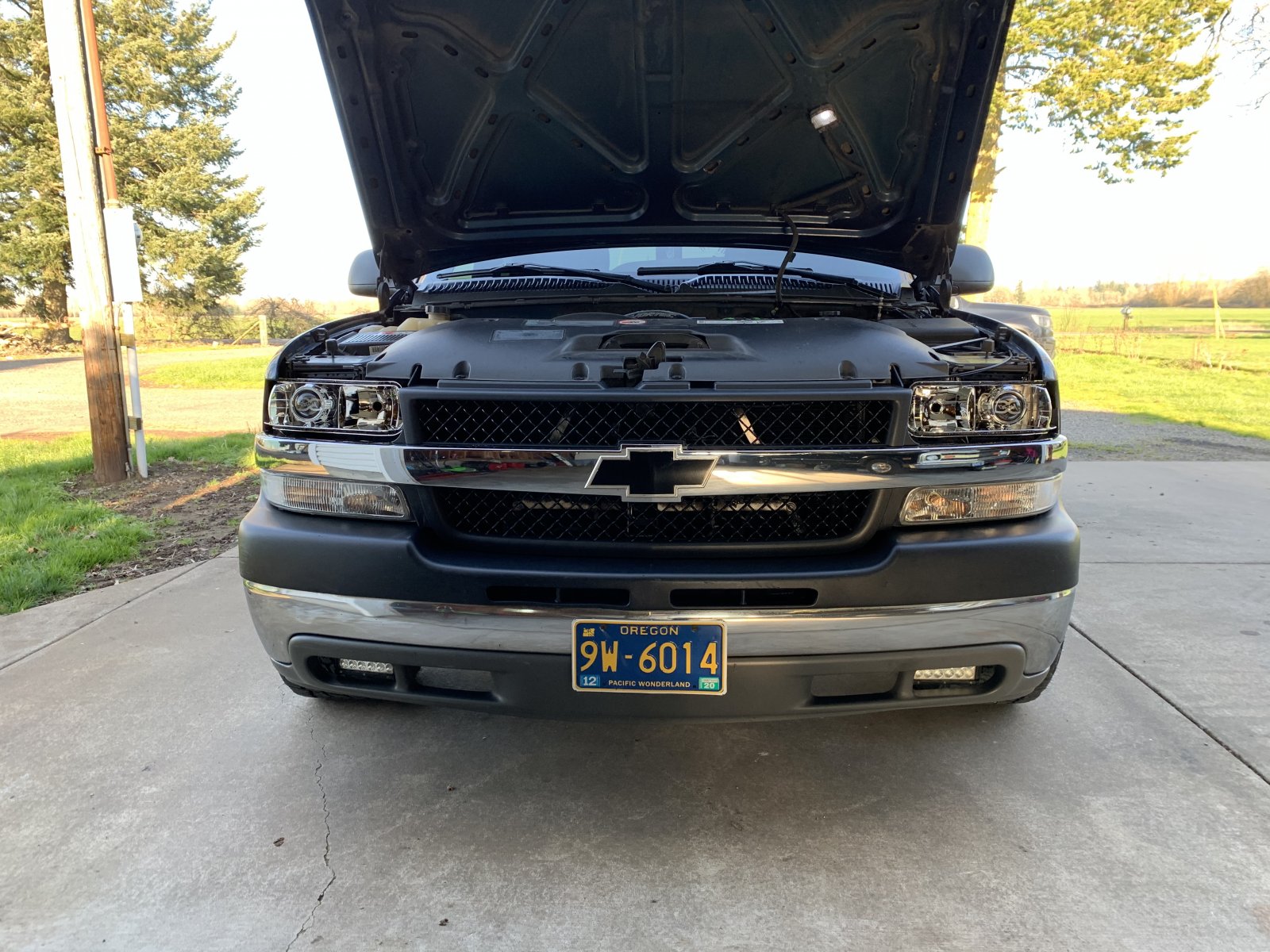

Got some spec d lights that actually have a deeper passenger side housing because it was bothering me so bad how the passenger projector was so close to the lens. Swapped them out pretty easily. Used the brackets from my depo housings though the spec d ones were flimsy and cheap feeling. After getting them aligned twice(first with the spec d brackets, then with the depo brackets) they still have more of a gap underneath compared to before. Something about these though they don’t fit as nice and probably no one will notice it but me. Oh well the projectors fit a lot better and now are even on both sides. Maybe it’ll bug me enough to try a different brand housing one day. For now Gonna leave it the way it is. I’ll try to grab a better picture during the day to show the gap.

Got some spec d lights that actually have a deeper passenger side housing because it was bothering me so bad how the passenger projector was so close to the lens. Swapped them out pretty easily. Used the brackets from my depo housings though the spec d ones were flimsy and cheap feeling. After getting them aligned twice(first with the spec d brackets, then with the depo brackets) they still have more of a gap underneath compared to before. Something about these though they don’t fit as nice and probably no one will notice it but me. Oh well the projectors fit a lot better and now are even on both sides. Maybe it’ll bug me enough to try a different brand housing one day. For now Gonna leave it the way it is. I’ll try to grab a better picture during the day to show the gap. View attachment 241019View attachment 241020 View attachment 241021View attachment 241022 View attachment 241023
Look good from here. I had to use my oem brackets also. Bought the Spec D's, and like you said--brackets are cheap n flimsy. I have a similar gal as you do. Just gotta learn to just walk away sometimes.
Do yourself a favor and run a thin bead of silicone are the inner edge of your lights, along with some dialectic grease on the bulb gaskets. If not, they're GUARANTEED to fog.
okay will do. They seemed to seal up a lot better when I baked the lenses back on at least so I was happy about that. I drove it last night work and so far they haven’t fogged but it was a short trip so we shall see. My depos I was constantly fighting them fogging lol. At least they are even with the big gap haha.

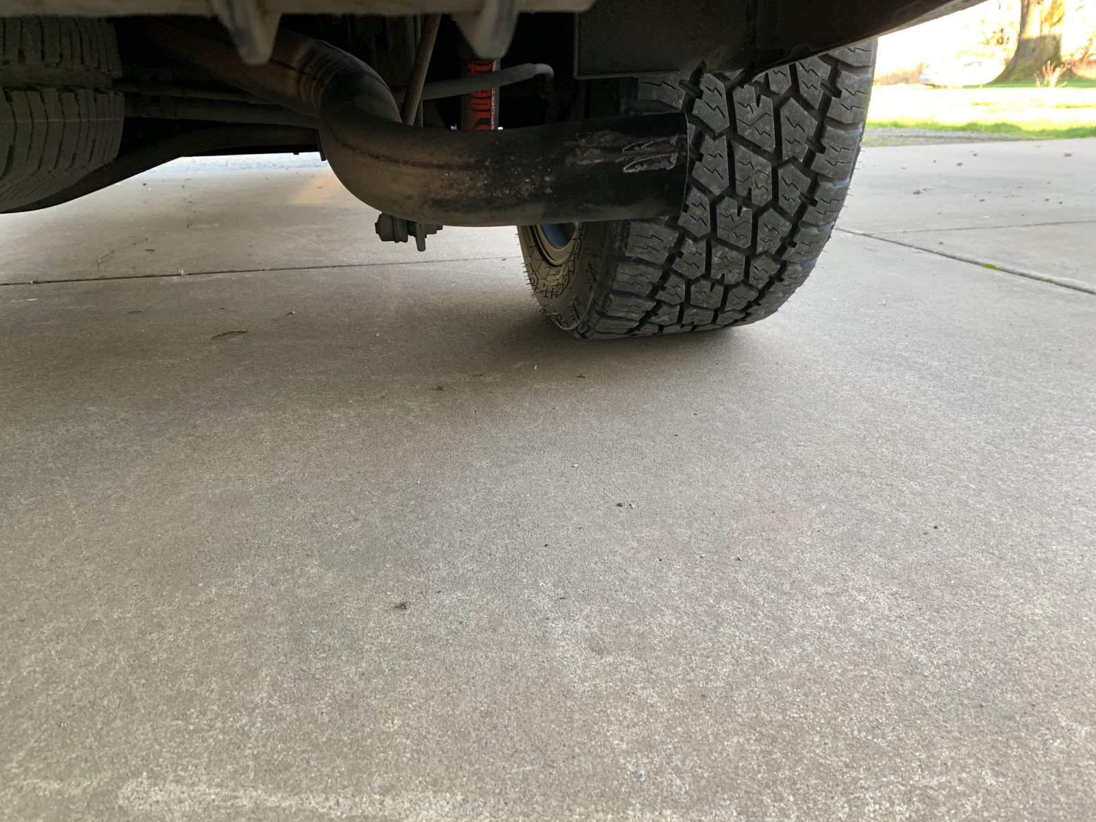

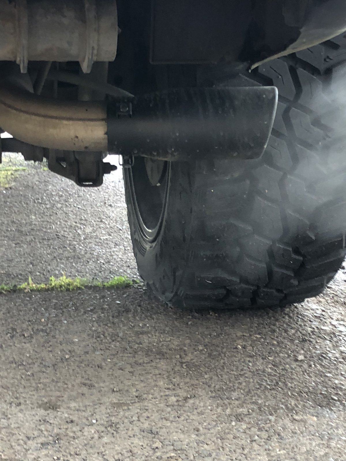

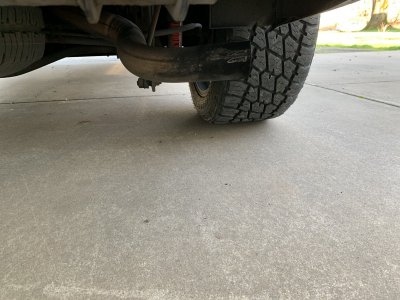

Damn exhaust tip fell off at some point within the last week. I guess I can’t be to mad about it though because it sounds better now. It was a resonated tip and actually did affect more than I thought it would have. I never was the biggest fan of it though anyways it was a black 3.5” but looked tiny. I think I might need a 4” one but I don’t want it to look like a damn garbage can hangin off haha. Guess I’ll need to stop by the local exhaust shops to see what I can find. Also took of my LS d pillar badges last night and the green sticker. Looks much better now
