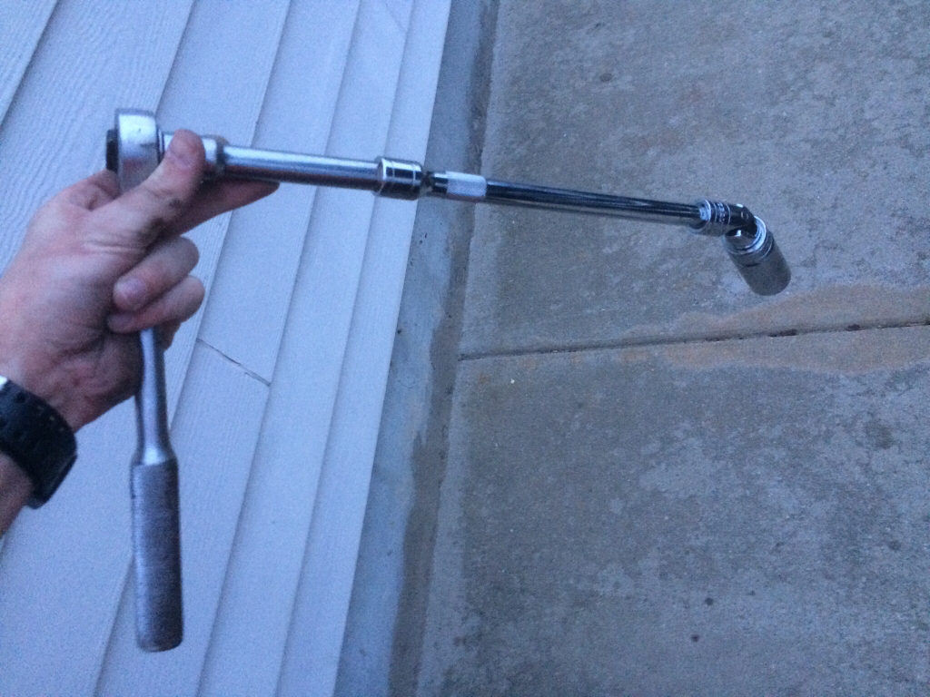

sensor is an easy swap. I know some people on youtube vids disconnect the fuel rail. I was able to do it with a socket, extension and a swivel. left everything else on. took no more than 10 minutes total.

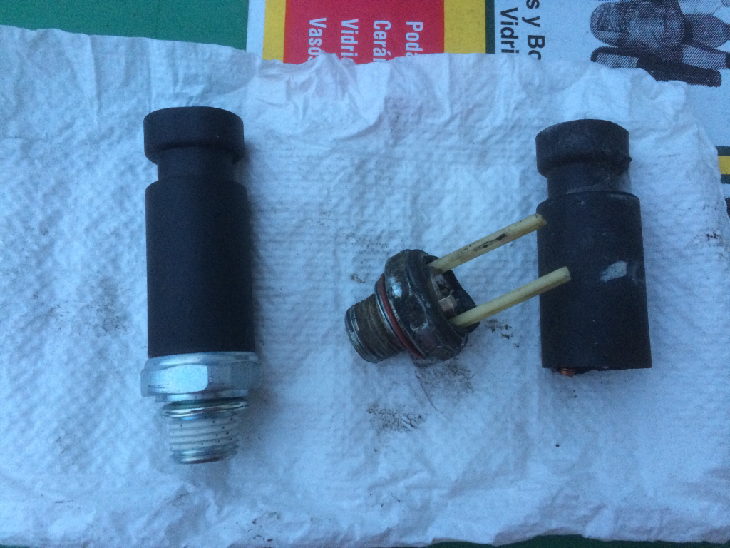

So I finally had some time to put the new sensor in. That fixed my problem! No more crazy needle.
The old one ended up breaking in half on the way out.
Had to use this monstrosity to get to it.
