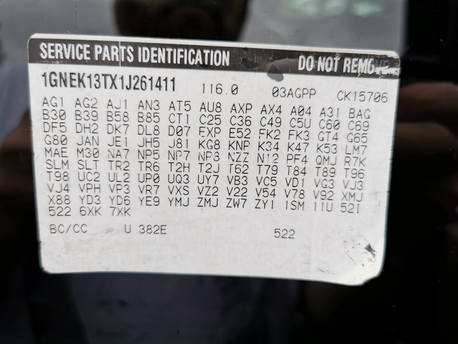

took a picture of all the RPO codes, since I have no idea what the codes mean.

for some reason I could not get the picture in my edited post.

by vin#, the gm part#15732808 (au8 export)
