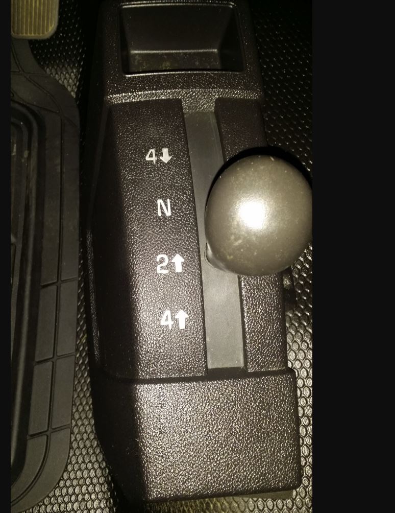

ok, I guess some do and some do not.
some will have a switch like this (no auto) I'nm guessing it depends on the trim level.
30,750
48,438
Is there anything that happens with the front hubs/ differential? I’m wondering what “tells” the transfer case and front axle to lock everything in 4wd.
the encoder motor and actuator are engaged with a switch
some of the base level pickups (old and new) have a manual hand control on the floor, like old school 4wd
never seen it on a suv though, at least not since 00
