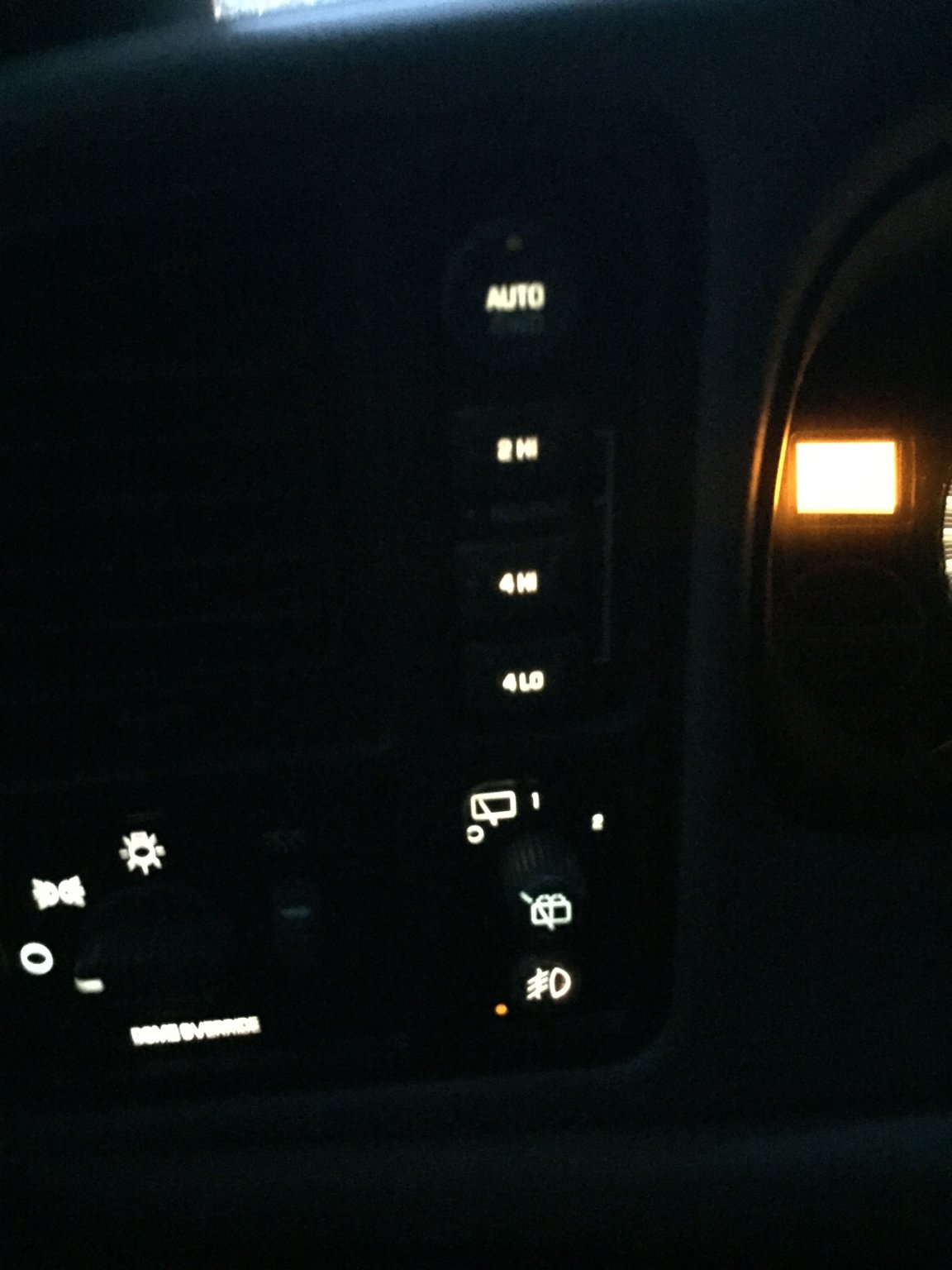

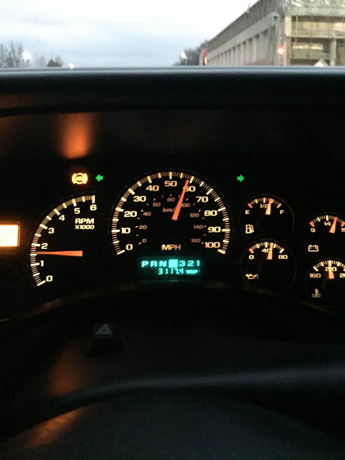

IMG_0267[1].JPG IMG_0270[1].JPG I'm going to attempt to make this as clear as possible. 2 months ago I hit a deer and had my entire front end replaced. A lot of electrical issues started to happen after the front of the vehicle was fixed through insurance. They would not cover the electrical issues because I could not prove the accident caused it.
  1. Rear Wiper flickers when I apply the brakes
  2. Cruise control shuts off when I engage the blinker. Sometimes wont even turn on in the morning only or will randomly shut off.
  3. ABS and Brake like intermittent. ON then OFF all day everyday.
  4. service 4wd light on only in the morning
  5. Fog lights button indicates the lights are on all the time even though I don't use them
  6. daytime driving lights will not work at all with new bulbs.
  7. 2WD light is not illuminated.
  8. Car will shut down while driving (gages will all be lit but they will not work for a second) then randomly pop back on when I start slowing down.
I think it is all do to a bad ground but will never be able to determine where.

I currently do not have any pictures from the accident (on old phone). The damage was all head on..radiator, A/C compressor, bumper, both headlights with running lights and blinker location. The body shop did install a new harness for headlights. The fuses are all good. Had to remove rear wiper fuse to get it to stop turning on the brakes applied. Someone mentioned a ground point behind the dash by the firewall. Any thoughts?
