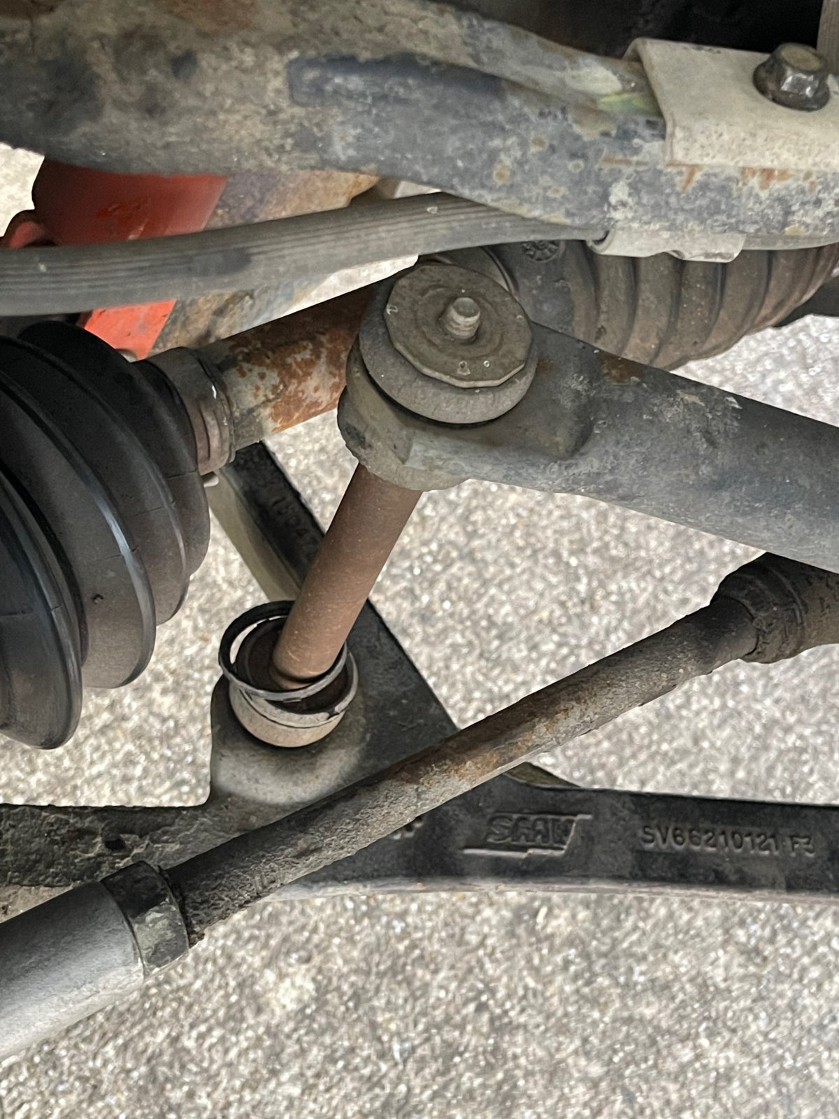

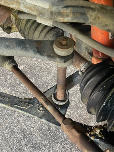

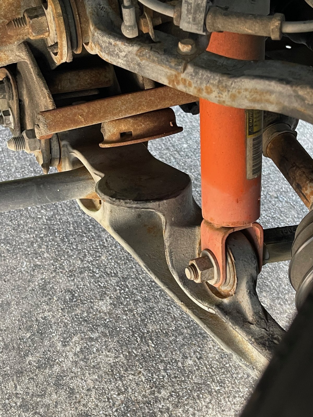

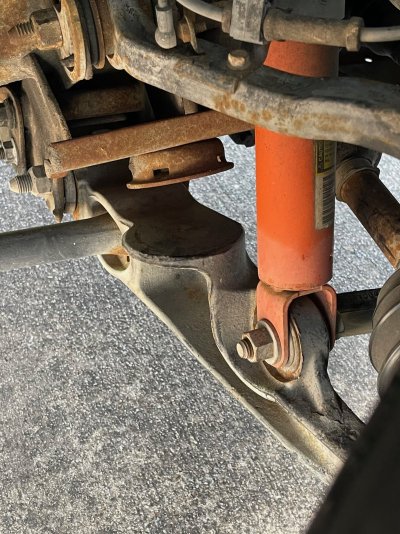

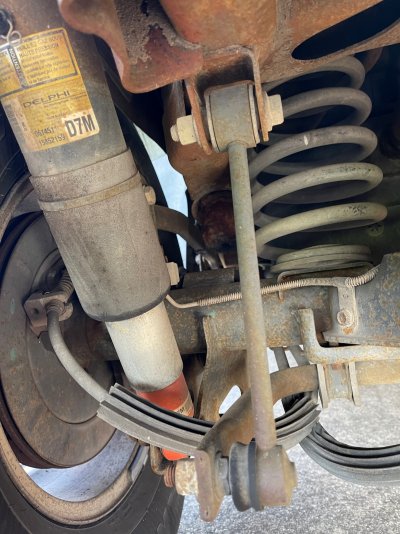

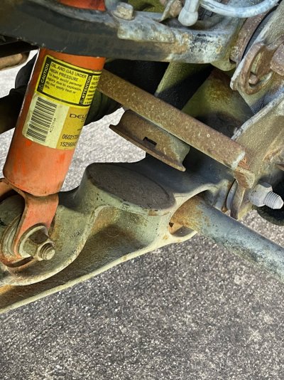

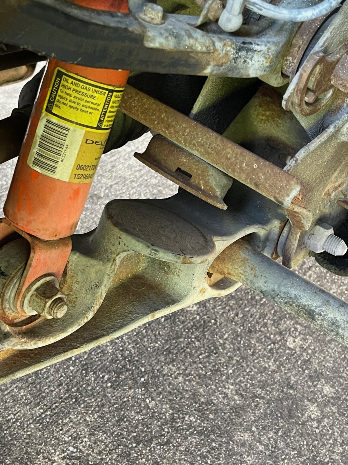

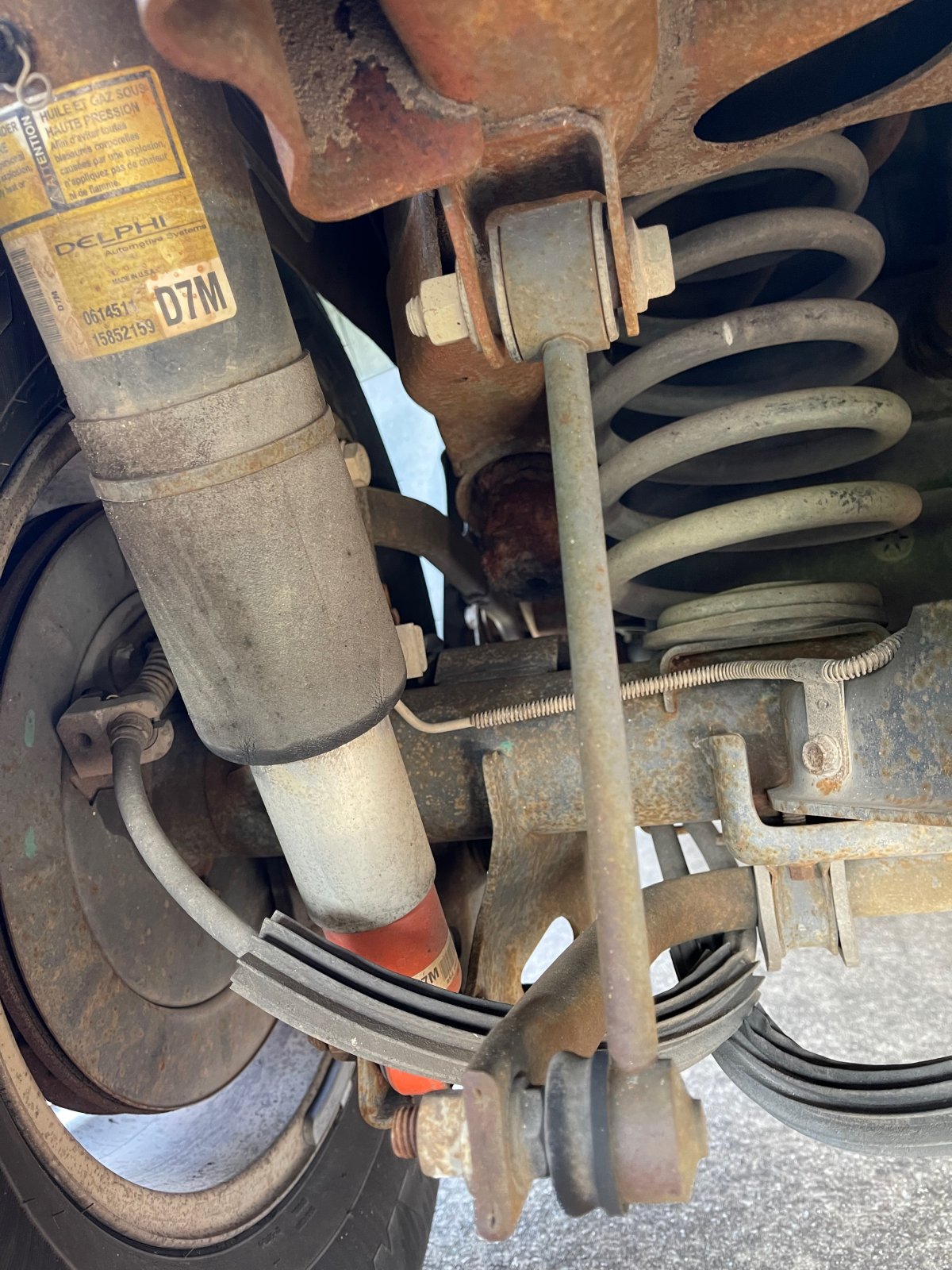

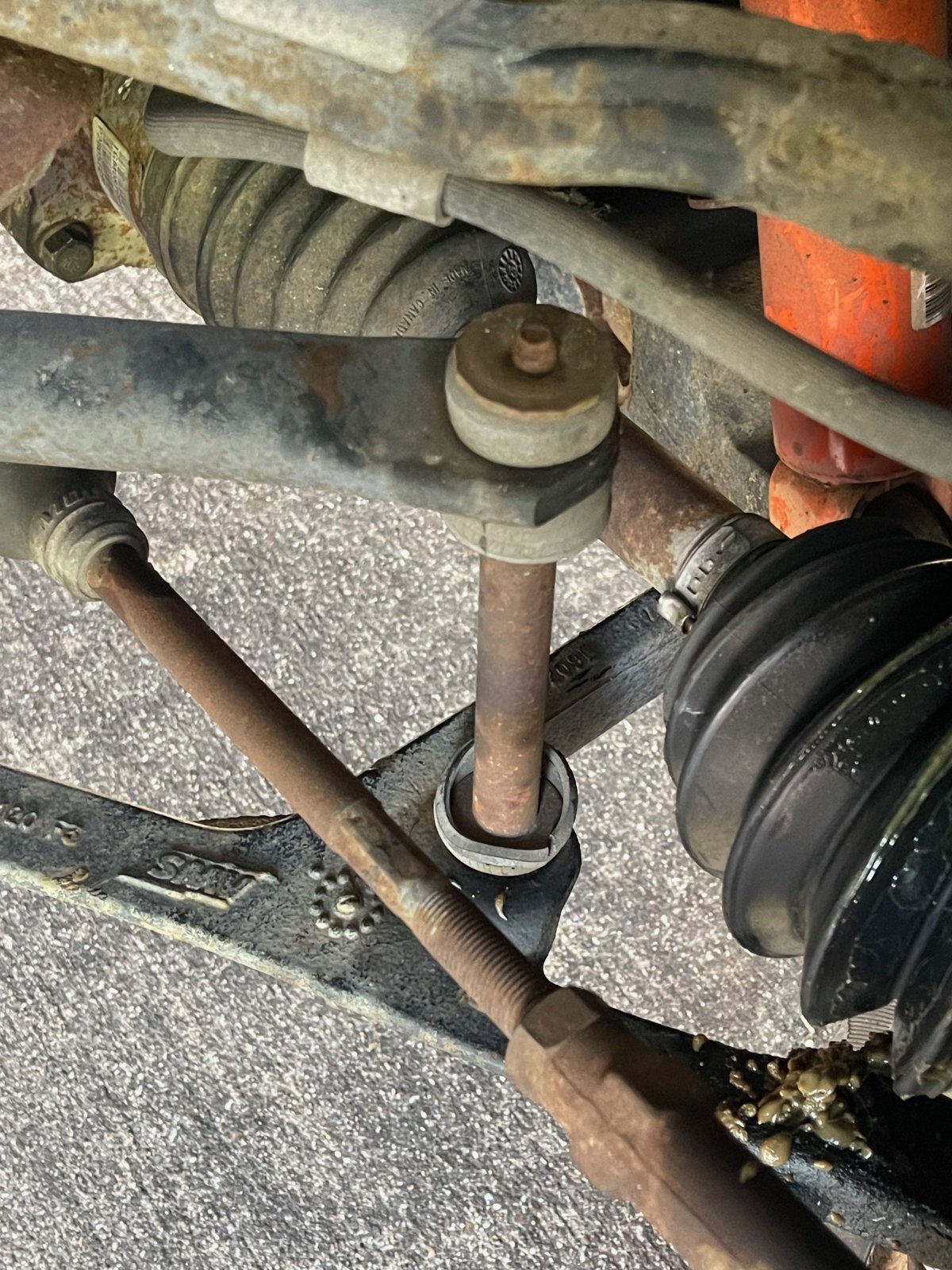

So, I have attached four photos - two of the left-side front end and two of the right-side. It appears that I have no jounce stops at all on either side but I will let you look at the photos to verify. I have also taken photos of the sway bar links and bushing, and the control bar arm area of each side.
Please look at those photos and see if anything looks out of order. I am done with this mechanical shop regarding this issue as they seem to be incompetent in that area. So, please look over these photos and let me know your suggestions/recommendations.
Since these are all original parts with 254,000 miles on them I'm guessing that it might be a good idea to just go ahead and replace the sway bar links and the sway bar bushings, along with the missing jounce stops. I haven't even looked at the rear end yet but I would also guess that it makes sense to replace those same items back there? Are there jounce stops in the rear, or are they just up front?
Also, what type of shop should I look to do this kind of work, and are the jounce stops something that I could do myself, or do you need specialized tools to install them. I am guessing that most of my side-to-side wobble is caused by these not being there and I would like to get those quickly fixed.

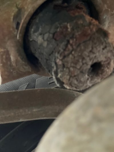

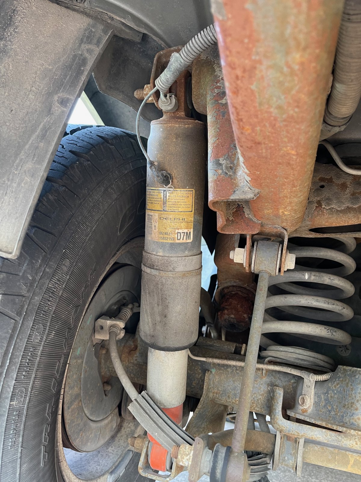

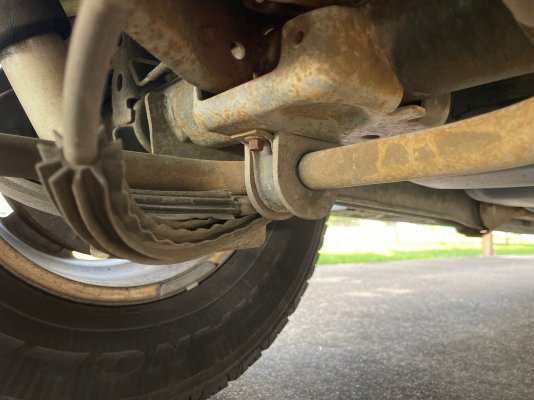

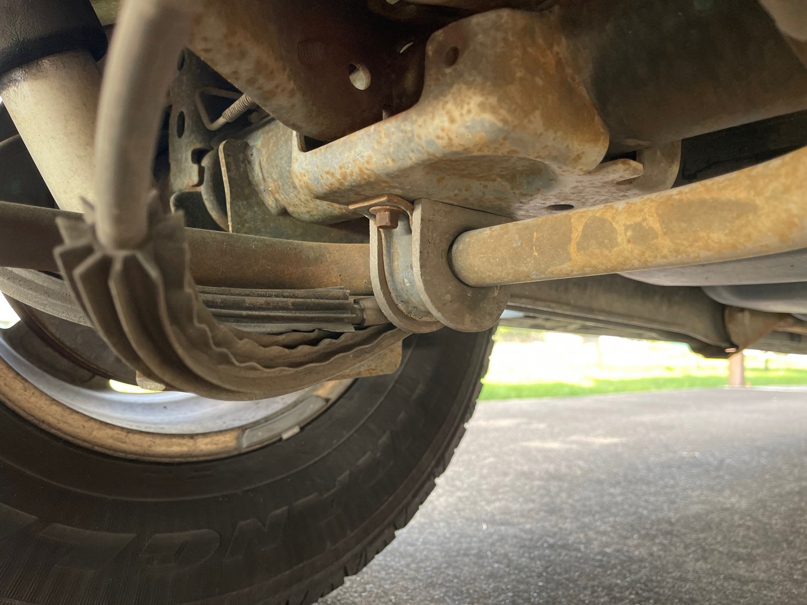

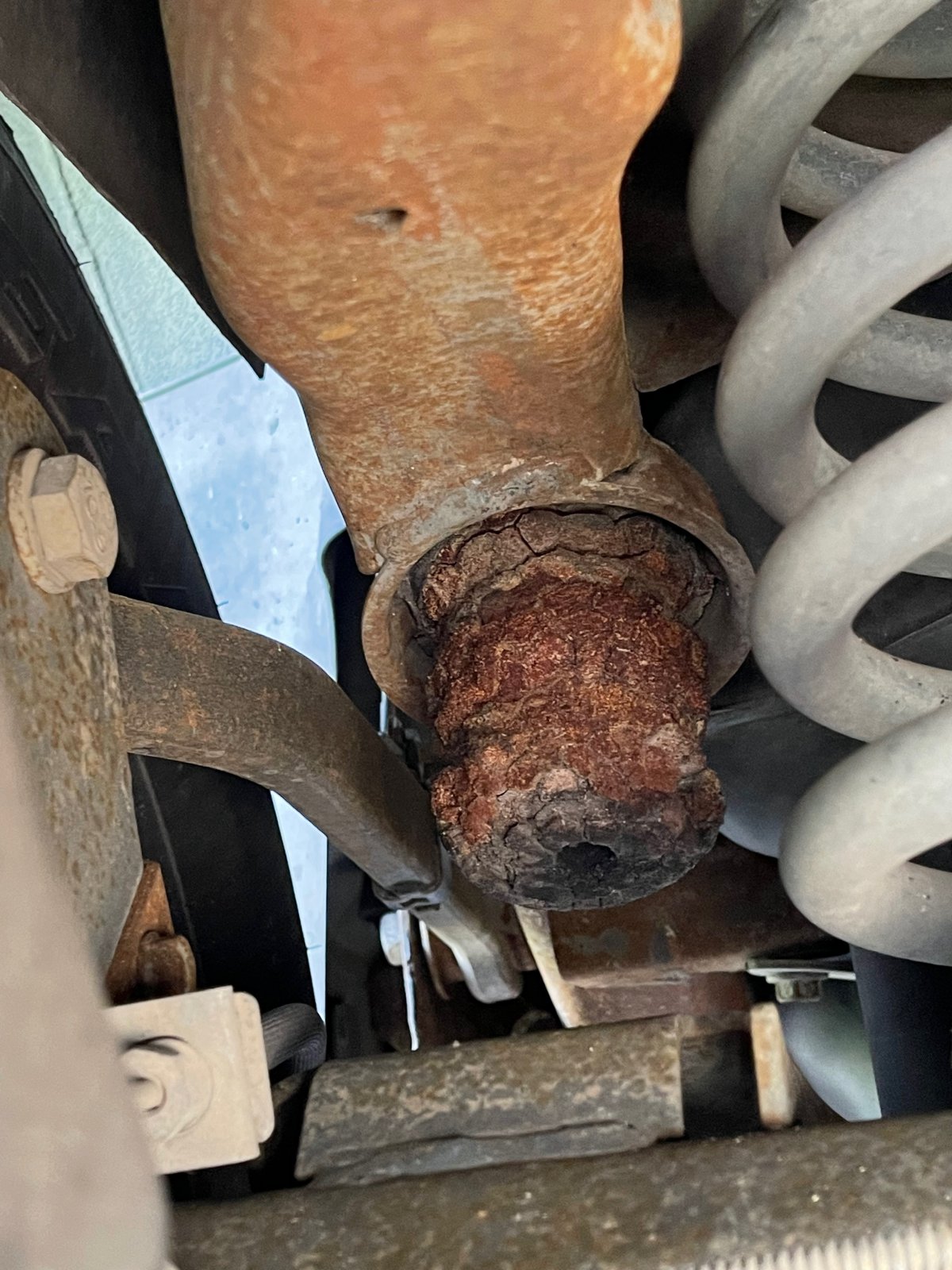

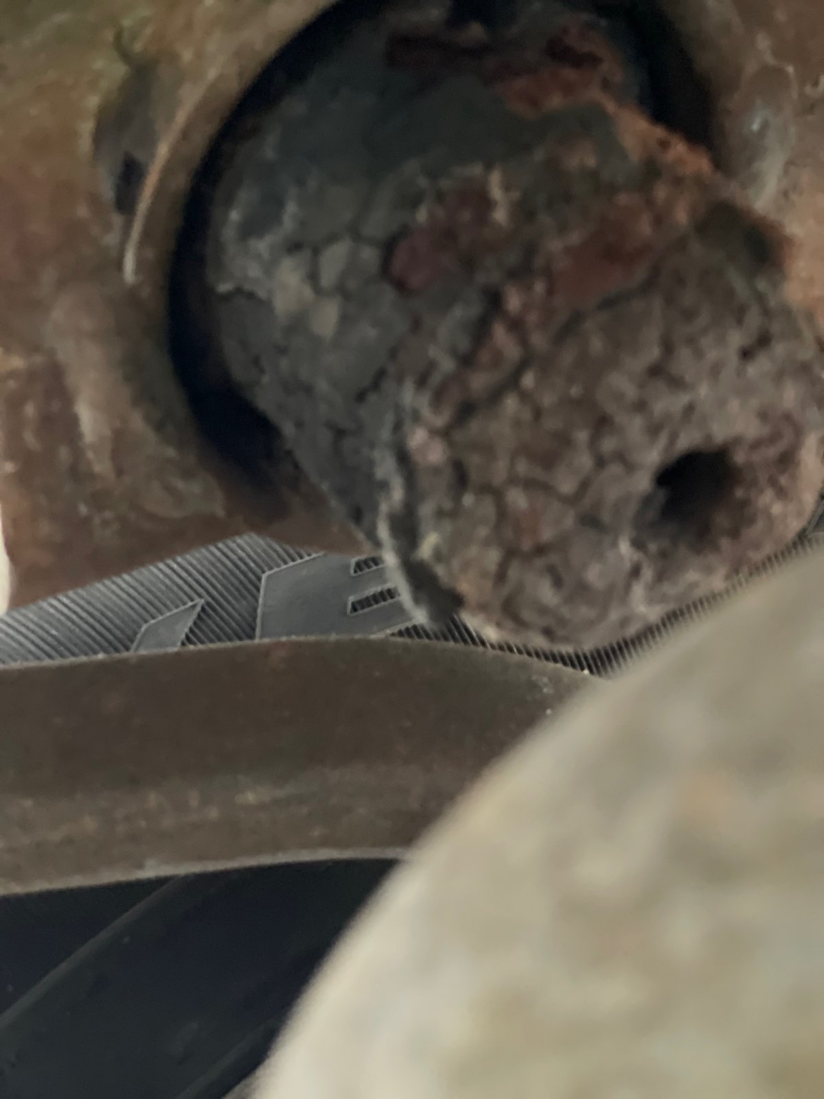

Photos of the rear suspension area. It appears that the two jounce stops are there but probably not in the best condition. It appears that I might be able to install the front ones fairly easily if I knew where to properly place a floor jack to create the needed space to slide the new ones in.

In addition to the control arm bushing inspection that @exp500 suggested:
The rear bump stops are just that; they protect from the frame bottoming out, and contact only when the truck is heavily loaded or goes over severe bumps. Your air shocks probably prevent that for the most part. But it wouldn't hurt to have good ones in place.
The missing front ones are easy enough and should be replaced; they're an integral part of the suspension and will help stablilize the ride. They must contact the lower control arm at ride height to work. See the video below. Just need a jack to raise the vehicle and a jackstand on the frame. Remove the wheel and install the new jounce stops. You can do one at a time.
You might start with that and see if it cures or at least helps the problem. It wouldn't hurt to replace those front sway bar links -- they look a bit weak -- but you'll need to have both front tires off the ground to do it (front suspension unloaded, both sides at the same time).
45,016
+1 to what Sam listed.
Jounce stops work in conjunction with the springs. Without them, it's like having weaker springs. Insufficient spring strength for the amount of weight is essentially an overload. So, your front end will act overloaded, and that sounds exactly like what it's doing. Those similar-looking ones in the rear are bump stops, there to give the axle something soft to collide with instead of the frame.
Those are factory style sway bar end links, if not the original ones from the factory.. Regardless, they appear cruddy. Pretty much any aftermarket one is gonna be superior and with firmer material, like polyurethane or Delrin or, more likely, thermoplastic. Moog has nice ones. Don't forget the sway bar bushings on the frame. I'm sure the rear bushings and end links are just as cruddy. The good news is that all of this is cheap and an easy bolt-on.

UPDATE - I replaced the two missing front Jounce Stops and that seems to have fixed the wobble problem. I am sure that when I replace the two worn rear Jounce Stops that will improve things even more. Question, do coil springs wear out and need replacing like shocks?

As Steve said, the rears are just bump stops. Nothing rides on them like the jounce stops in the front. You really should replace them sway bar bushings and end links to further improve the handling and reduce the load on the rest of the front end components.

Your problem is 100% sure the front Jouncestops that were missing.
