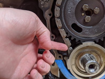

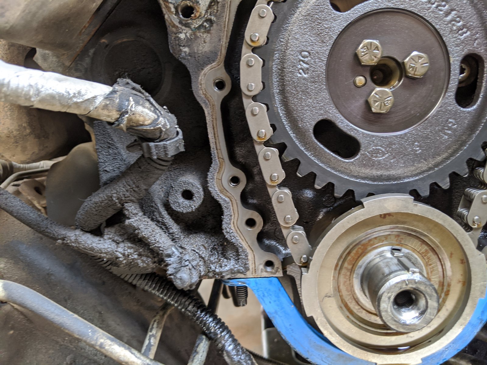

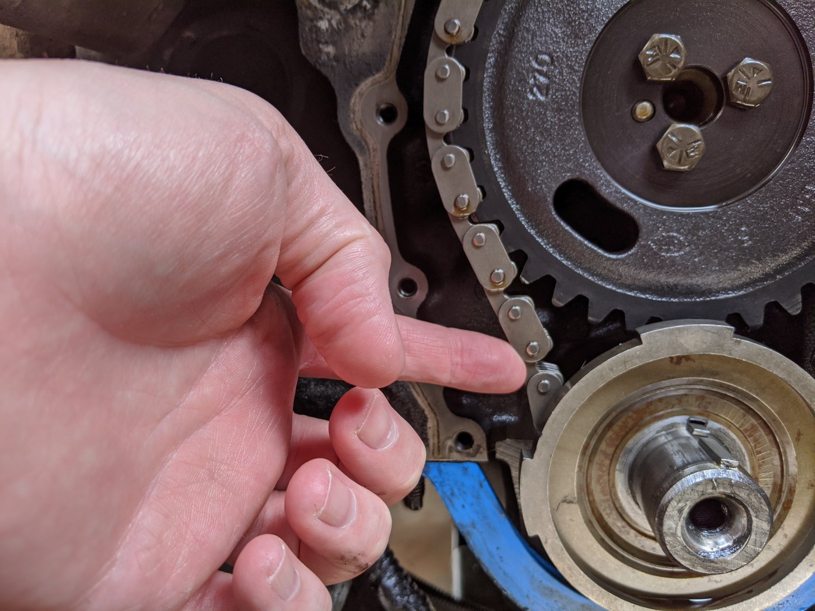

How much slack is acceptable in the timing chain. This seems a little sloppy to me. But I'm not sure waht is normal.
2000 Limited, 205K miles. Was going to try and upload a video, but it won't let me. Maybe there is an amount of slack that is acceptable. I seem to have about half an inch or so. I didn't fully measure it.

Post a pic, not a video and show the deflection in a pic or two. Half an inch is a lot, IMO. But is that the actual deflection, say right in the middle of the looseness and the outer edge actually moves over 1/2" outside edge to outside edge? If it was mine I would put one on and the gears, if I had that far torn down.

I was leaning towards replacing. Just didn't know what is normal. So didn't wasn't to drop the coin on a new set only to find out it's normal.

IMO, that is enough to replace it. I would do it but it is your money and I like to spend other people's money. Hell, lots of us do! Post pics of the slack in the new chain and gears. What brand gears and chain are you going to get? That is the 5.7 engine isn't it? I don't see a damper.
