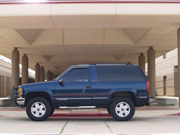

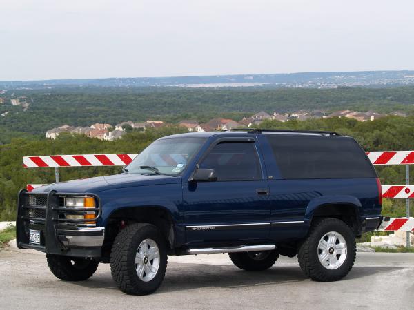

Here's what the 2-3" lift with torsion bars cranked looks like:
2 1/2" box kit for the front from SkyJacker
4" lift SkyJacker Soft Ride springs in the rear
(with 2" drop shackles - don't ask)
Torsion bars cranked to level it out
Fenders sit just shy of 40" at center of wheel
275/70/18 Goodyear Wrangler DuraTrac

I actually like the look of that one. just a little higher from what I have now. I dont want to go bigger bc I dont have the money to buy larger tires, and I just got the ones I have now

Thats a great lookin ride hapyspaz!
