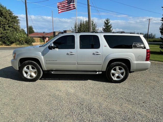

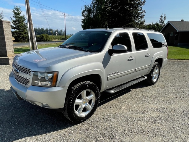

Before recently buying a '21 yukon we drove a 2011 z71 suburban for 8 years or so with a 2.5" ccm leveling kit and 33" duratracs and loved it. Sat perfectly level and rode great. I believe it was a 2.5" front only top mount spacer, nothing in the rear

I'm sorry but I don't recall the exact tire size. I sold that rig a couple months back and gave the new owner all the service history paperwork with it so no way to know for sure. I sold the stock z71 wheels and was running 20s from a LTZ and pretty sure I told the tire store to fit the biggest size tire we could fit without massive rubbing. I did have to "modify" the front bumper cause they rubbed a little bit when turning. Basically I just removed the plastic support piece that the inner fender liner attaches to down by the bottom of the bumper and zip tied the fender liner back a couple inches so it wouldn't rub. One of the supports was already broken so wasn't doing anything anyways

What was the width of the tires? I am wanting to run 33’s but haven’t found anyone doing that was just a level. I don’t want to trim and don’t want to rub.
I appreciate your response!
My wife saw our old ride parked this morning so I had her snap a pic of the tires...hope this helps.
275/60r20 so 33" x 11"
