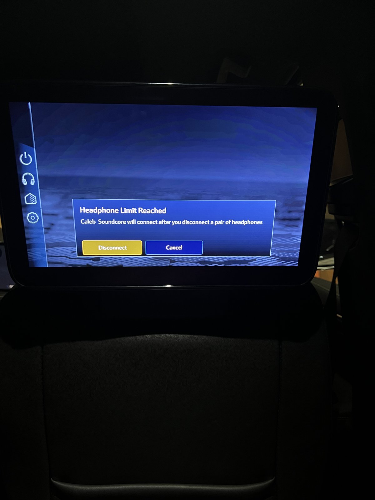

I’m trying to use 2 Bluetooth headsets per screen in a 2025 Suburban. I have paired the max of 4 and I’m trying to have 2 active sets per screen. The manual that came with the headphones says it’s possible. See photo. Once I have one headset connect and I try to connect a second pair it says I reached my limit and have to disconnect a pair to use it. Any thoughts? Tried chatting with Customer Service but they could just point me to page 148 of the Owner Manual which doesn’t address any details. It looks like earlier Tahoes can do this from 2021 threads. Curious if anyone has had success in the 2025? Thanks.
I haven’t had any success with this either. I’ve tried with the headsets that come with it and also different sets. Nothing works.

This is crazy. This absolutely worked on the 2024 and below. They even sell extra headsets for a reason.
What the heck did they break?
I am having the same issue with my 25 Yukon. Took it to service and logged a case with GM. Have you figured out a way to make these work?

Has anyone gotten any resolution on this? Any response from GM?
It's crazy that they advertise that you can have 2 headsets per screen. It's documented in the manual, it worked on 2021-2024, and all of sudden it broken.
How did they not test this? How does this company just not give a shit about quality testing their vehicles.
Sadly, I would just use tablets for my 4 kids, but they force this stupid rear seat entertainment on you when you buy a Ultimate. I'd gladly save the $3k and use tablet holder and 5g hotspot. Trash.

2025 only allows one set per screen now.
But the published the manual insert that says 2 per screen.
Even my dealer verified it was listed as 2 per screen.
This has to be a software glitch of some sort.
