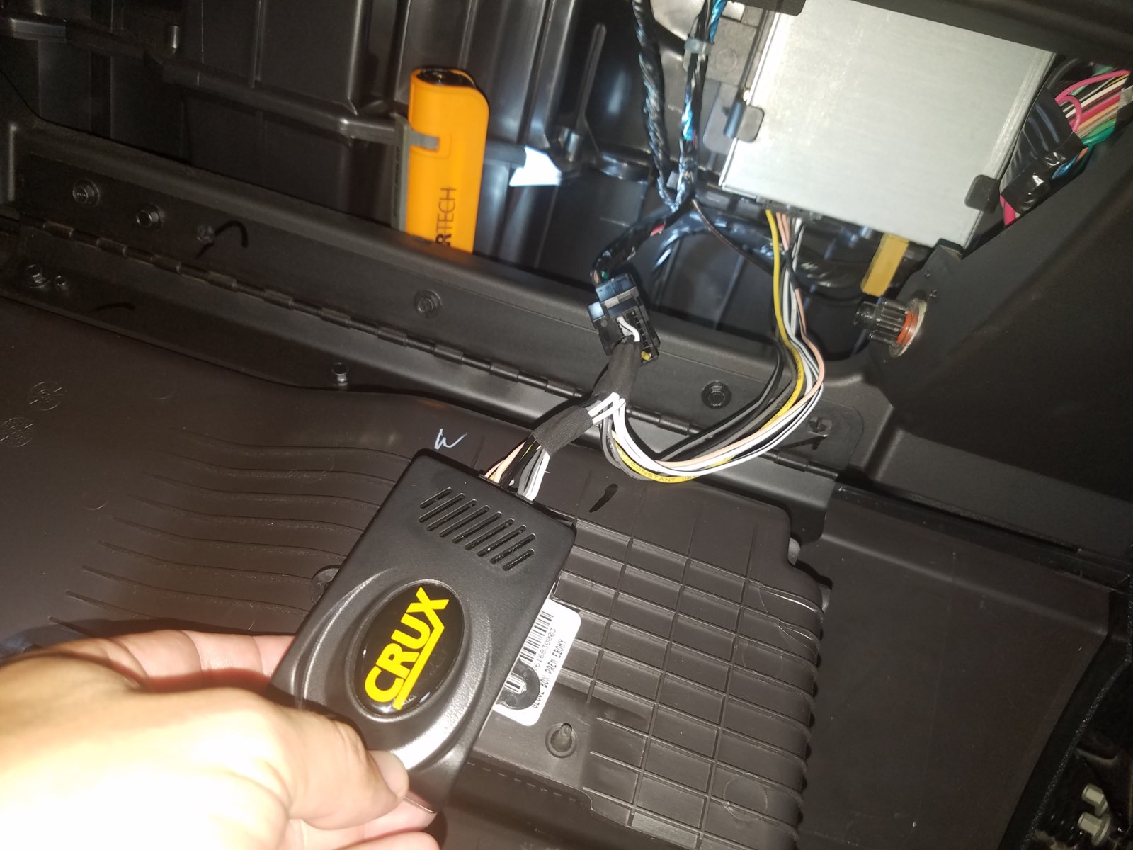

I ordered it yesterday afternoon and it was here at 9am today. Better than Amazon prime. I installed it in under 20 minutes. The installation process involved opening the glove compartment and pressing the release so that it drops down. Then unplugging the current XM plug from the bottom of the module :

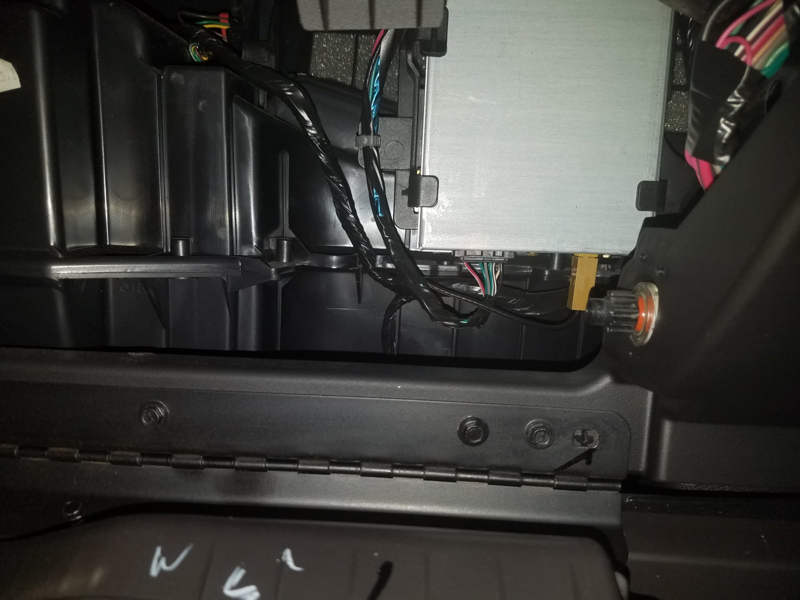

That plug is then installed in the wiring harness and routes in the new box like this :
I then put the box in there and sealed it all back up. It's currently in there loose because I want to test it out before finalizing the location. I was expecting to have to remove the stereo so this was great to see that it's that easy.
When I turned the car on it was already on XM so the pairing screen came up immediately and recognized my phone as soon as I hit pair on the bluetooth settings. It was the fastest and easiest install of anything beyond a pair of fuzzy dice.
All of that was terrific and it started playing what I was last listening to immediately. It made me incredibly happy until I realized that it was only playing through the front speakers. Going back through some other posts on here and others it looks like that's the only way that it'll play and is somewhat disappointing for music.
