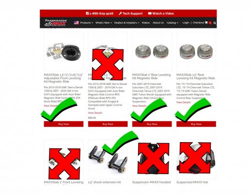

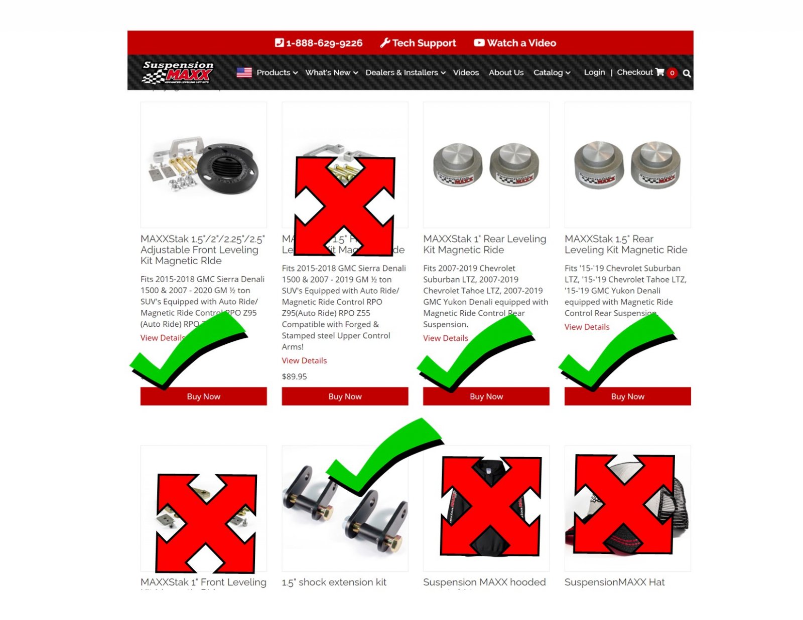

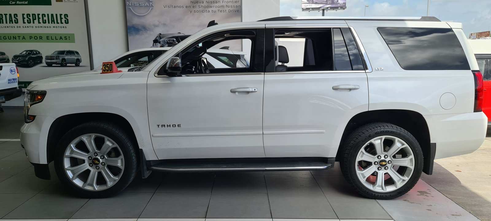

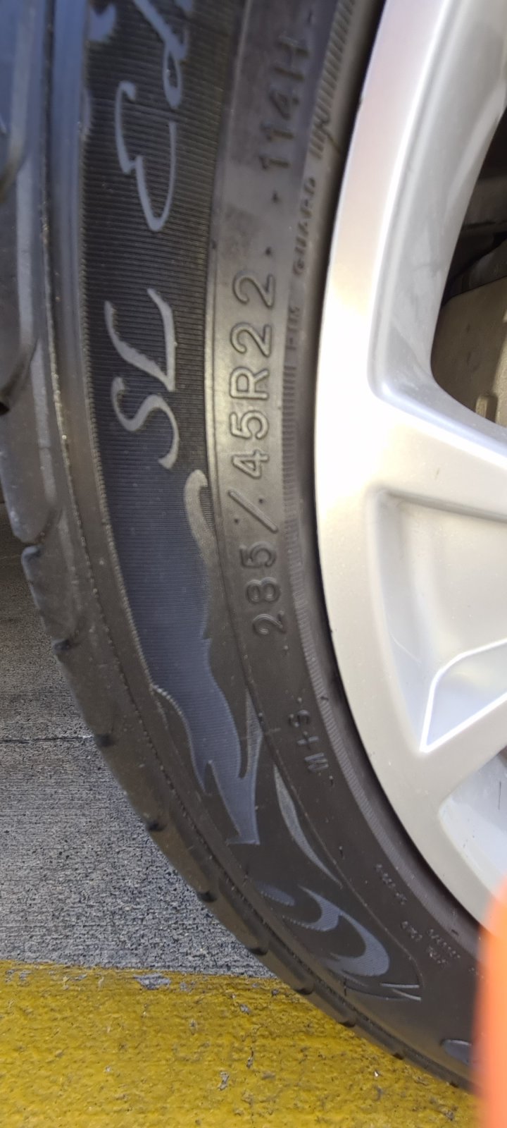

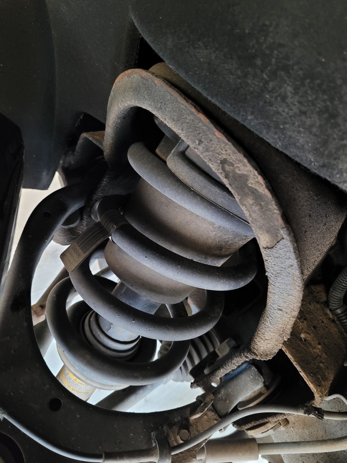

Hi to all, i'm buying a 2016 Tahoe LTZ and i want to install the Suspension Maxx Leveling Kit for the Magnaride. The vehicle has 22 rims and 285/45R22 tires on it. I read a lot of forums and found people suggesting 2" in front or 2.5"/1.5" rear. I bought the Complete suspension Maxx kit, the one for the front with multiple levels and the 2 options for the rear and the chock extension. I was wondering the combination to gain the maximum ground clearance that i can safely get with those kits and keeping the vehicle looking like factory or level ?
Can somebody light me in this matter?
Thanks

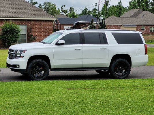

This is 2.5 / 1.5 with bilstein 5100 rear and stock front struts, tire is a 285/50/22 toyo at3
Has a perfect height, maybe 1/4 higher in rear and looks perfect in person.
