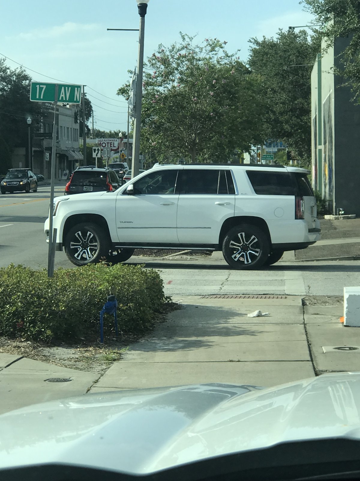

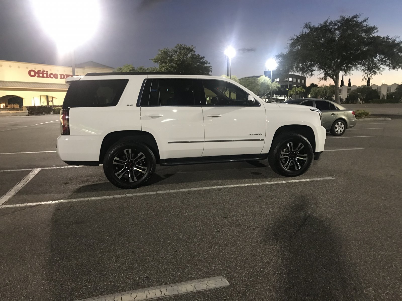

What did you end up doing? I just installed a motofab 2”, which looks level somethings but when driving it looks nose high. Was considering the 1/2” rear spacers.
9C236C92-0DCD-4206-9E9B-CFCCF4012981.jpeg 4FA3623E-E35A-4576-BBD3-8473F4DC0740.jpeg

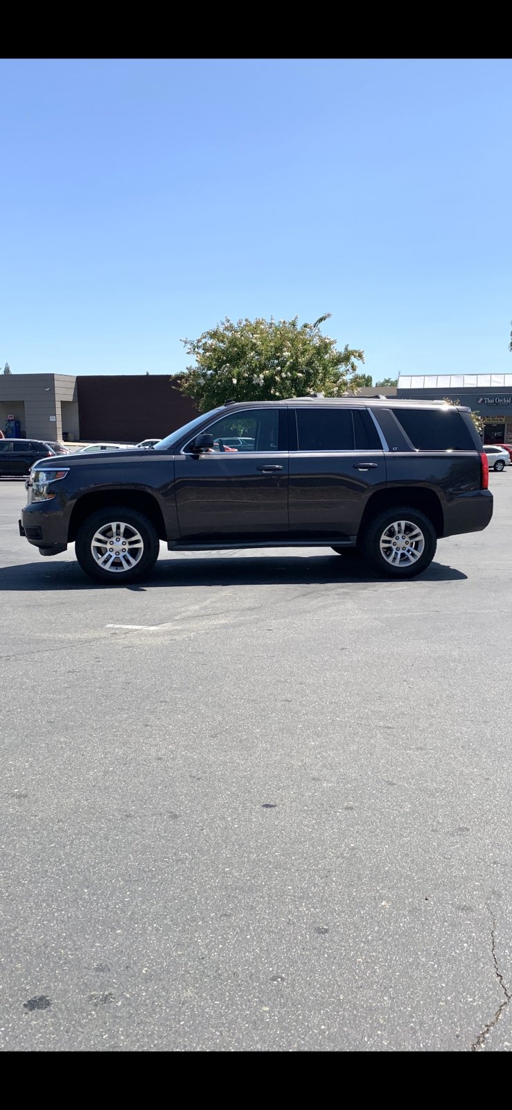

I put the front Bilsteins on the top setting and it was a little nose high. Put 1 inch spacers in the back with new insulators that ended up giving me an inch and a half in the rear. Now it’s an inch taller in the back.
