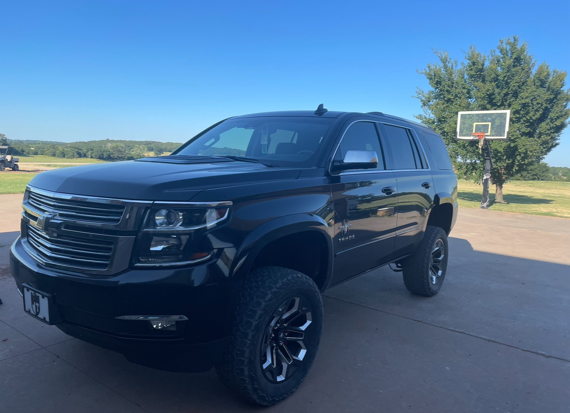

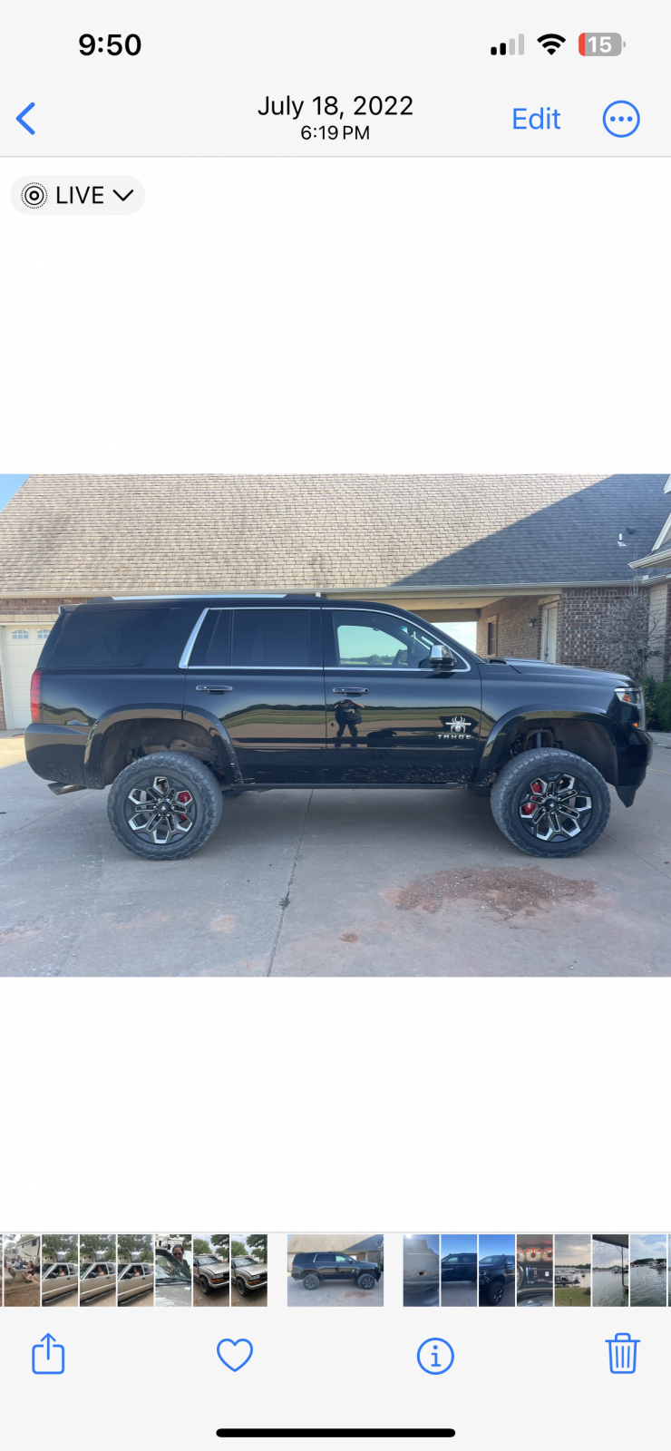

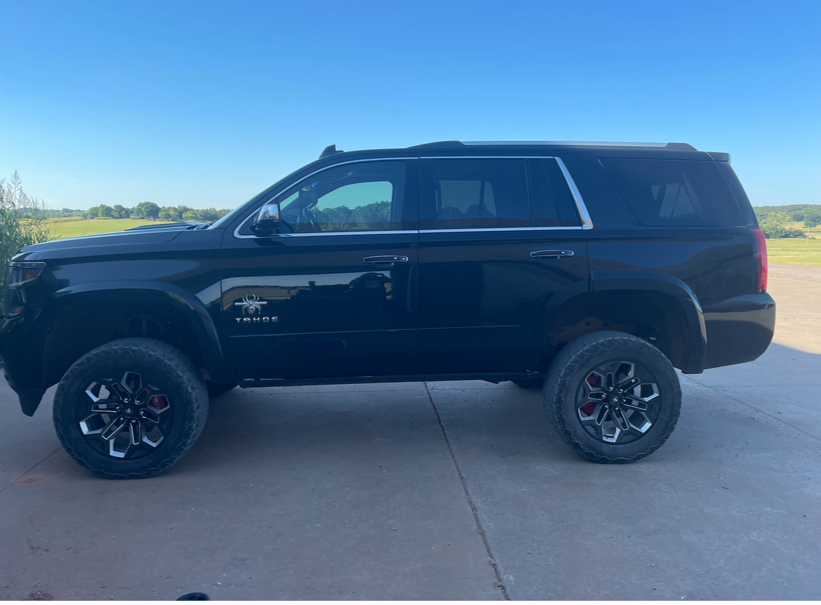

Welcome to the Forum! First off, we need to see pics of the truck, I've never seen a BW Tahoe!
