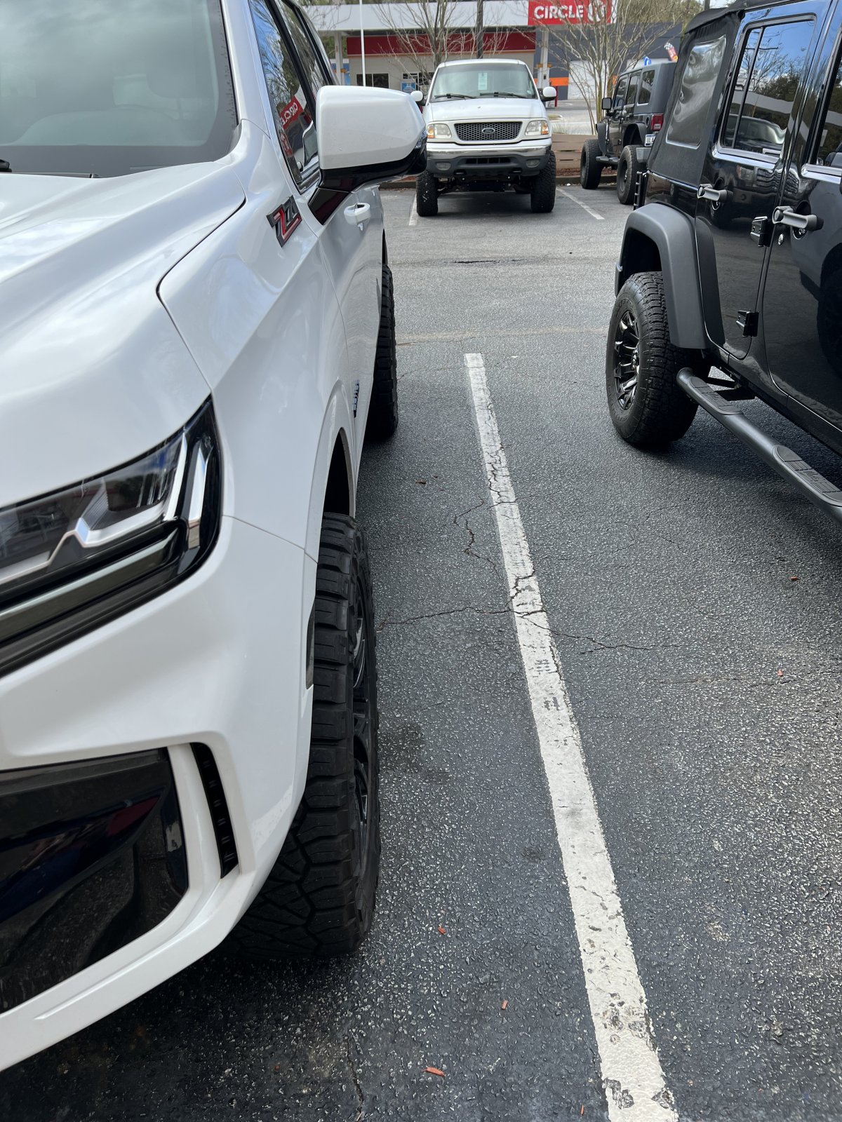

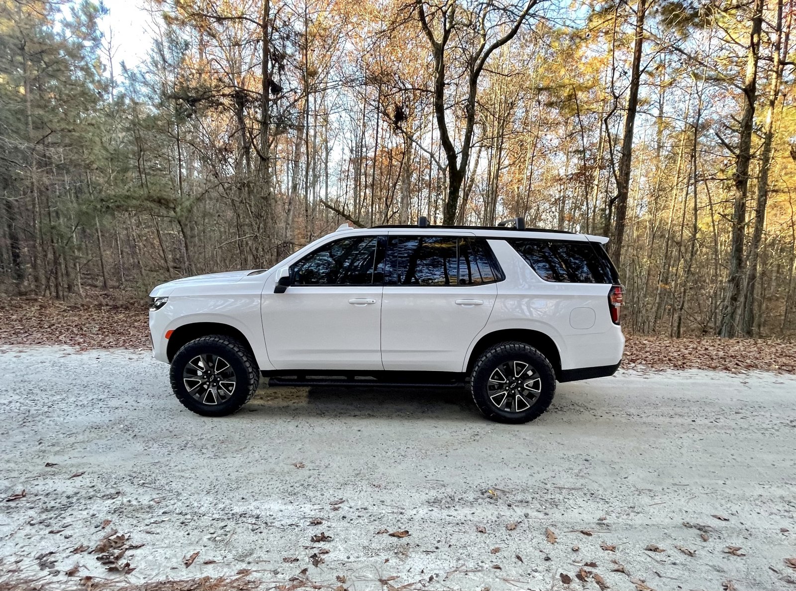

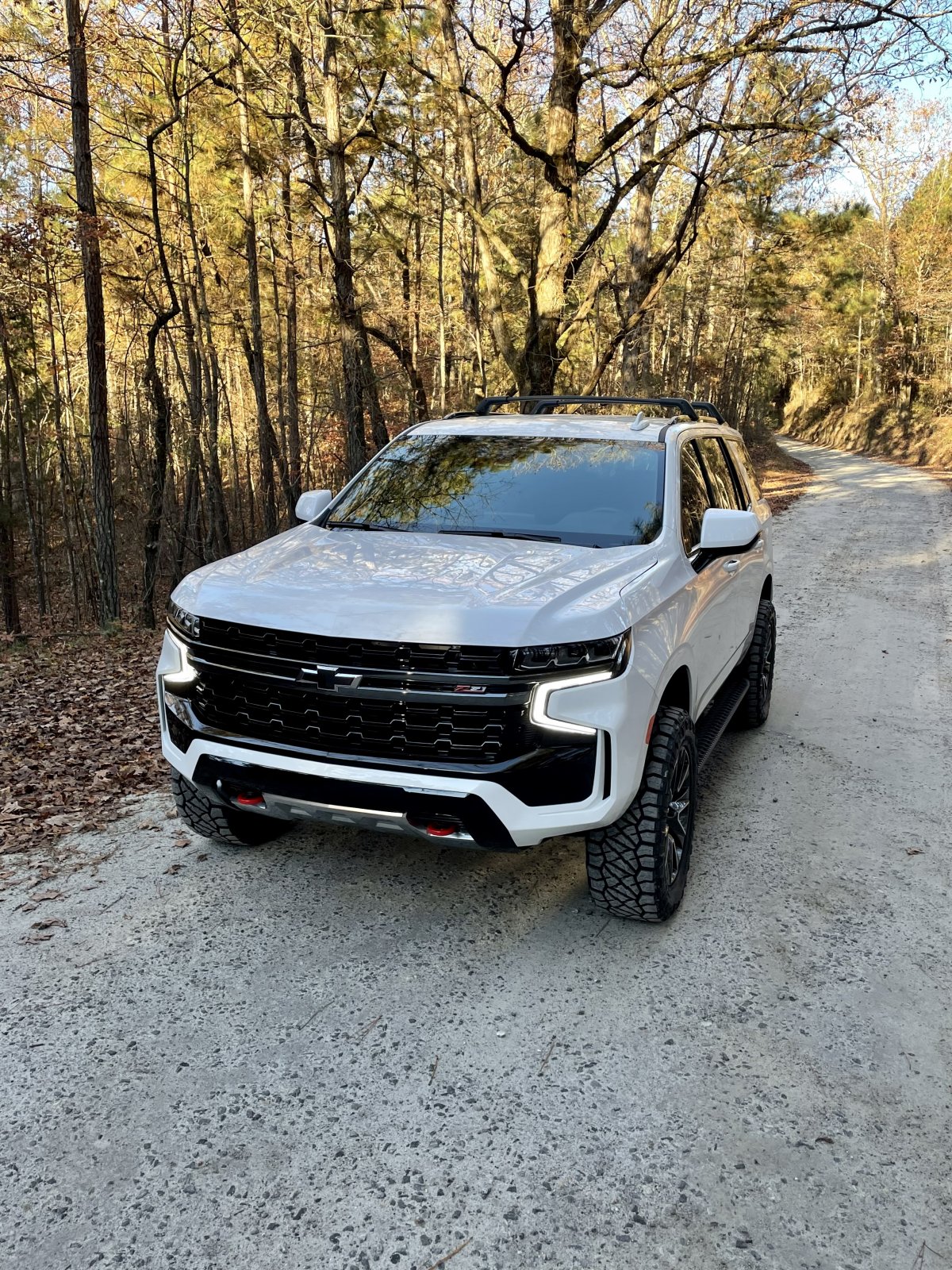

You may be fine with the 2”. Here is a z71 with the stock wheels with 285/60R/20 Nitto Ridge Grapplers, 2” RC lift, and 2.25” BORA wheel spacers. You would probably have a better chance clearing them with out spacers (or smaller ones if needed).

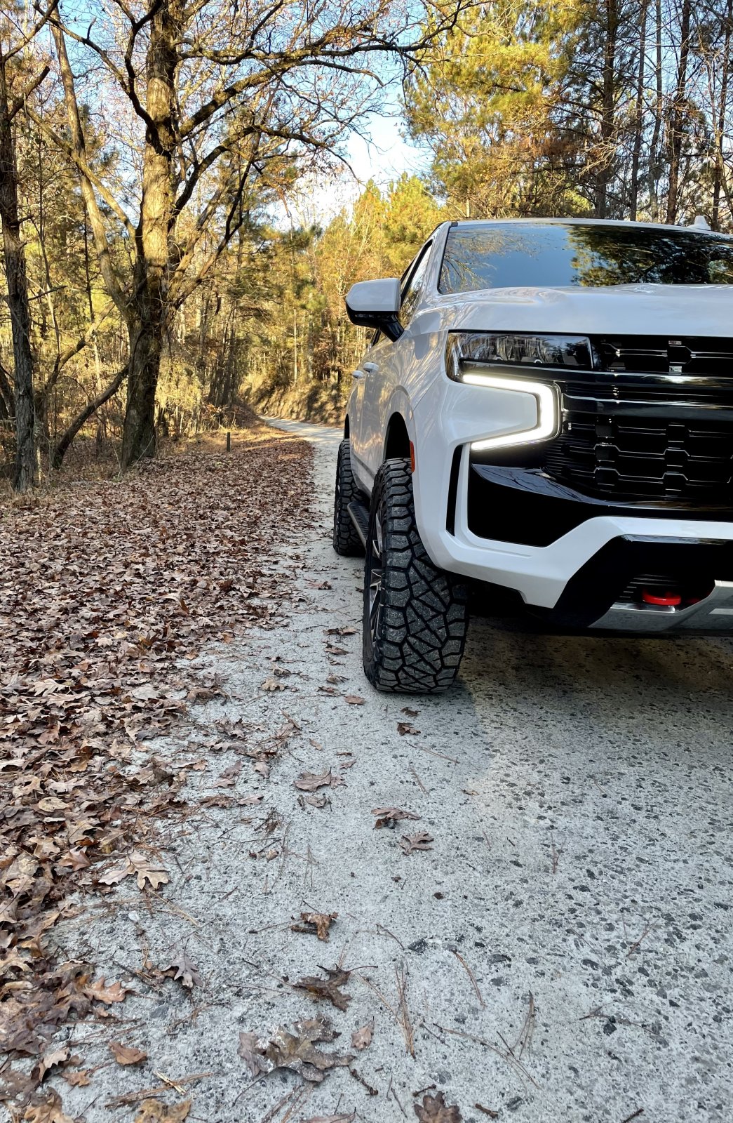

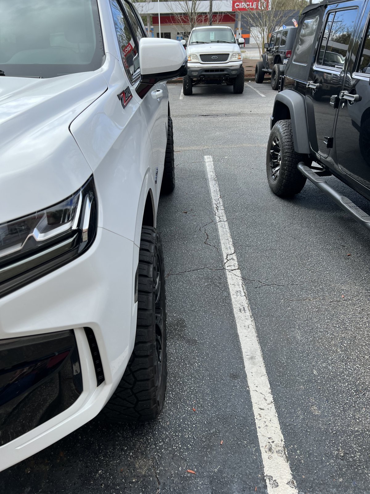

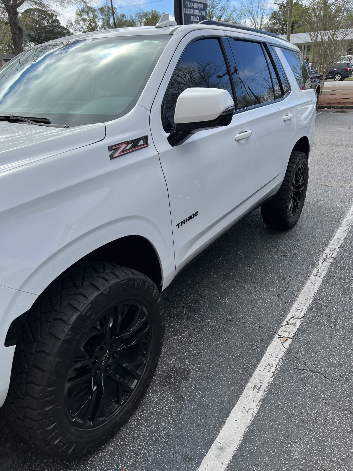

2" RC Level front/back. 285/55r22 with 1.25" bora spacers. Did require a bit of trimming but nothing crazy. This tire is 34.5" tall vs 34".

Spacers make it worse for rubbing. Had them installed at the same time as larger tire but prett sure would’ve rubbed anyway due to tire size
