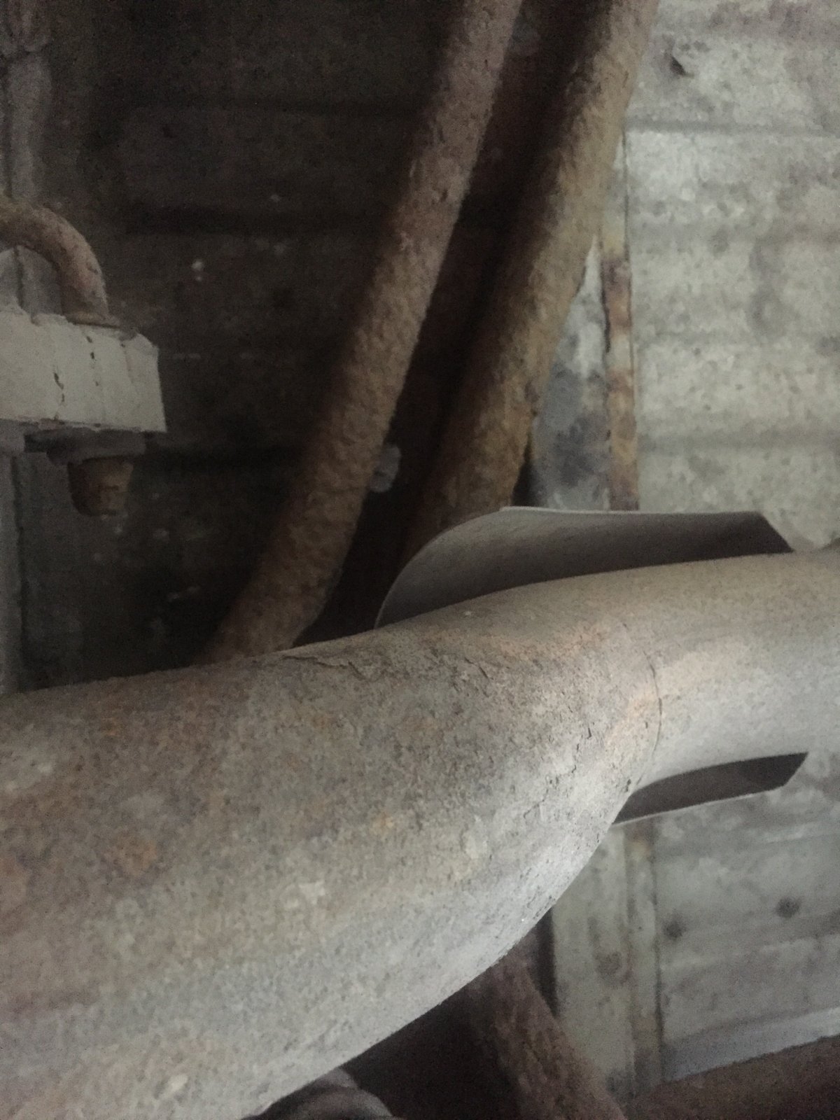

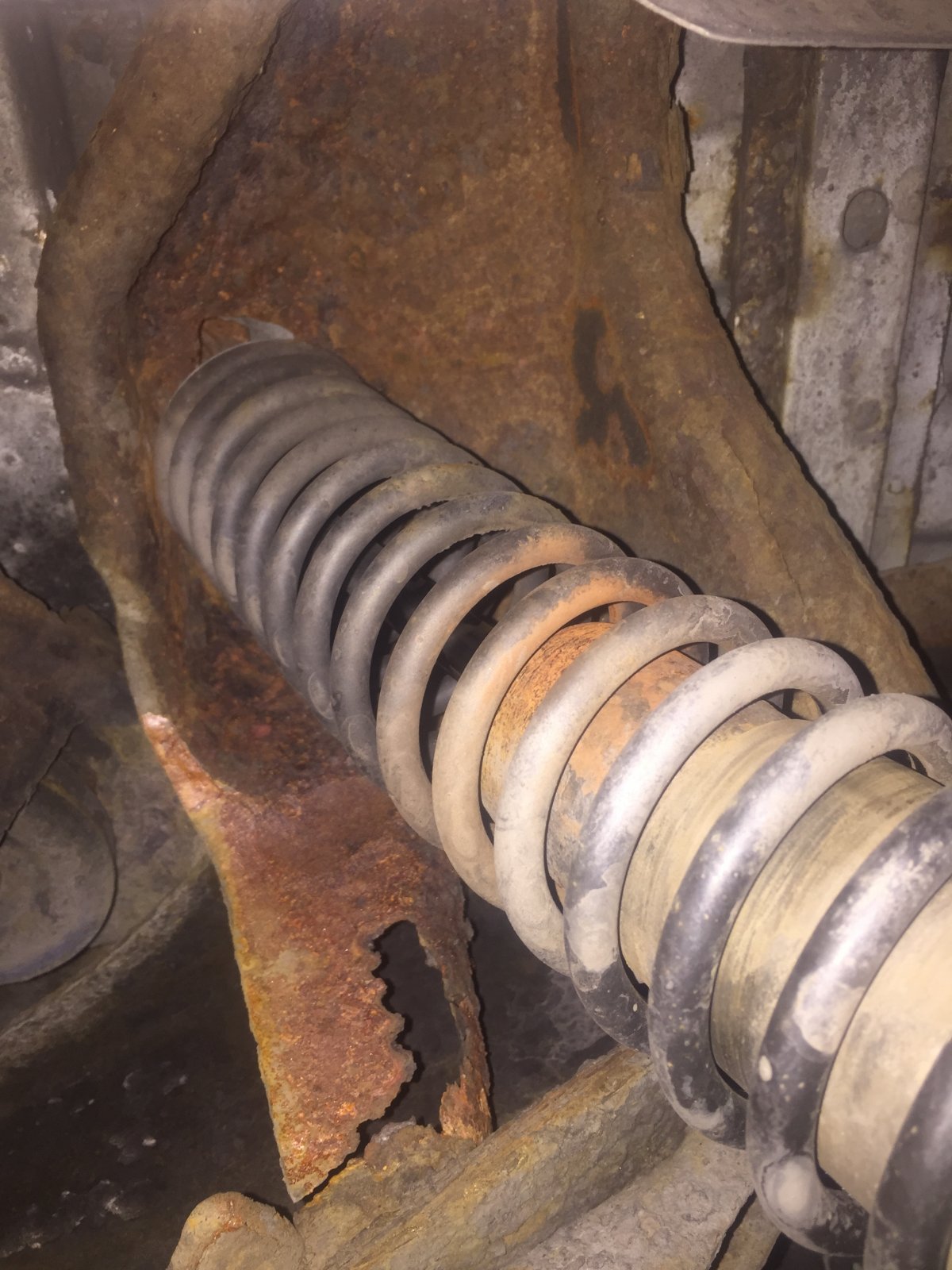

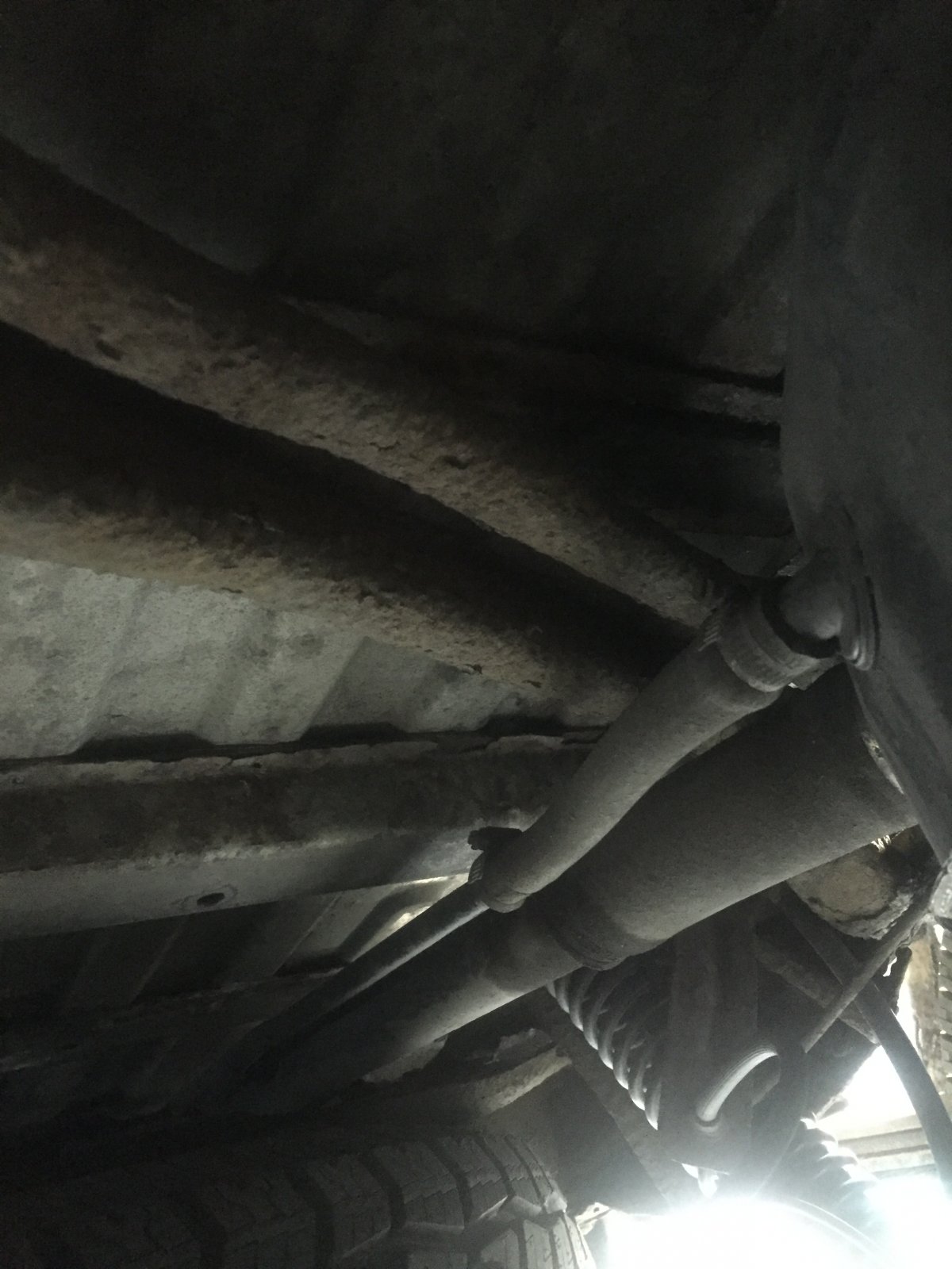

Unfortunatley no. The mount is riveted to the frame on the pass side , but also extends over to the drivers side and mount there also. I've looked at these mounts and figured i could just cut the old one out and "make" these work , but wanted to see if anyone tried this before.
R
Rocket61
Feb 19, 2023
Sorry for the quality as I'm home and laying in the driveway for these pics.

Thats a southern scrapyard part. Getting one may be tough if you are in salty north. I advise you to email and call a few yards that have the same truck and include all the information you can (pics part numbers ect) to get a price quote. Many yards wont deal with the riveted parts, but some might chop saw the frame on one going to crusher.
Also try LMC truck.com
