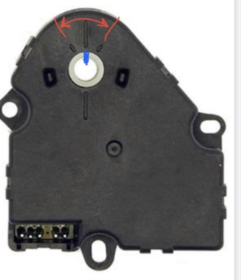

The floor-defrost is controlled by the actuator near the gas pedal. There’s a notched silver dial on it. Watch that dial as the panel is switched from defrost to floor to dash. The notch should roughly align with some marks on the actuator and rotate from about 11 to 1 o’clock.
Compare the linkage to the photo below.
If that actuator doesn’t move, pull the connector on the actuator. There are three wires - one for ground, one for battery voltage and the third is a signal. With a multimeter, check for 12V on battery and then watch the voltage on the signal wire as the panel knob is turned. See what you’re getting. If it doesn’t change voltage, then the panel isn’t sending a signal.
The heater door actuator functions the same and is behind the ashtray. Watch the dial on it and see what it does.
To test the heater water valve, there is a metal rod plunger on the end of it. Push it up and down to see if it moves. Without vacuum (a/c panel temperature is not on MAX) the valve will be open. Unplugging the vacuum line from the bottom is another quick check. If you have vacuum on it with the temperature dial not on Max, then the panel or the solenoid on the firewall is the issue.
