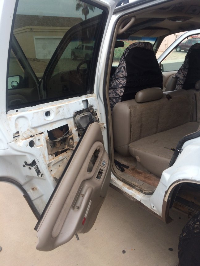

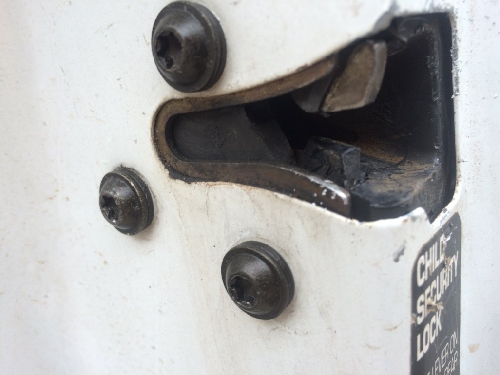

Grease didn't work. Plan B was invoked. At least it was a happy ending- well, kinda. $160 for the latch. The door is a bit dirty, but hey- we use it :)

Yeah= the 11 year old ninja-in-training crawled inside and kicked it till it popped open. It came to that.. the latch is hard to locate, but I found it for $140 - $20 to 2 day Fedex. Dealer wanted $250.
