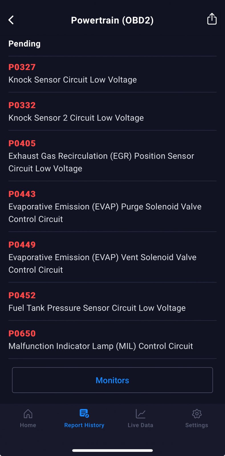

I picked up an OBD2 Scanner. I see my speed working so it must be my gauge cluster.
I’m having another issue that came up. When it’s been running for awhile it starts sputtering and has no power to accelerate. Any idea which code to start working on first?
I think you have some serious reading ahead. Some of your OBD codes are showing for a newer model -fuel tank pressure is one.
You maybe should contact whomever you can to verify computer part numbers and specific mods done to it/them. I would wait on changing any wiring until you verify what you have and your intended uses and knowledge of the systems. Eventually, you will be connecting a tuner to your computer to disable reporting on some and modifying functions on others.
A spreadsheet type of list from factory installed computer and currently installed would be 1st step for me. Post what you know that is verified, then it should be a system fix or a wire by wire fix. Good luck! We are here to help.
