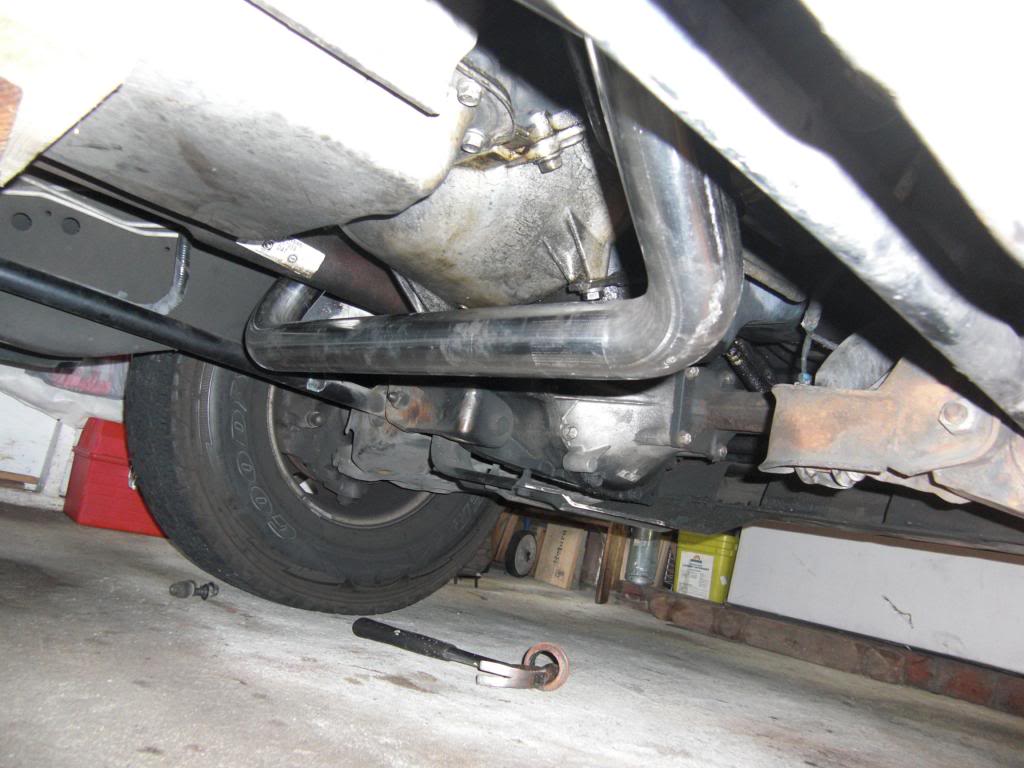

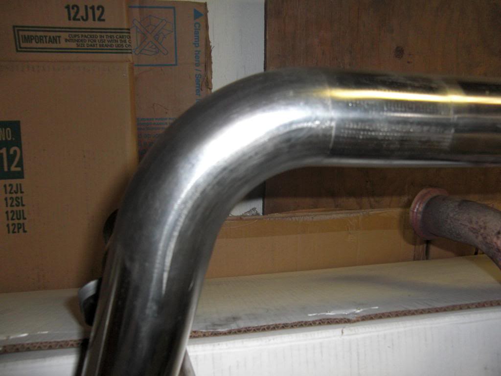

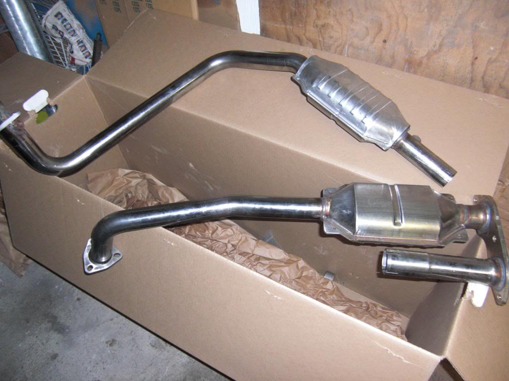

Here are some pics of the cats.
Just out of the box
Assembly comes in two pieces with all the gaskets and band clamp.
Old and new
As you can see, they're same dimension.
New head pipe, drivers side
Old head pipe, drivers side
Installed
Install was straight forward but was time consuming. There is a video in Magnaflow site on the install. If you have a sawz-all, use it as in the video. I loaned out mine and couldn't get it back in time for the install. Wound up dropping the trans crossmember.
Everything bolted right up from manifold to muffler flange at rear.
As for the muffler, I'm still running the stocker. I was also thinking to get the Gibson set up. Other option is Flowmaster but I'm not a big fan of Flowmaster. Let us know how you like the Gibson when you get it.
Choice is limited for us 2 door guys.
As sunlit mentioned above, same part. Only us Califronians get to pay 300 more bucks for the "heavy metals" in the cats....ahhh the cost of living in CA.
If you need more pics, let me know.
Oh, BTW, these things are soooo worth the money and effort to install.

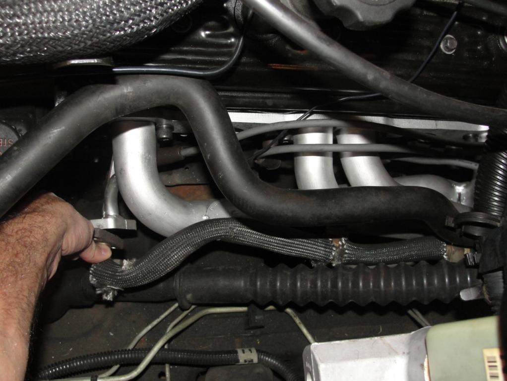

Well I have the magnaflow and the gibson cat back. But I started up top with my 1.52 roller rockers and some used JBA shorties that I bought off c/l. I ran into one difficulty and google no es mi amigo on this one. The drivers side egr pipe doesn't fit into the header; wondering how others solved. Not sure I can just bend the pipe (I'm afraid it will crack). If you look at the pic the problem is the pipe curves into the first tube. Thoughts?
Thx!
