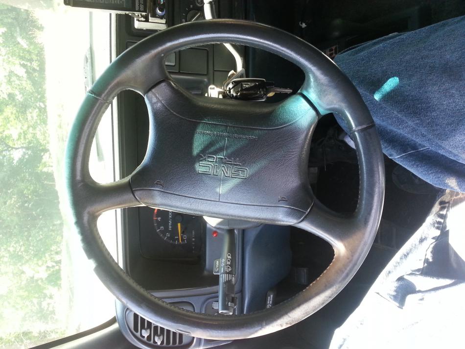

Pull it off and re align it. just be sure something is not bent out of hell first. Can you post a pic please first with the wheels pointed straight. Forward.

@sunlight here is pic of my steering wheel

Are you sure there was not a misalignment of the rest of steering system and with the wheel in that position is the pit-man arm pointing straight ahead or off to an angle?
