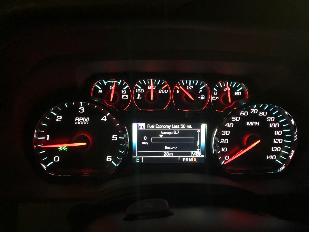

I went to check 2020 deals last night and had a chance to test drive 2020 LT 4x4. Interestingly enough after 10-12 minutes of road running when I came to a stop in D and engine temp at normal operating the tach stayed at 600-700 RPM even after 1 min of idle in D it never decreased to ~500.
What RPM do you guys see on your 2020?

I had a 2019 and now a 2020 LS, both 6 speeds. No major issues on either one. On the 19 the transmission would slip a little if you didn't wait for a second or two shifting into drive. Dealer said it was normal. My 2020 doesn't do that. They both idle very smoothly. Neither one had the booming/buffeting or vibration issues that seemed somewhat common on the earlier years. Both have 18 inch rims. The 2020 has some squeaks and rattles in the dash/console area. I had a new Silverado loaner with an 8 speed and the tranny slipped pretty bad when cold and would have some pretty hard downshifts when coming to a stop, like you were getting lightly rear ended. I feel the 19/20's at least with the 6 speeds seem to have had most of the major issues people were complaining about worked out.
