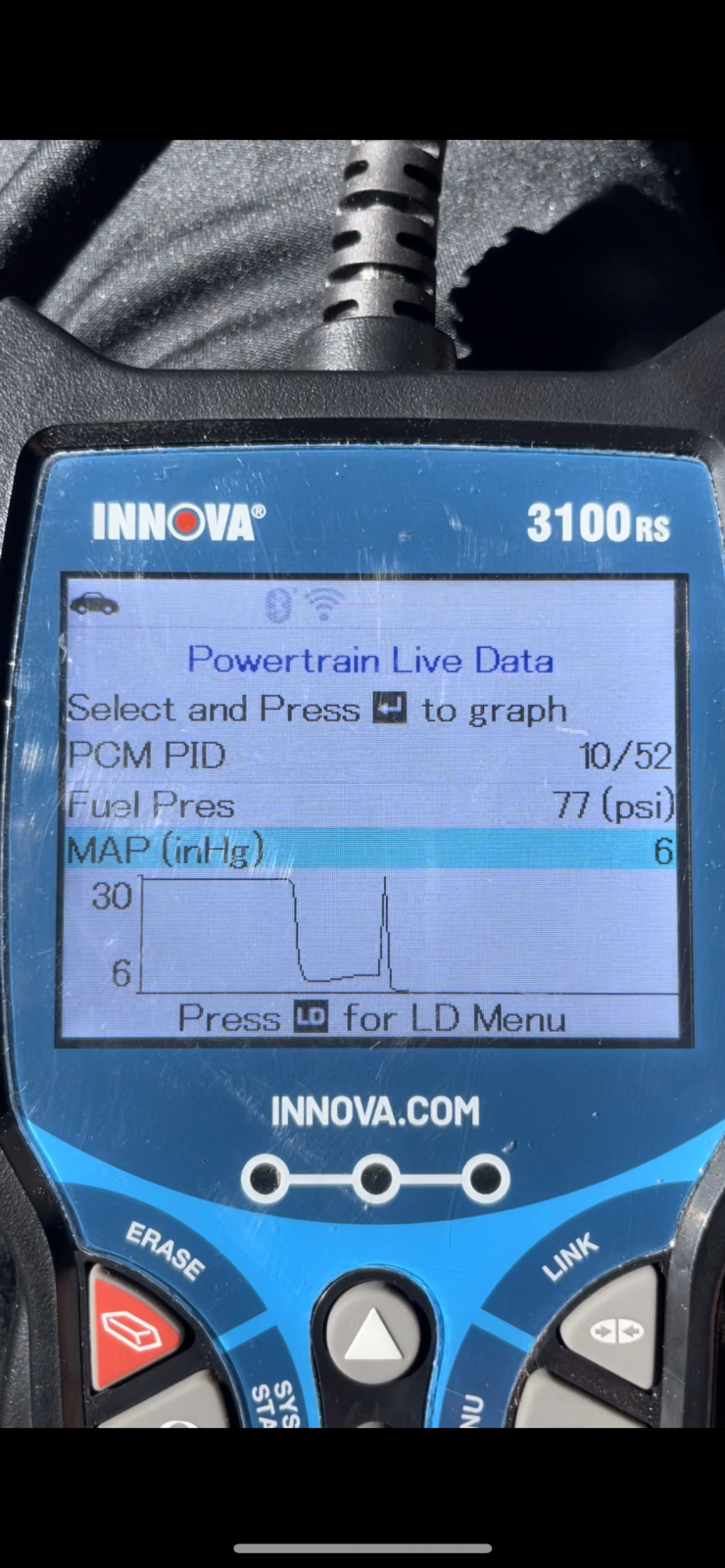

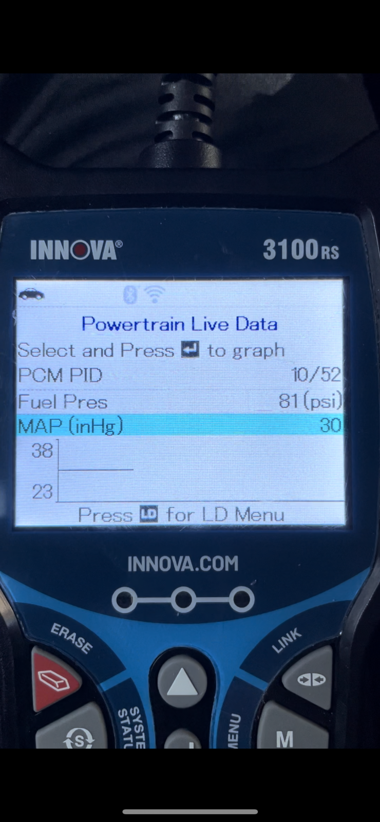

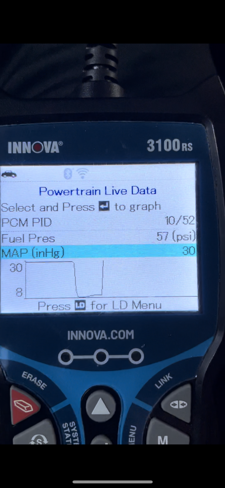

So I got some MAP readings and it seems they’re ok. It reads @30 and sits consistently at 10. The spikes are hard accelerations.
GranPrix
GranPrix
Sep 10, 2017
740
508

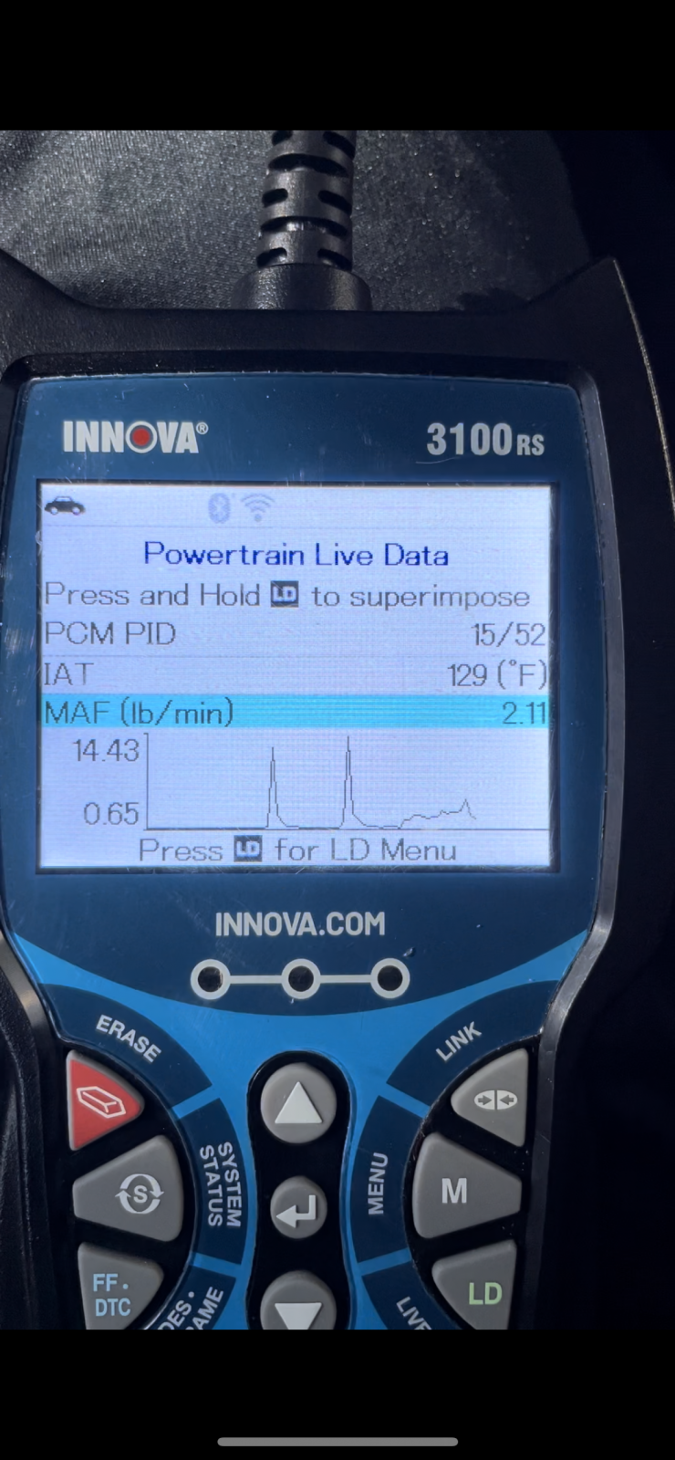

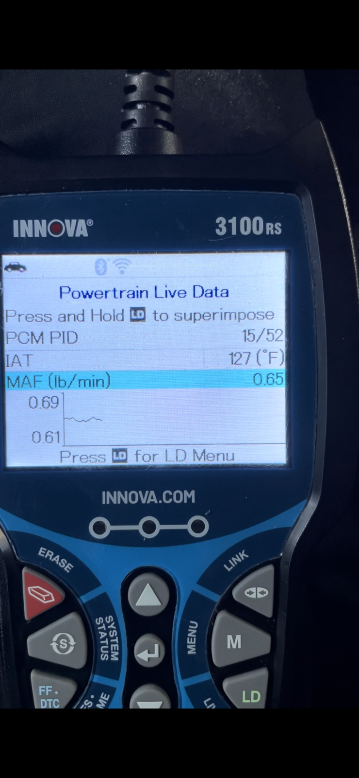

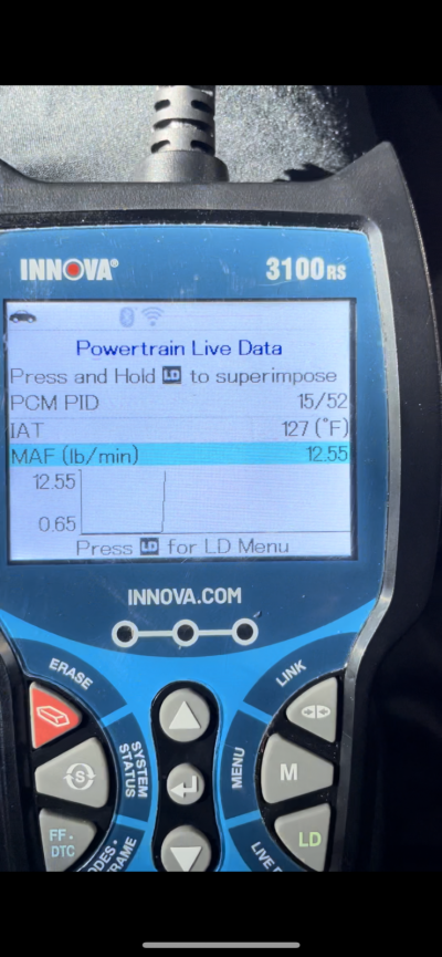

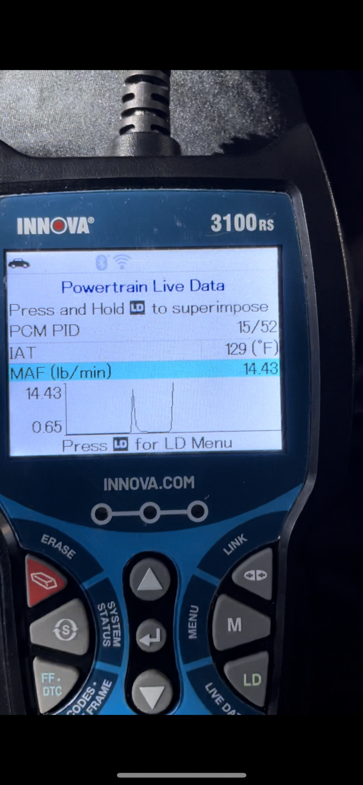

I’m not sure where the MAF numbers should be at
